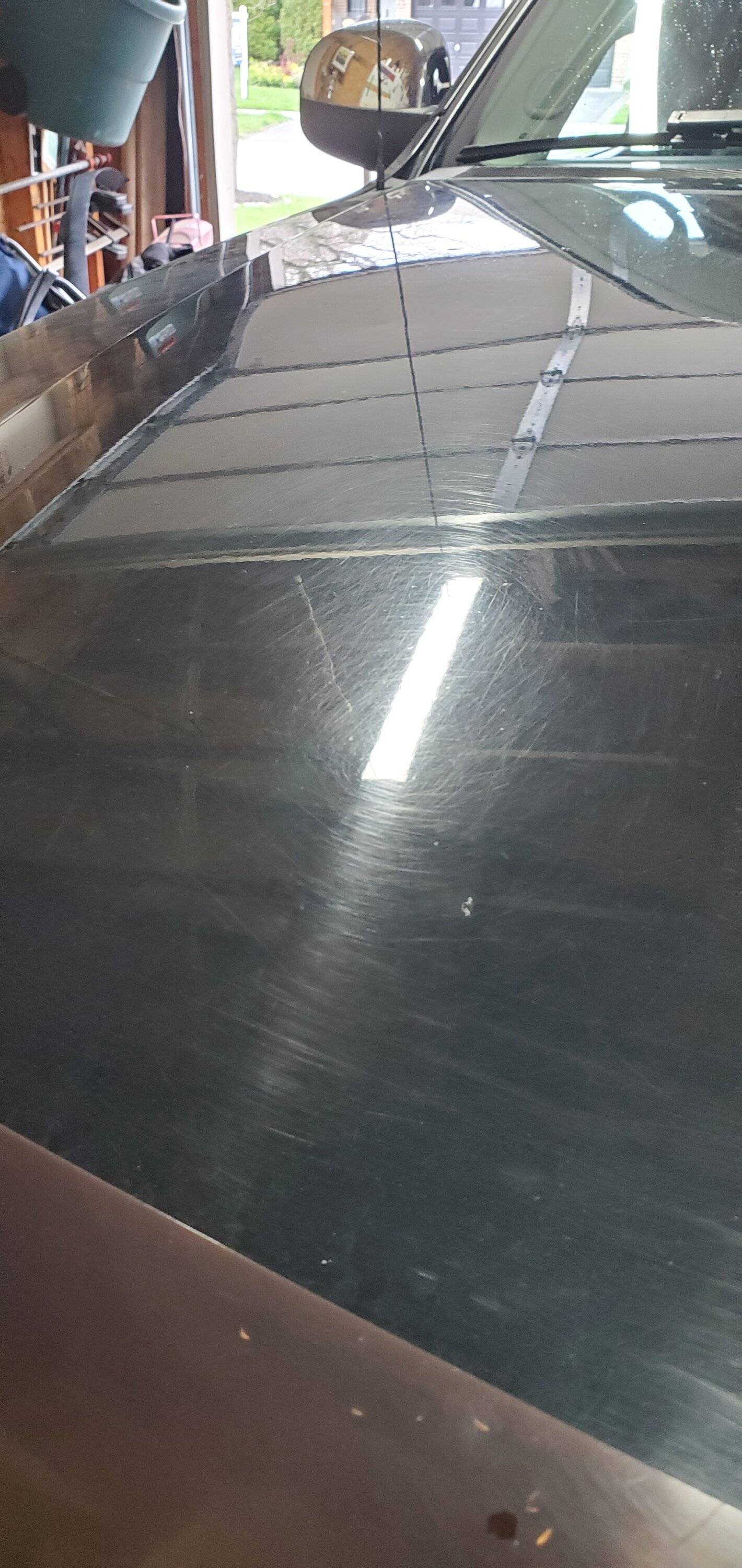

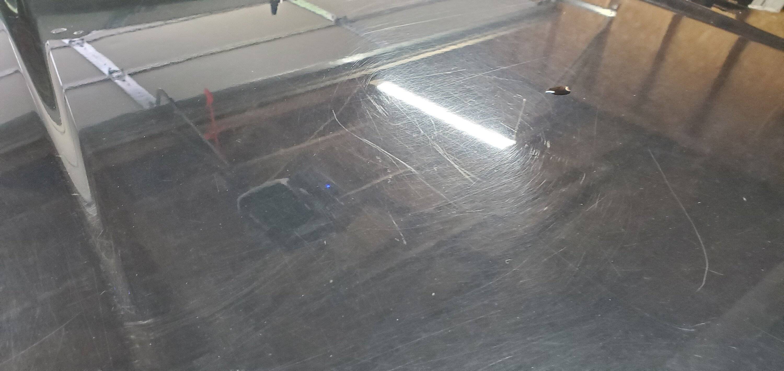

Thanks for the input. I just did a good wash and quick spritz of graphene to hold me back while i do me sum lernin'.
I don't plan to make this into any kind of show truck. I want to do it once, and make it look the best I can. Good grief there is a ton of scratches, I think the original owner might have used a garden rake to remove snow in the winter, as well as rain in the summer :explode:
There was some aftermarket trim I removed and saw some bubbles of rust starting around the corners of the wheelwells that scare me a bit, and a few spots under the lip of the hood where the paint looks kinda flaky.
Would I attempt any touchups before using any compound?
And already the lazy part of my brain is telling me I don't need to do the lower edges of the panels, focus on the hood and stuff in the line of sight, and the OCD part of my brain is saying that won't cut the mustard. What would a reasonable person do?

Belt line up is a good thing to keep in mind when correcting defects.
touch ups meaning paint touch ups? keep in mind what ever paint you apply is going to be new paint and won't match the existing paint.
When you touch the scratches do they catch your finger nail? if so those are deep and will require more work - if they aren't down through the clear they can be saved, but it can get "dangerous" because if you burn through the clear coat it can be a full respray on that panel...
If you have compound, take a clean micro fiber rag, apply a dab to a corner and start working a small area - think of polishing boots - work an area that you are comfortable working over and over for a few minutes - half a playing card is what I stay within. You want to have clear boundaries so you can tell if you are making a difference (You could use painters tape to delineate an area) We are only trying to see if polishing by hand makes any difference - most likely it will be a small difference as you're not going to be using an aggressive polish method. taking before and after pictures using flash or a flashlight to highlight the scratches can help you compare how much changed.
If we are lucky, hand polishing will result in a drastic change and you can focus on the major scratches and not mess with machines.
If it has rust already and you have the ability taking it to a body shop wouldn't be a bad idea - or if it doesn't matter, hit it with some of the rust eatting primer stuff...I used it on my '87 f150. it didn't fix it, but it hid it and slowed the rust...
Of course if you don't care what it really looks like, take a flap disc, grind away at the rust and hit it with some grey/black primer and be done with it . . . or grind it away and put the fender flares back on . . . lol

Definitely worth doing some paint correction, even if a body shop will be repainting certain spots. They won't touch everything and ultimately the truck will be better for it.
Hit up harbor freight and pick up the Bauer 6" dual action polisher. Hand polishing is for cavemen and people that can afford to spend six hours rubbing 2 sq.in. of paint. Go cheap on the machine, but spend a little on pads and chemicals. Hex Logic or Lake Country CCS pads are totally worth the money. Get at least one of each level from aggressive to least aggressive. I tried the cheap pads from harbor freight and actually had one explode on me. I'm still finding pieces of orange foam almost a year later! The nice pads have cooling channels and I have confirmed they do not explode.
For compound/polish I recommend getting the meguiars stuff starting with the M105 & M205 compound then use the megs ultimate compound and finish with megs ultimate polish. It's not necessarily the best, but it's universally available at whichever store is nearby. That should be enough for a nice mirror finish, even though it will leave behind the deeper scratches. Wipe with alcohol then apply 303 Graphene and you're golden.
