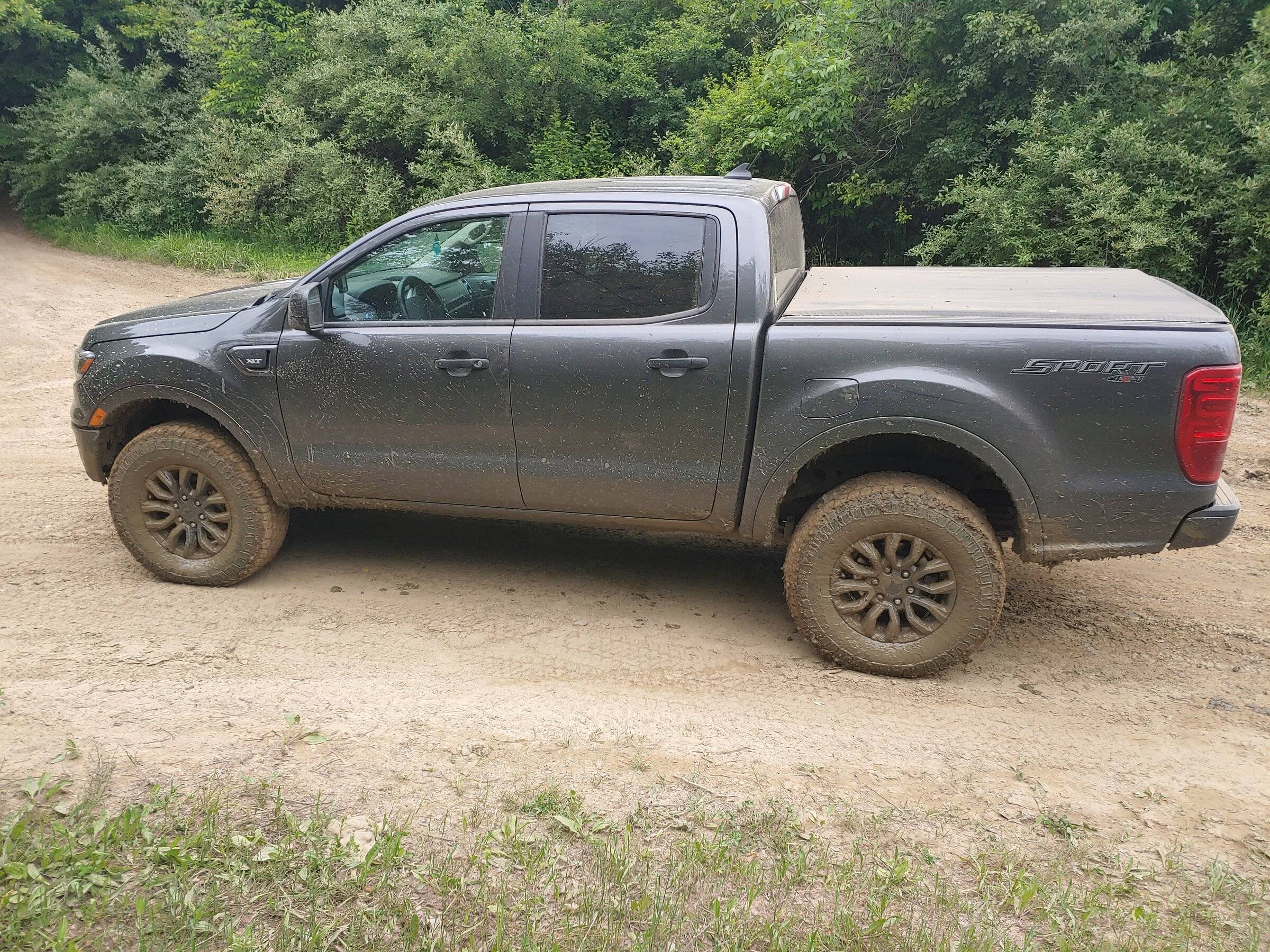

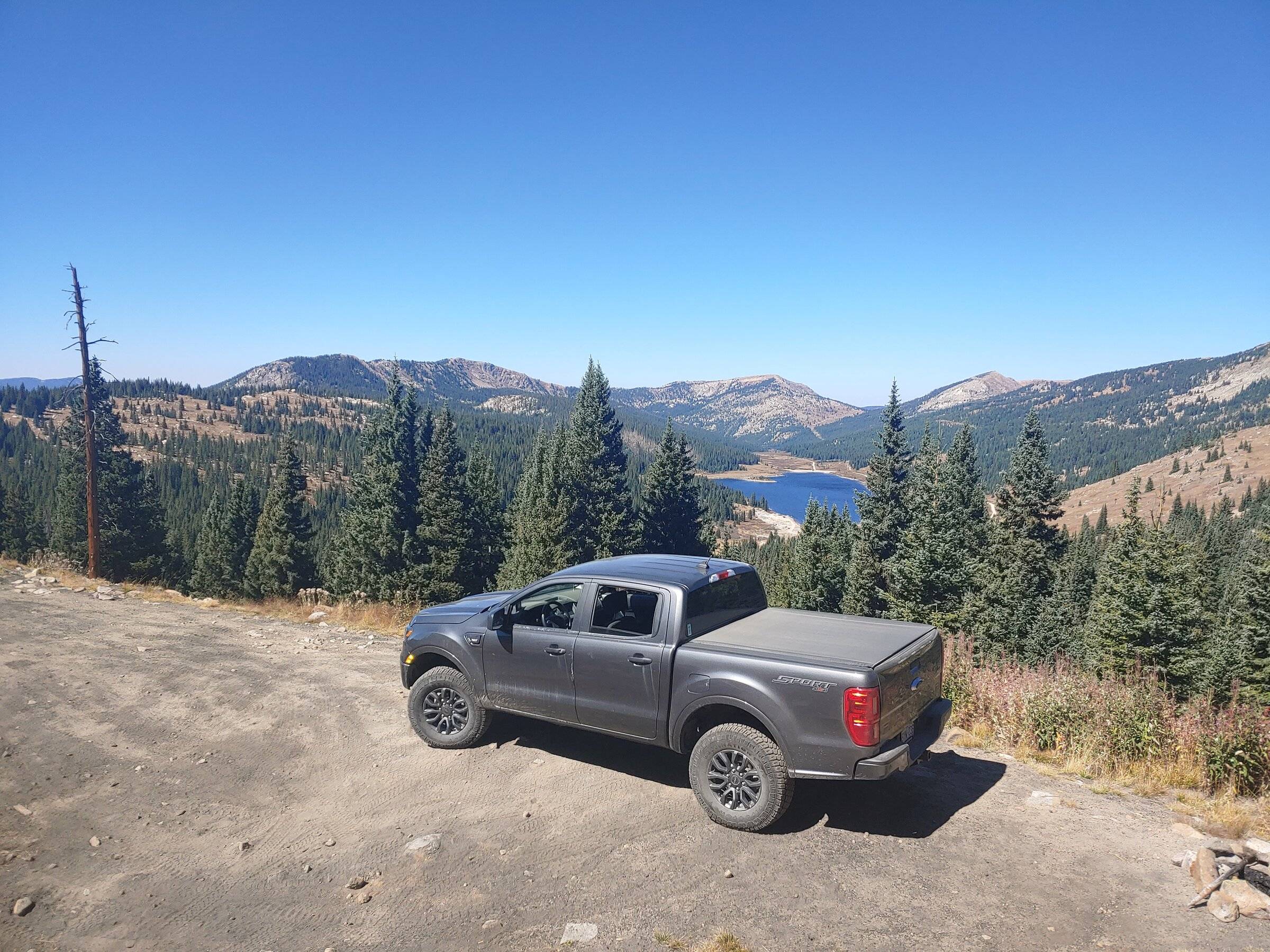

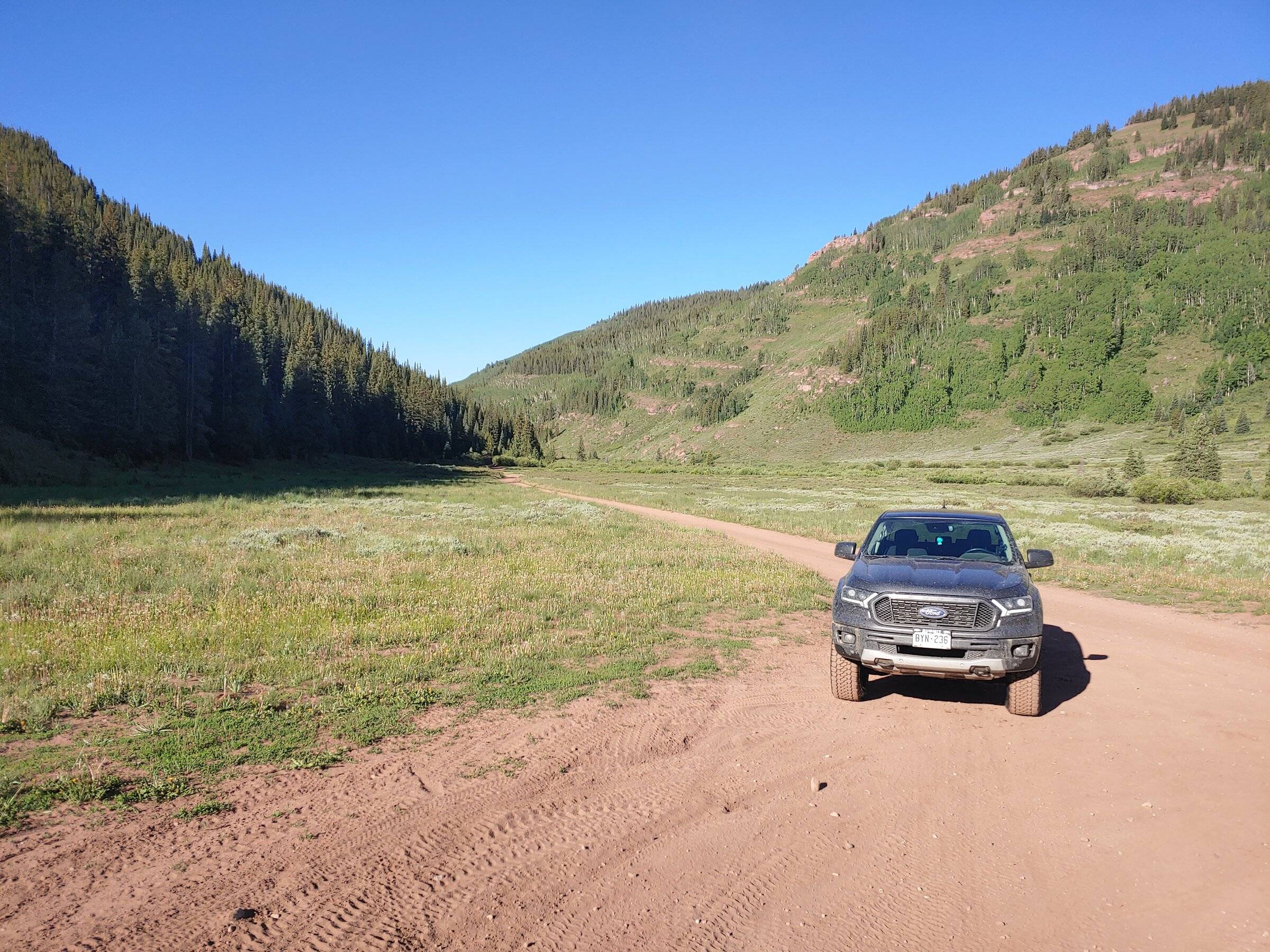

So spacer kits are ok if you plan to stay on the street. Why? Well even though they can lift(or level) your truck they will put extra stress on certain suspension components(front struts mainly). Leveling kits are ok if you dont understand truck suspension and why a truck has a rake from the factory.
Lift kits on the otherhand tend to be the better way to go for OffRoad to an extent. It depends on the lift kit to begin with. For most vehicles out there(Ranger included) the most practical lift for a vehicle will be between 2-3 inches not counting the lift from the tires. Why so little you ask? Well any more then that can cause possible binding issues depending on the kit and some kits(lile the ones you are looking at) makr you drop the front diff. The problem with droping the front diff comes down to the fact that you were lifting the truck to get clearance but yet one piece of the puzzle was not brought up all the way with the rest of the truck. It can also cause some issues if you want to install skid plates(other members have ran into this).
With all that said there is a lift kit I do recommend(no you dont necessarily have to pick it either) is the Old Man EMU. Even just the basic kit with make enough of a difference for what you are looking for. What I like about it is it replaces not just the struts and shocks but also all the springs(including the leaf springs). With that being done you do gain travel up front and the rear. You also gain just enough flexability vs stock and leveled trucks where you can go over different obsticles that may bot look that bad that others may struggle with. I have been runing the basic kit for a little over a year and a half now. No major problems with. Nice comfortable ride both on and OffRoad. Still able to tow as needed. And compliments the truck well. How much does it lift? 2.4 inches front and 1.6 inches rear. Cost? Roughly $1,400 USD(not sure on the Canadian dollar).

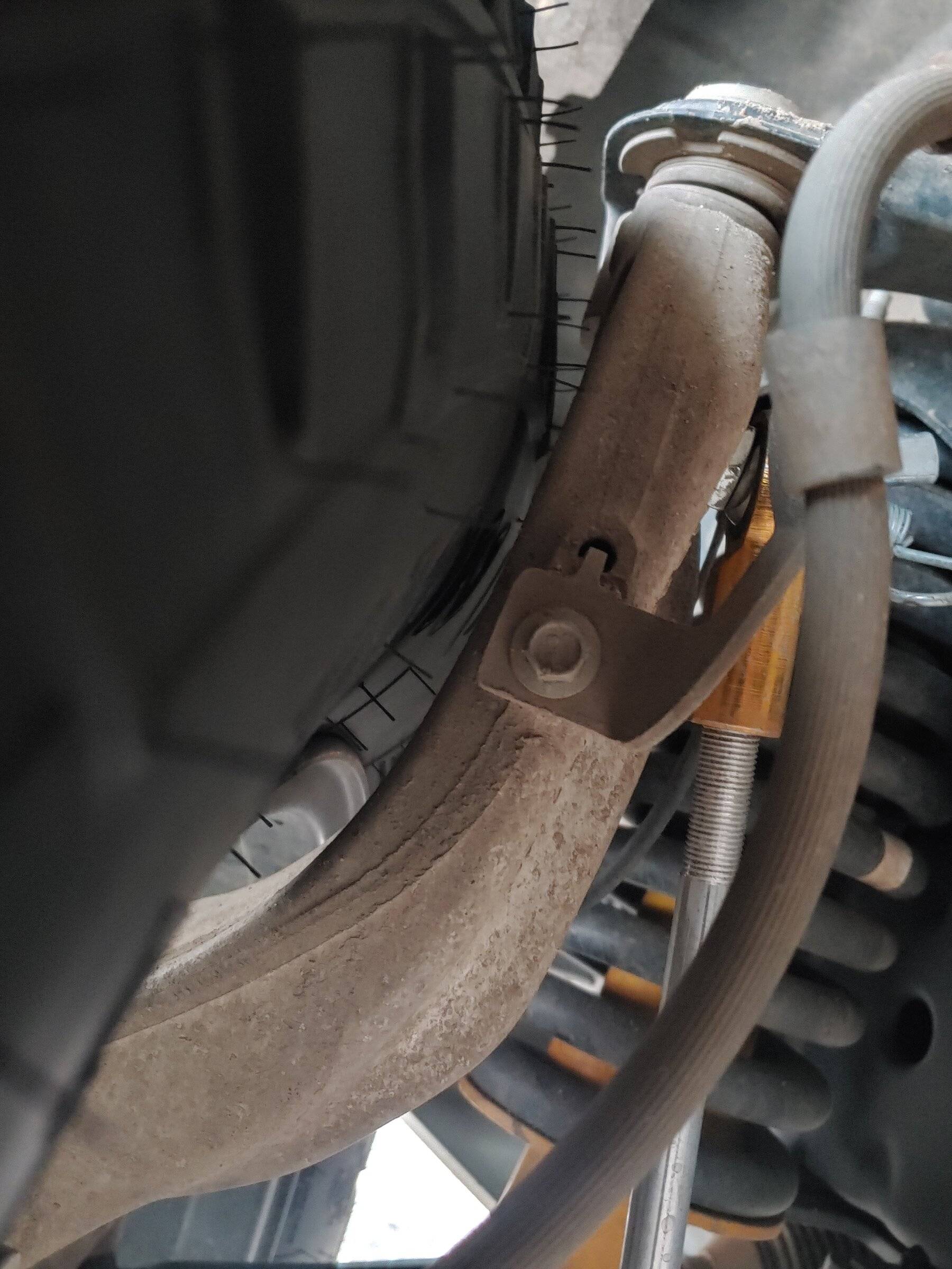

I will also add that I do have Firestone Destination XT'S in 285/70-17 on stock wheels with no spacers and only rub the frame at full lock.
Here is the link so you can see the kit I'm talking about
https://www.stage3motorsports.com/o...d-man-emu-2-suspension-kit-standard-load.html
Again thats just my input. You do what you feel is right for you and your truck.
