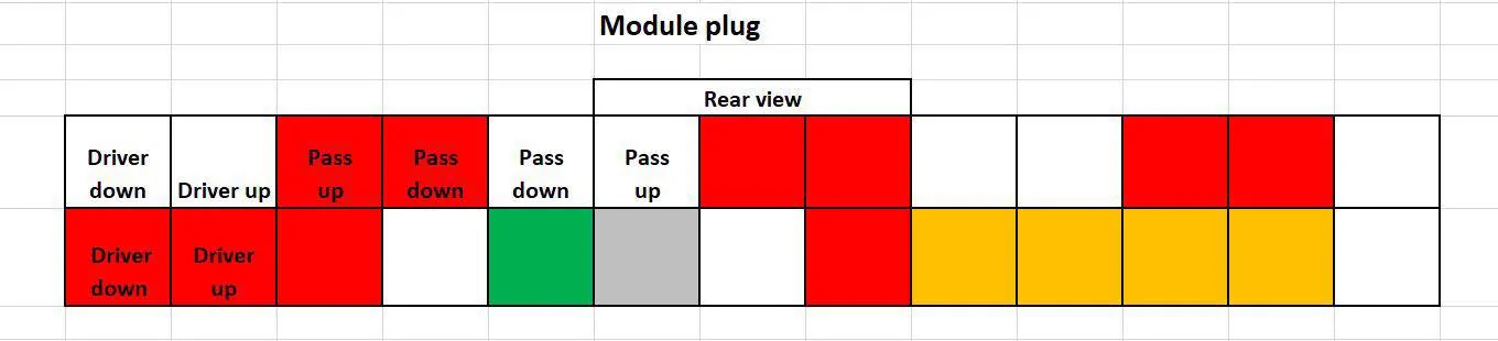

Got the Module took less then 5 minutes to install all buttons work except the passenger side front door works on driver just not passenger button
I did try the one touch reset as if I unhooked battery did not work

No. I guess I never tested the front passenger switch myself. It's doing the same. I figured it out. It's because the right hand drive already has auto up and down on the front right. Some wires will have to be switched around. If you can switch them yourselves do so. If you can't I will request replacement harnesses with the corrections done. I just swapped mine over and it works fine now.

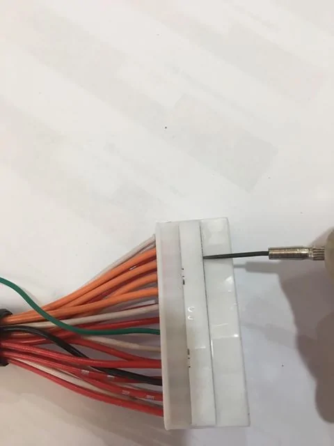

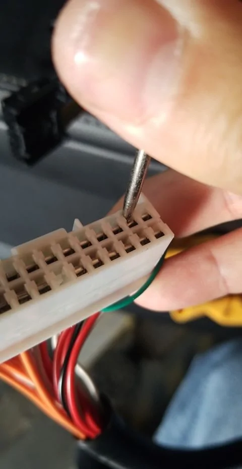

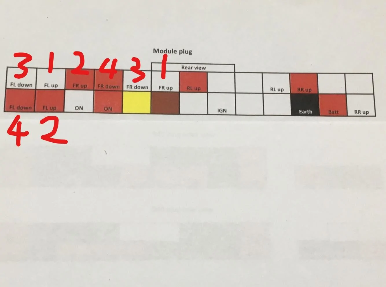

IMPORTANT UPDATE. Directions to swap wires due to right hand drive to left hand drive configuration. I have swapped the wires and everything functions as it should.
#1 Swap white FL up and white FR up.
#2 Swap red FL up and red FR up.
#3 Swap white FL down and white FR down.
#4 Swap red FL down and red FR down.
To release pins lift this tab up.
The release tab in the connector. Wire should pull out.
Thanks for the detailed instructions on the flip! I'll make sure to do that before installing, when mine comes in tomorrow.
Sorry I've tried everything I can think of and can't get the wires to release
I've pulled back the side tab and my pins won't come free.
