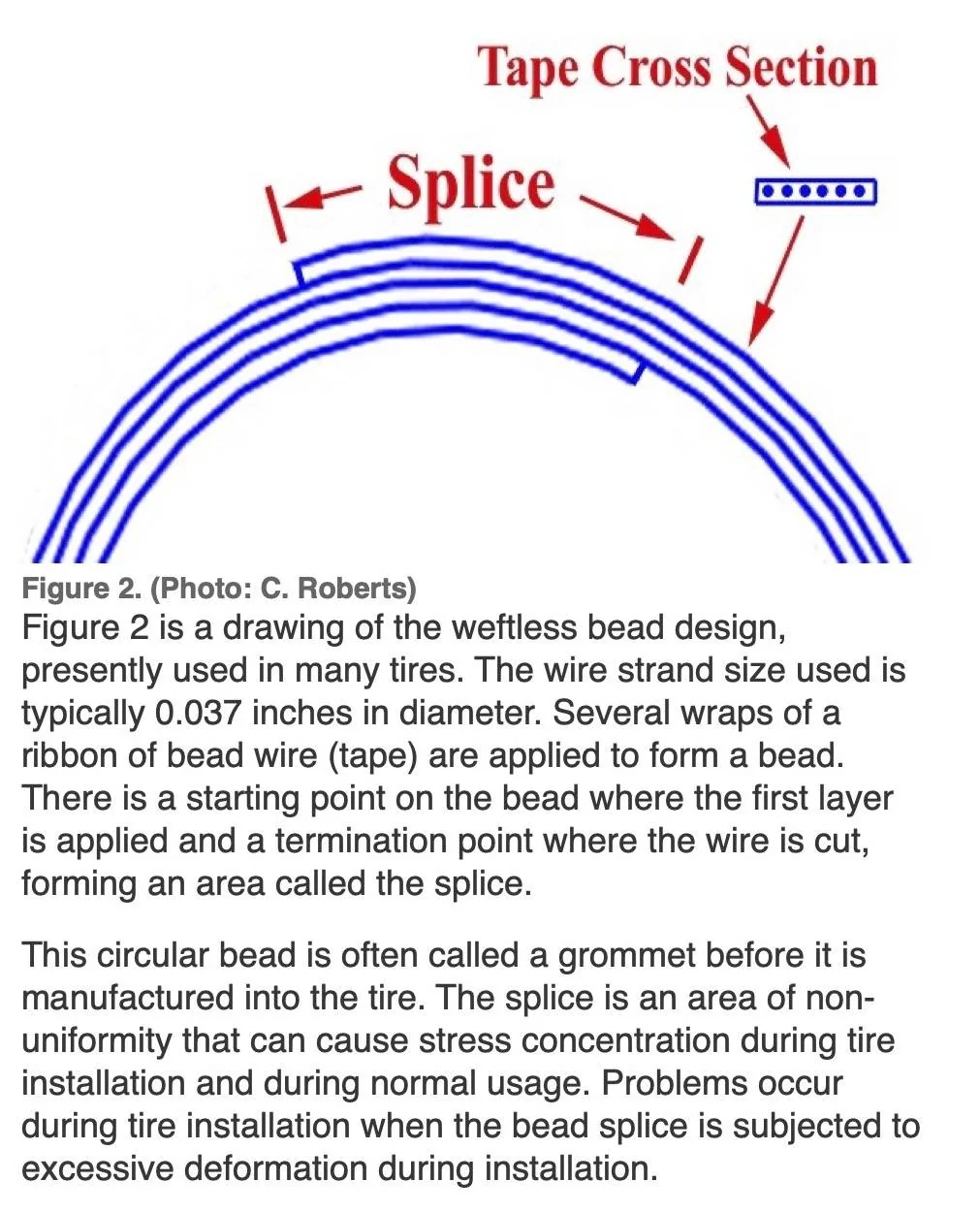

More than you wanted to know about tire beads:
Taken from this article.

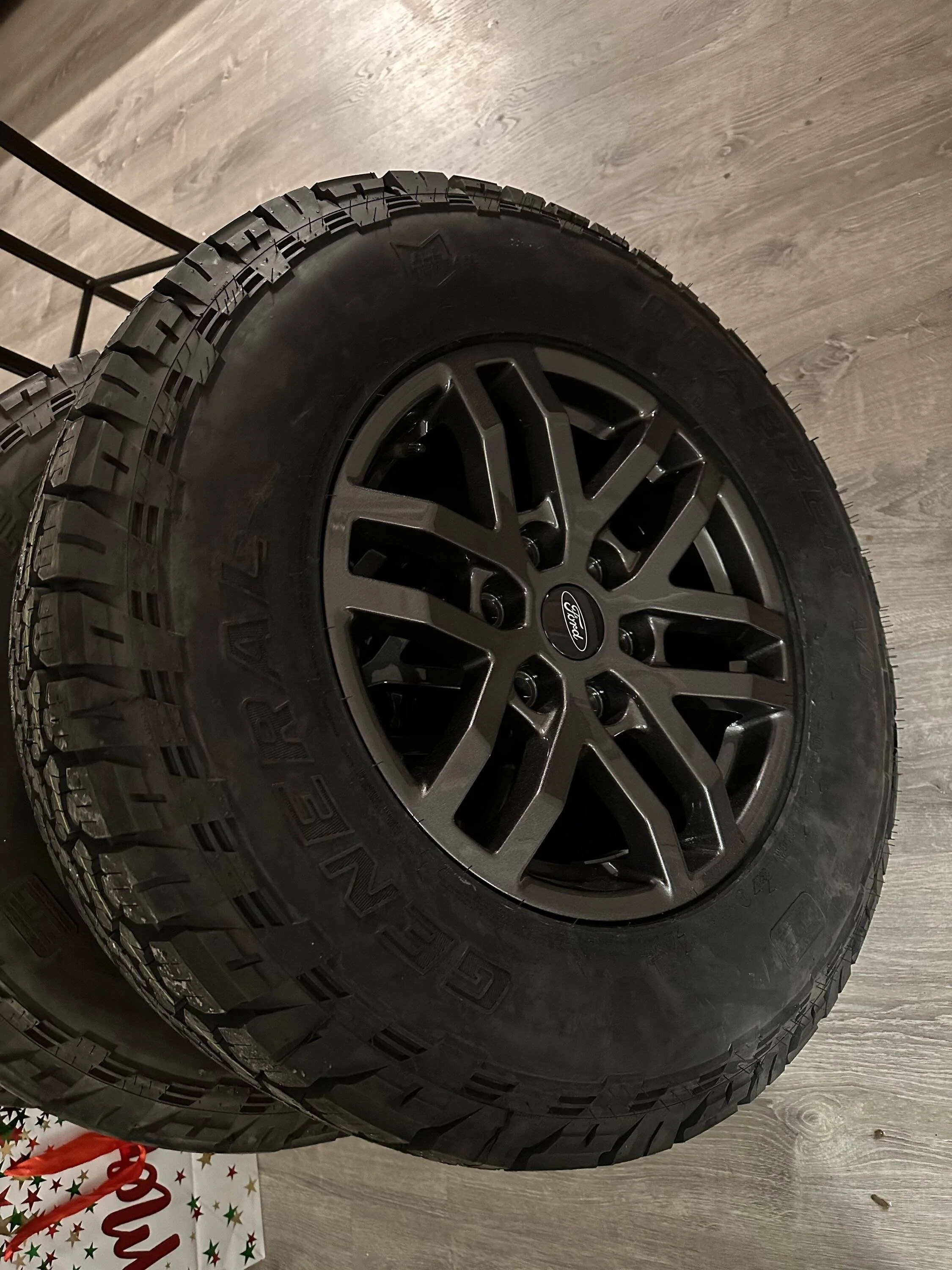

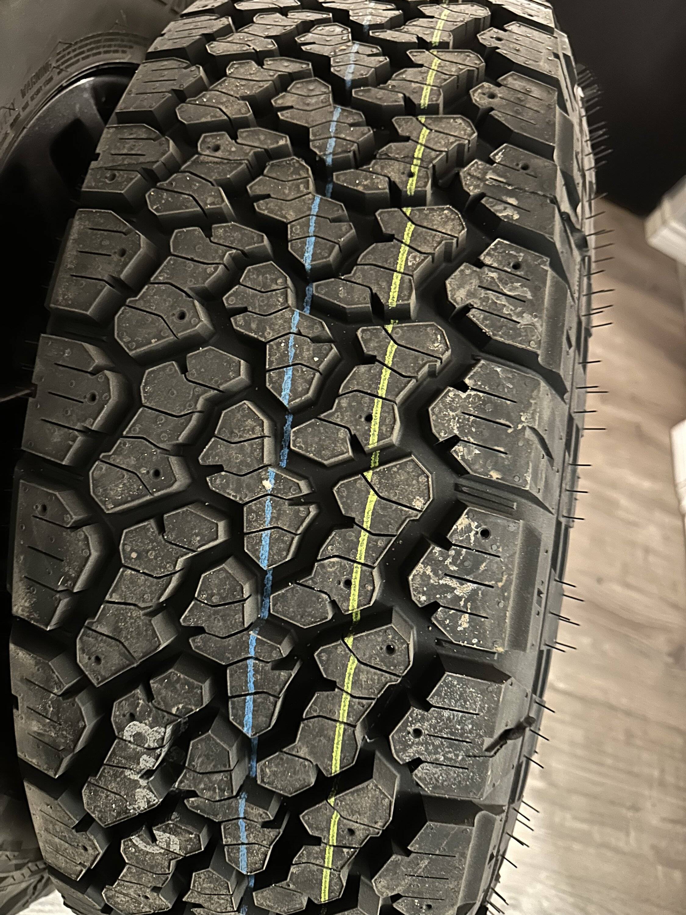

Finally picked up the wheels from the shop. They look really good. From what I can see, the repainted all 4 wheels completely.
Sure enough, one brand new tire. The tread measures about 17/32nds. I have two tires measuring close to 15/32nds. And the oddball in the group is 12/32nds. I am going to call them when the manager is back on Monday and ask for the tire to be replaced.
