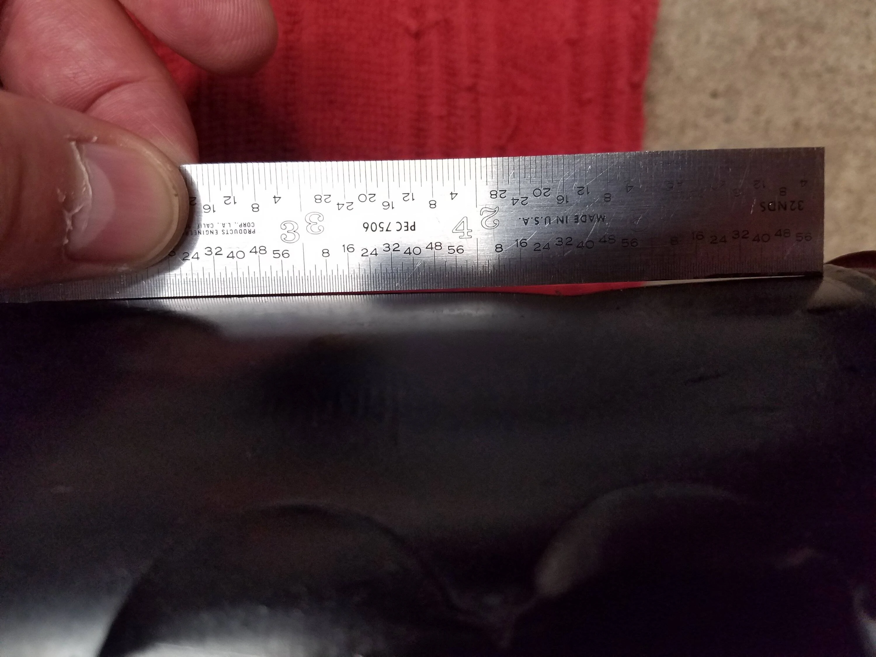

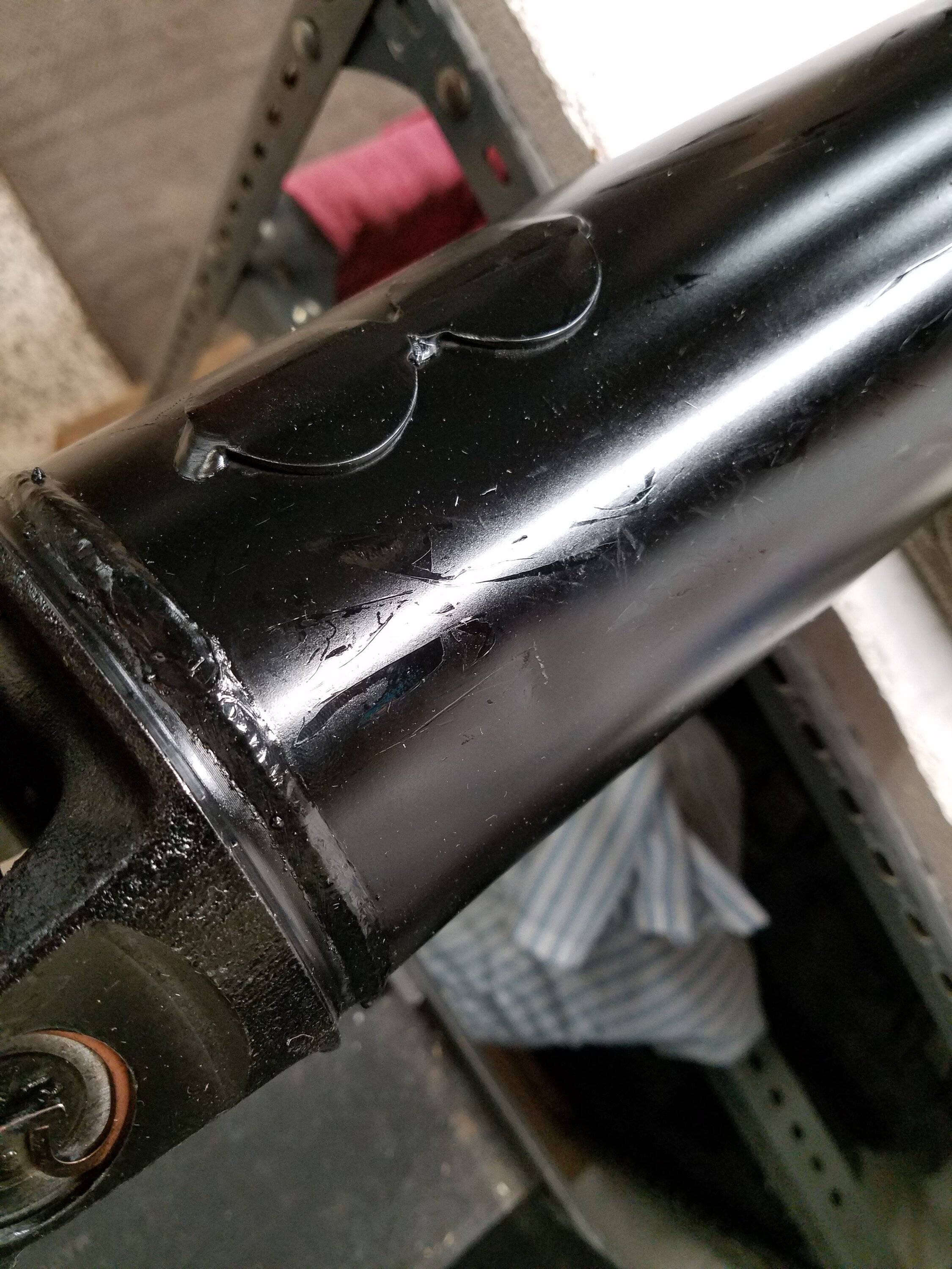

Gotta love UPS. Not sure if this is a problem. One end of the box was open when I got home and looks like a dent on the shaft. Any opinions if this is an issue.
I left Shawn a message at his shop and here on the forum. Hopefully this is a non-issue.
Heck yes that is a problem and needs to be reported to UPS immediately. Hopefully shawn can get you a new shaft quickly.
UPS claim is filed. Amazingly this is the first time I've had to do this. Hopefully it is quick and painless.
Shawn Woods responded to me and is going to take back the damaged shaft and build a new one for me. There is still excellent customer service in this world. Outside of the UPS inflicted damage, the driveshaft is a quality piece of work. Thank you, Shawn!

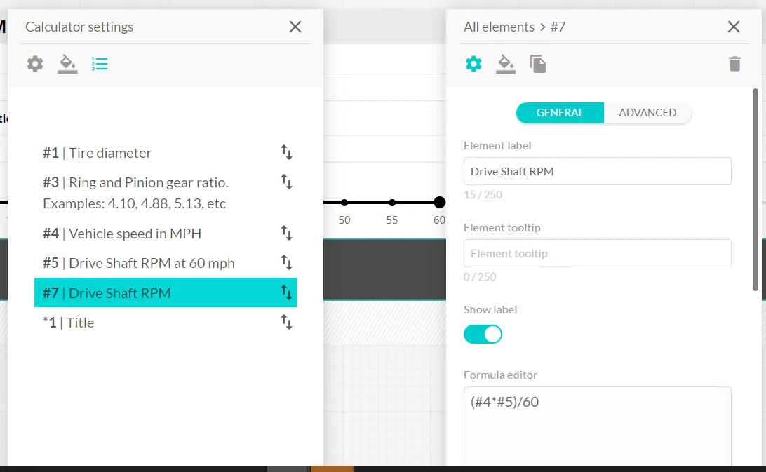

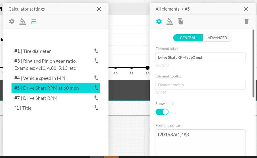

Here's a couple screenshots of the backend of the calculator, for those of you who understand math better than I can explain it. :) The formula for each mathy step is in the bottom right corner where it says "formula editor"
