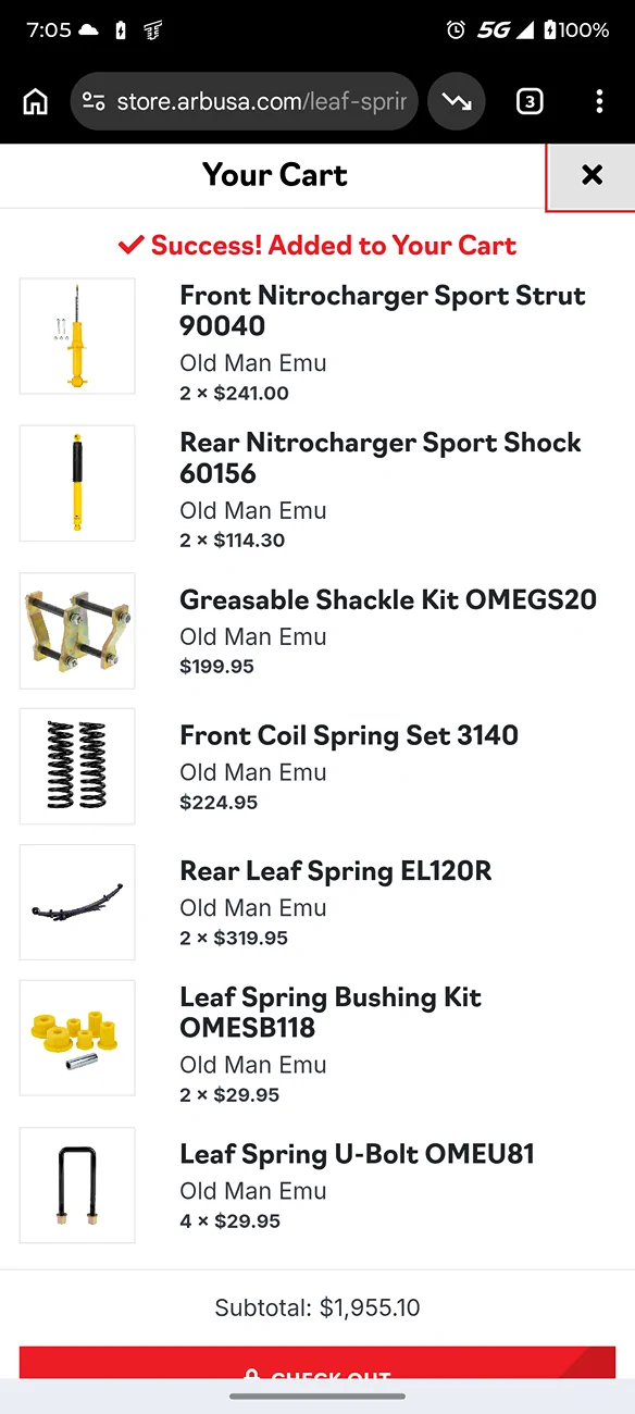

Hey all, I wanted to ask out there if anyone is running an OME 2.5 inch lift, either the light or heavy load with the leaf springs and front coilovers on their ranger? I saw a thread about one on a Nissan Frontier but didn't see anything specifically about someone having one on the ranger. I'm looking for something that wont require me to spend hundreds or thousands on coilovers, UCAs, shocks, etc. and want to see if anyone can provide any info on this lift kit. If you do have it, what tires and size are you running? Any issues? Thanks in advance

I am the guy with the Frontier and I also had Old Man EMU Suspension on my 2019 Ranger that I had. I have questions before giving you information on what to choose.
First and foremost what are your goals? BTW if you say to go OffRoad..... Stop there and take the truck OffRoad.......
The next question is how much stuff do you have in the bed normally? Is it empty? Is it loaded with a bunch of stuff? If it's loaded, how much weight do you have?
Last question is how much are you willing to spend? Is money not an object or do you have a SO that is watching this thread?!

My goals are to have a lifted look but not sacrificing ride quality or potentially jeopardizing other suspension or steering components like I might if I went with something like a rough country kit. I do also want to off road, I’ve taken it off road plenty of times stock but would like to put bigger tires on it and be able to take things at a bit higher speed and have a bit more fun.
the bed is usually empty. I fit into the weekend warrior category, rocks/sand/wood/helping friends move/light trailers maybe once or twice a week but it’s not seeing constant load. I would like to put a tent on the roof and some new bumpers but I don’t think that would make a huge difference.
I’d like to spend a maximum of $2000 on a lift, so if I went with coilovers I’d hope to keep the struts, shocks, shackle/block, UCAs, etc. to that limit. Tires and wheels are my next worry but I want to get down what I want for a lift first. And yes.. she’s watching

Well thankfully you knew how to respond and I appreciate it. Instead of mixing and matching suspension, I'm going to recommend you stay with Old Man EMU on this one. Allow me to explain on this one.
Now because of budget alone I'm going to say to stick with the Nitrocharger Sport Suspension as the price even with springs will keep you below the $2000 mark, but only barely.
As for what parts to get, I recommend what is on the list above. It is the standard kit from Old Man EMU for the Ranger. It will provide roughly 2.4 inches of lift in the front and 1.6 inches of lift in the rear. This is at 0 lbs of load with accessories. If you choose to add weight, you can easily replace the springs up front and add a leaf to the rear leaf springs if you wish.
Cool thing about the selected parts, 780 lbs will level the truck out with that configuration. I know because I did it a few times with batteries. Just keep in mind that Steel Bumpers(Bull Bars included) will make a difference on weight. Get too much weight and you will be changing springs.
For this kit it is recommended, but not required to get aftermarket upper control arms. When the kit is put together it will fit up front, bit it will be so tight that you fight it going in. If you get a good Aftermarket Upper Control Arm, then you should fix that issue and the Control Arm may assist in alignment correction as well. If you decide to go this route, I highly recommend going with SuperPro and Whiteline. They will increase the clearance and make both Camber and Caster Correction with Lift.
How much faster will you be on the trail with this kit? Well you won't necessarily be trying to do the BAJA 1000, but you will be a bit more comfortable on the trail over stock. Just be mindful when on the trail.
Why this over other stuff? Old Man EMU is designed around Overlanding/Remote 4WD Touring and will be focused on giving a good ride both on and off the trail. It may not be perfect, but it will do what it can. Also these parts are made in Australia vs others choosing to go to China for manufacturing. The next step up if money wasn't an object is the BP-51's, but again Money better not be an object. That said they are nice! I wish I was able to get them on my Ranger, but for reasons it did not happen. Now I have them on my Frontier and I am thrilled!
Hope this helps
