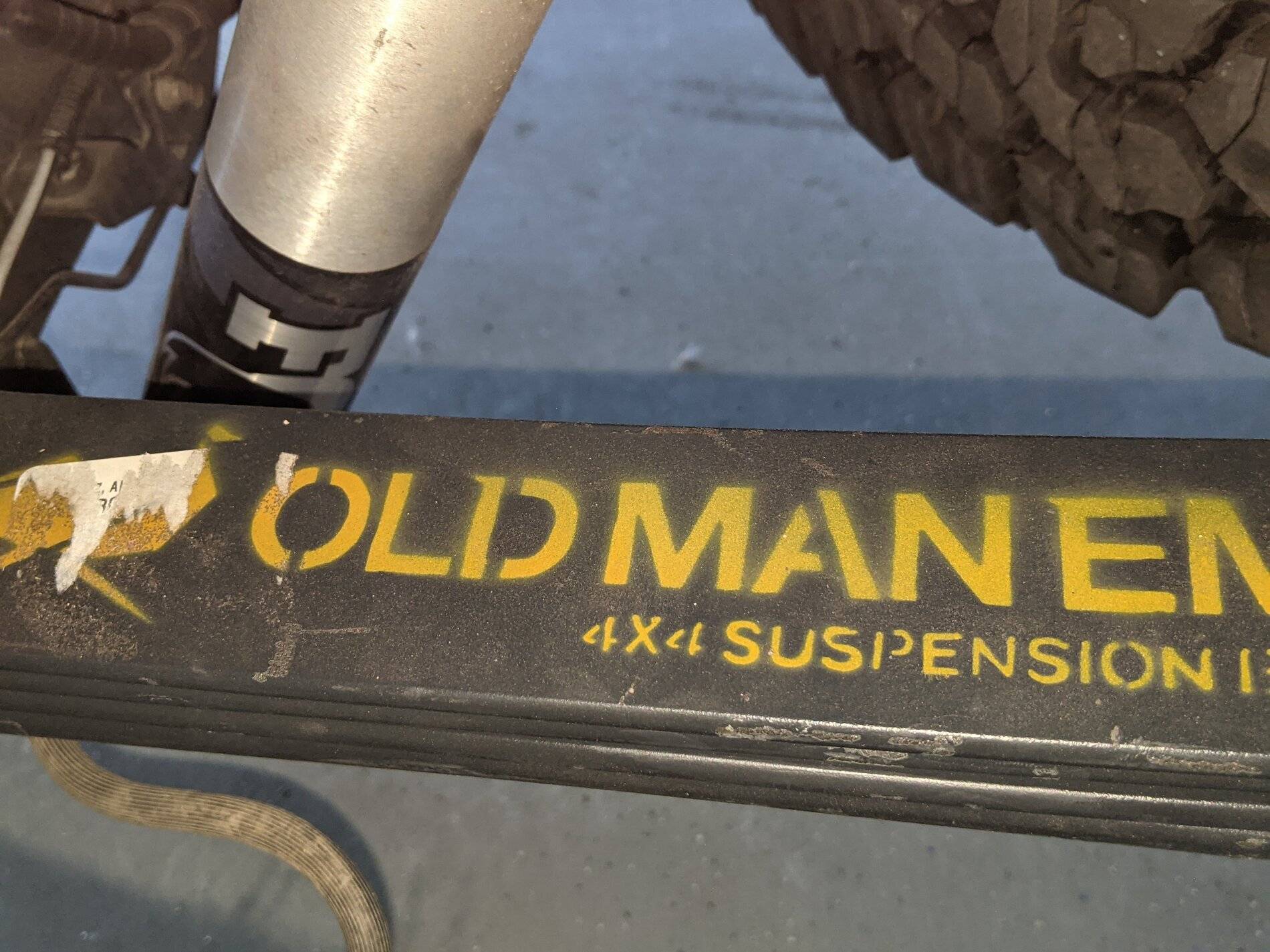

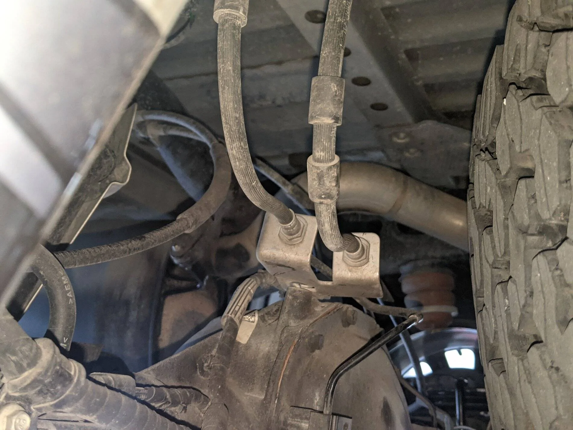

I just installed OME medium rear leafs. Much better than stock. The stocks would compress sooner and hit bump stop which would be hard. The OME have a 1.7 in lift built in which increases the space between the spring and bump stop. The springs are NOT harsh like add a leafs, they handle hits well. Also the articulation is better than stock. The hang at full extension is further than stock. I recommend bending the brake line bracket to adjust for the increase.

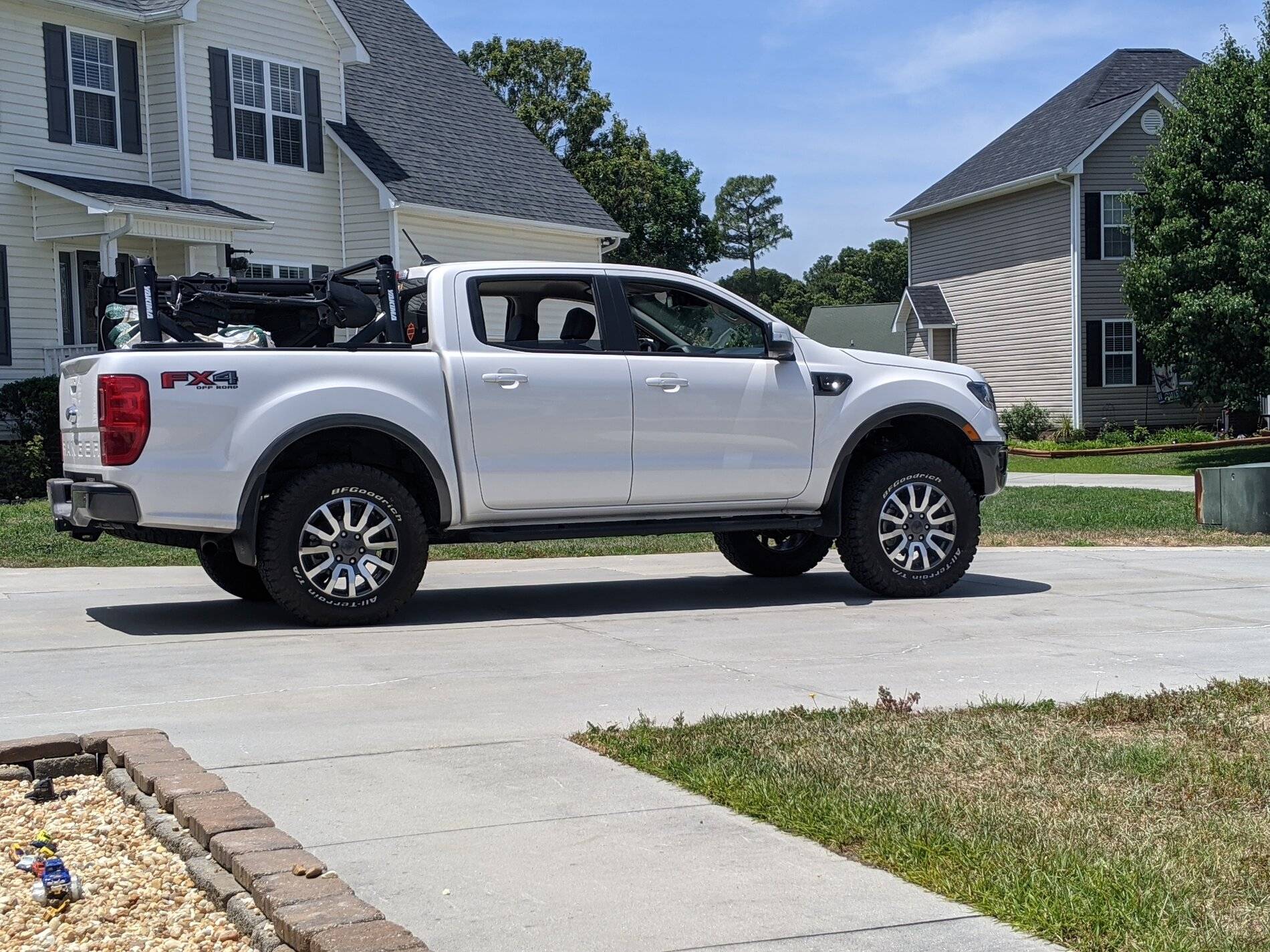

Here is my truck with 32 inch tires
