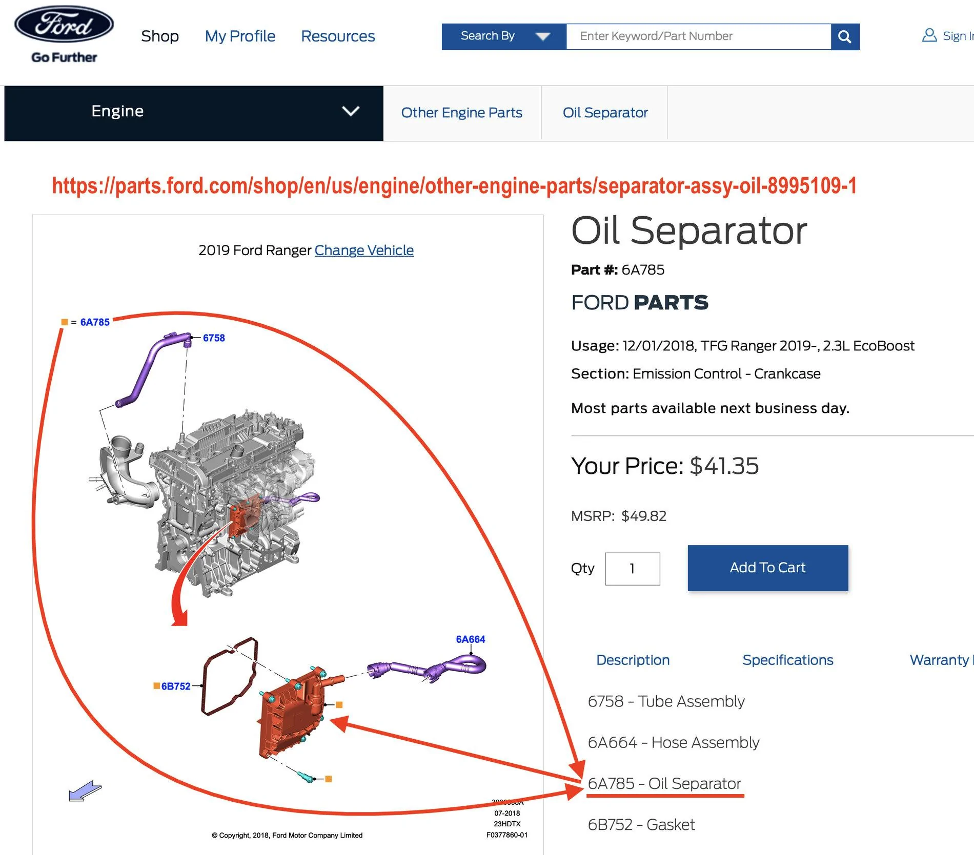

Since a catch can is really just an oil separator, and the 2.3L has a built in oil separator under the intake manifold. Do you still need a catch can. The one built into the 2.3L Ranger engine doesn't need emptying. It drains the separated oil back into the oil pan. See the attachment.
What do you think.

I agree with your analysis. I'm leaving it the way it is and changing my oil on a regular basis with a quality synthetic oil.

Opinions vary all over the map on this. I agree with @landiscarrier, at least while the truck is under warranty I won't be installing a catch can. Mobil 1 Annual Protection oil and Motorcraft oil filters purchased from the local Ford dealer, changed by me every 4,000 miles.

For your reading pleasure, follow this link to find a thread with 25 pages of people discussing this very topic.

Thanks for answering. That was my thinking too, with the same game plan. Just looking for other owners opinions.

Note that I pulled the vent hose that is attached to the air intake behind the air filter and ran a cotton swab around the inside, no trace of oil at all.

That one typically doesn't get that bad. The one under the intake manifold is where all the magic happens.

Even with the factory separator installed, there is still a small amount of oil that makes it past to the intake. Is it enough to cause the excessive carbon build-up? Hard to say at this point, only time will tell.
Now the factory separator is just a series of baffles that repeatedly change the direction of flow slowing it down and causes the oil vapor to collect and drain back into the crank case. Depending on the port sizes for the drain on the side of the block it may be possible to modify the separator by adding a bit of large coil stainless steel wool like the type used in food service. No corrosion or rust issues and it would significantly increase the contact points for oil vapor in the PCV air stream passing through the separator, and improve its performance.
