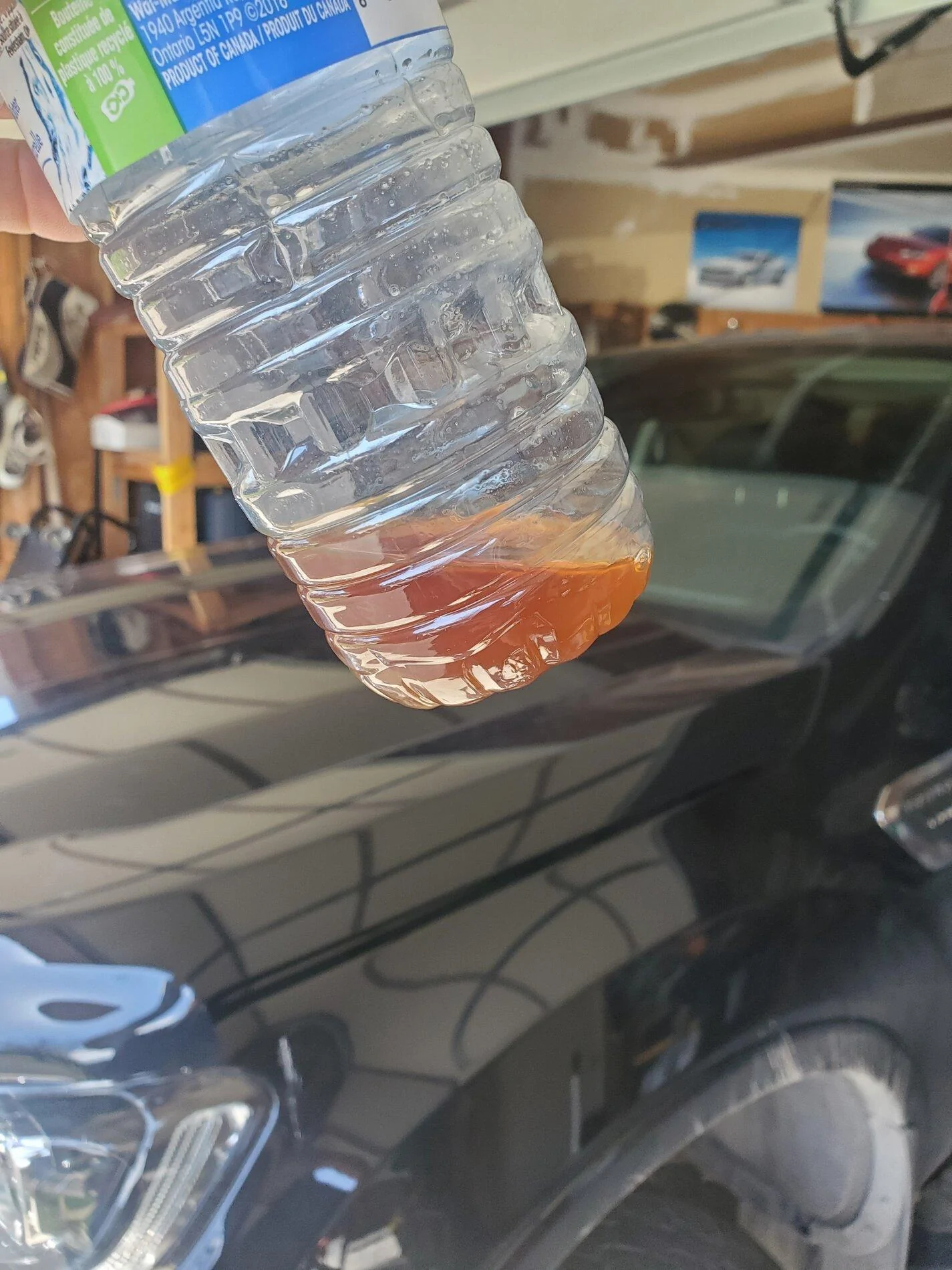

After 600 km (400 miles) this was in the can. Standard water bottle. I'm glad I went through the pain and suffering, I think this will be a benefit over the long term for sure.

What is that exactly? Mostly fuel?
There is a lot of fuel I think, but some oil too. I'll let it settle overnight and check it tomorrow
