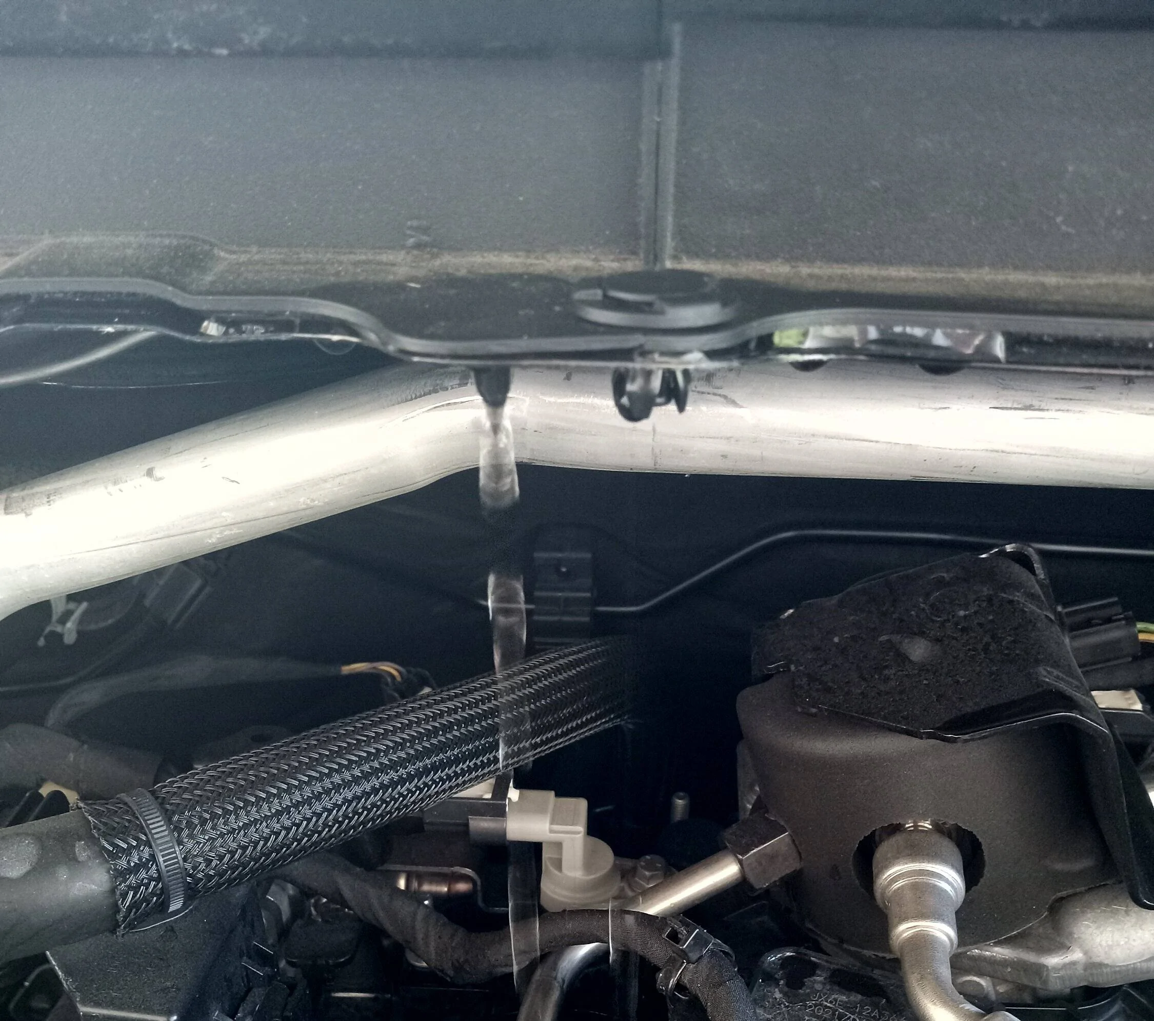

It’s not a big deal so don’t overthink it - if it’s dirty, it’s likely just dust and will get dusty again, even with the cover. You might want to reverse your vacuum cleaner hose and blow the dust off before installation if it’s really bad.
btw - the cover doesn’t really stop water from getting to the spark plug well. It was first thought that it would and Ford called for an engine cover in a TSB. We now have a better understanding of how the water gets in (drips through an unfortunately placed seam and retention pin in the wiper/windshield cowl).
This discovery might be why Ford cancelled that earlier TSB. Regardless, the cover looks good!
I see the drip! Mine has a lot of foam there and I park downhill passenger side angle down so the water hopefully mostly goes downhill also.
But all the foam under the cowl eventually gets very wet.
I may just start parking facing uphill or I have a small level spot on my driveway I may utilize.
