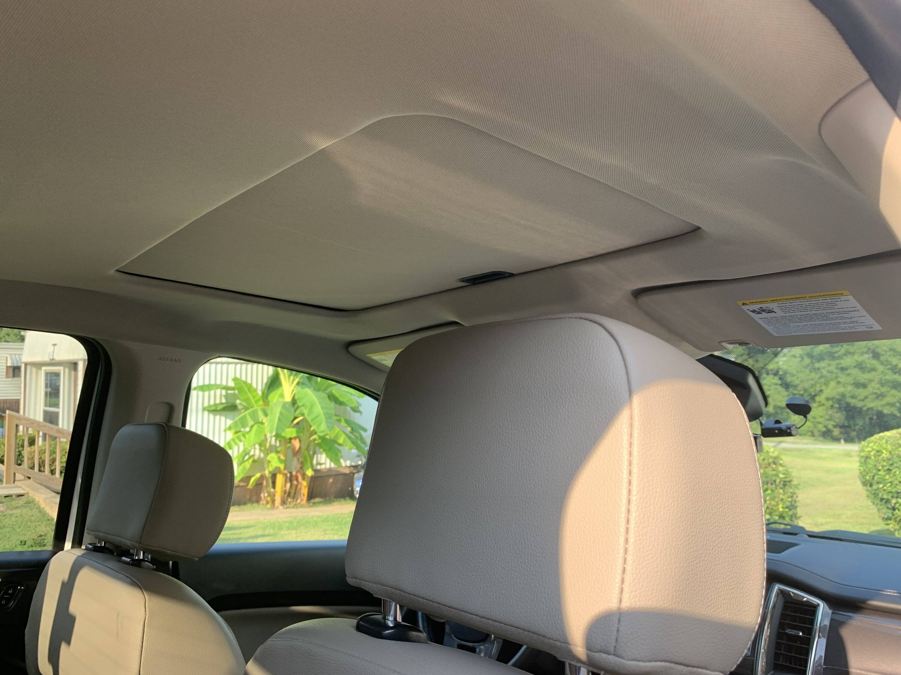

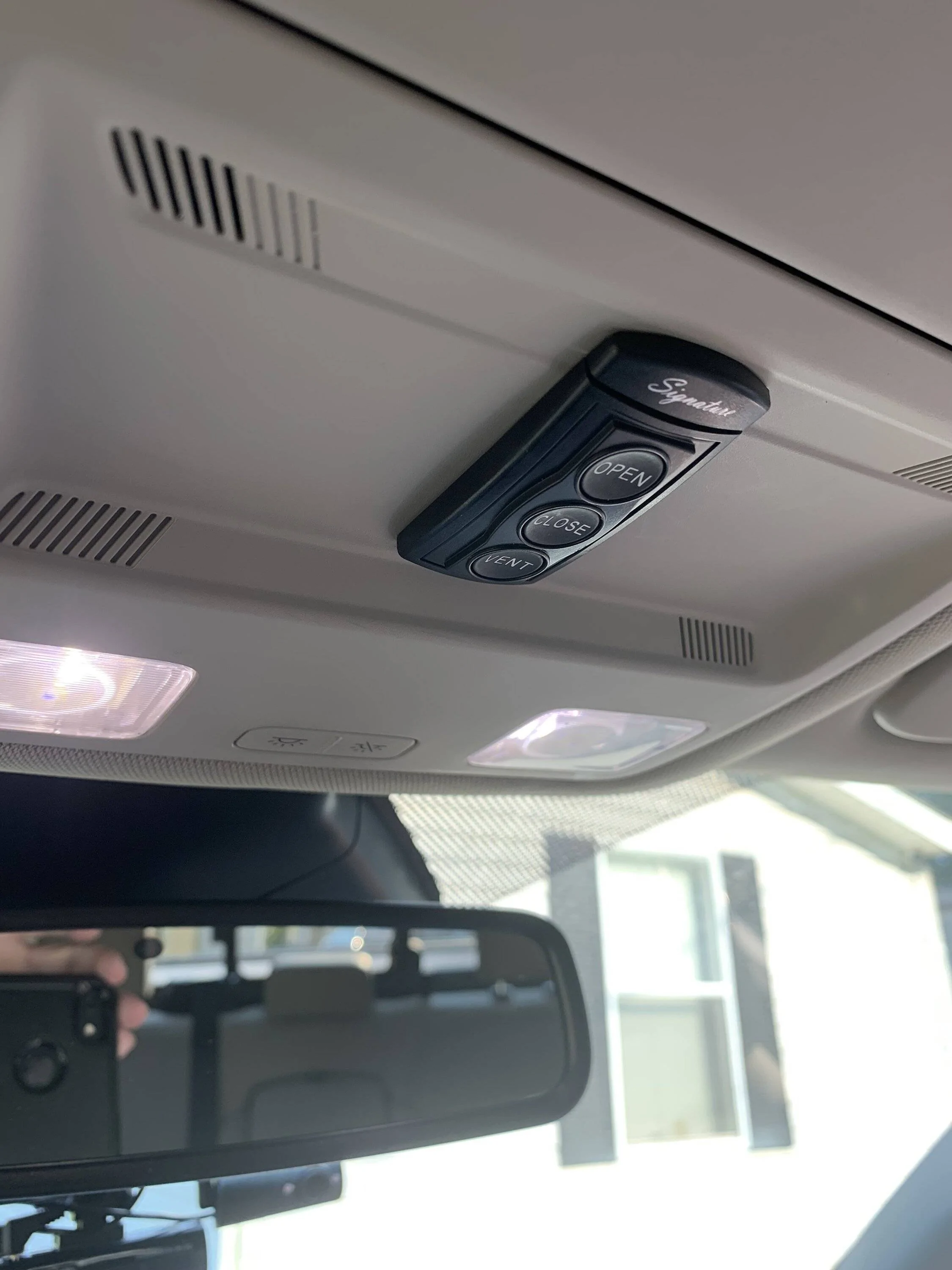

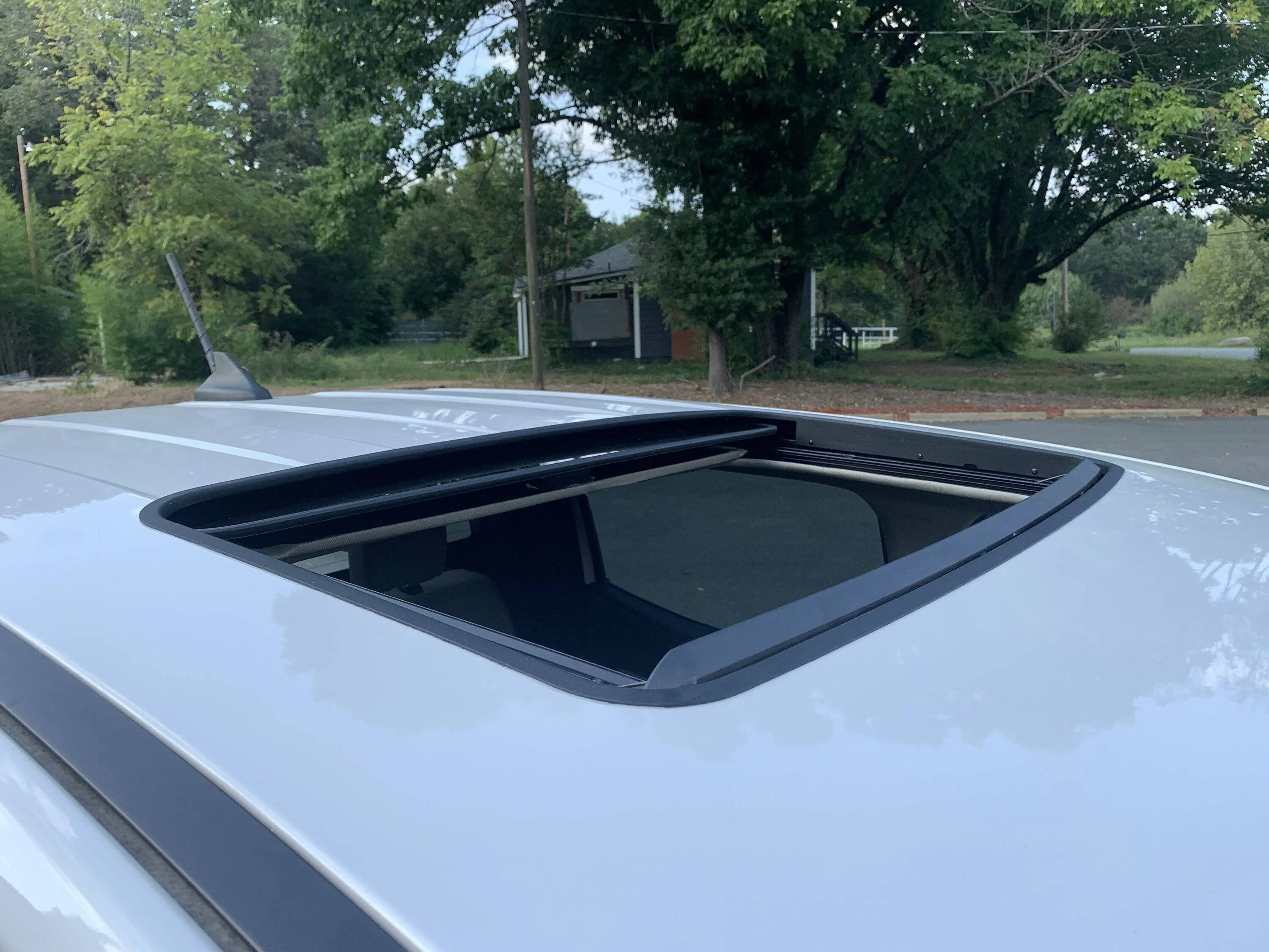

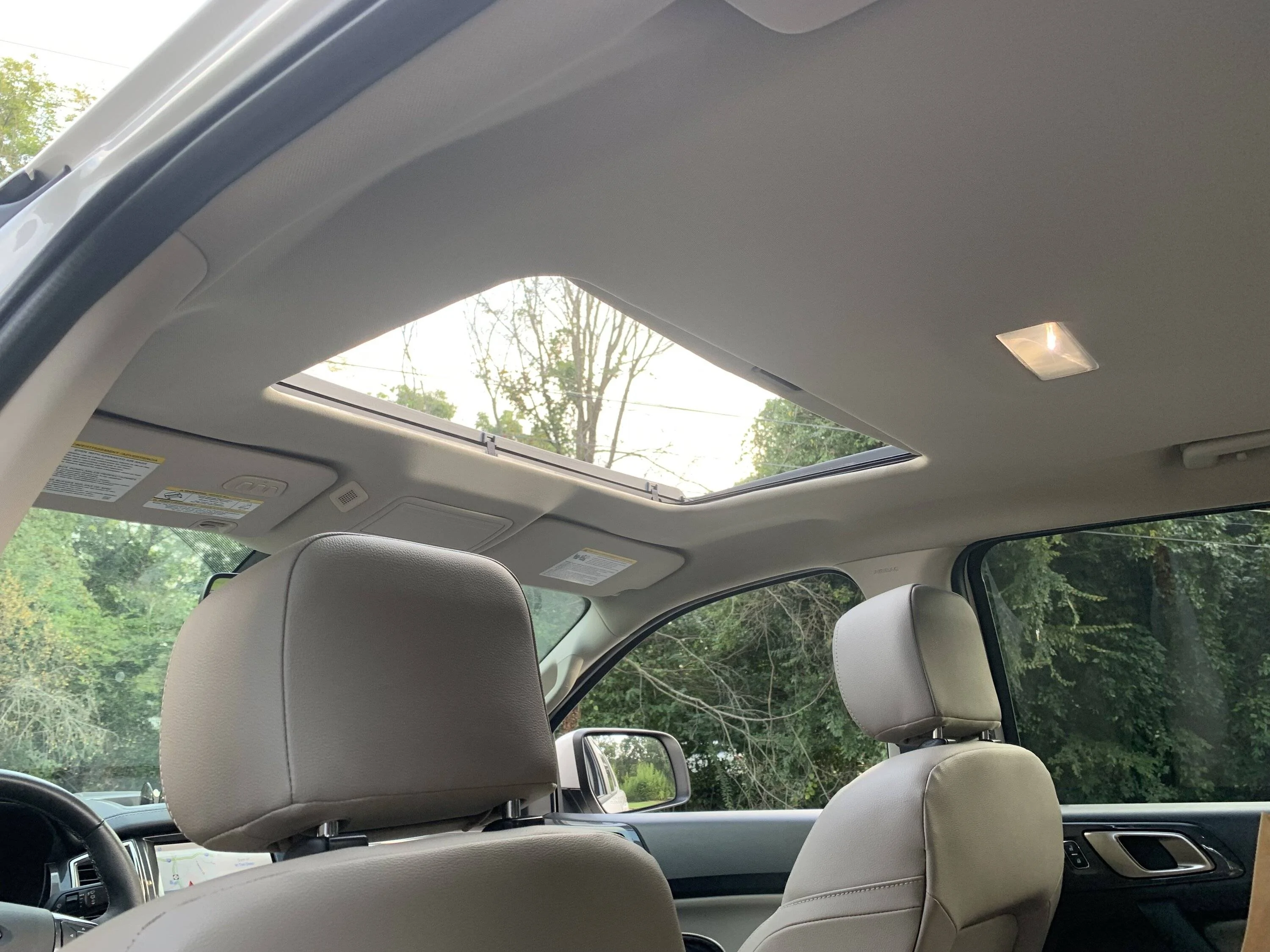

Oh goodness yes! I open it at every opportunity except during rain and extreme temps, then I use the 'vent' position.
Nearly every 4 wheel vehicle we've owned beginning with our first new car, a 1985 Chrysler LeBaron GTS (pop up) has had a moonroof.
We had a pop up moonroof installed in our first Ranger (1988 XLT standard cab 2wd). Our 2001 and 2006 Ranger SuperCabs with the suicide doors wouldn't accept moonroofs.
We were told originally the 5g Ranger wouldn't accept a moonroof but that turned out to be a load of crap. Signature and Hollandia both make moonroofs for the Super CrewCab.
The 5g SuperCab may be another story.

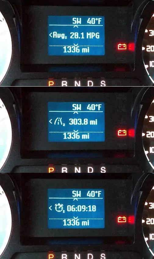

Finally did a proper road trip. A bit late for leaf peeping but a beautiful day to drive through the White Mountain National Forest and pass by Mount Washington.
Kept my eye out for a certain forum member's Ranger while driving through Gilead, Bethel, West Paris, Norway, Oxford, and Poland Maine.
AND ... finally got great gas mileage.
Started out on 93 octane after the latest SYNC update and with just over a thousand miles on the truck. We averaged about 49 miles per hour with some stretches hitting the upper 70s. The hilliness isn't too bad but we did cross the Appalachian Trail and go through a few notches.
At just over a half a tank, I topped off with 91 octane and am happy to finally see decent mileage.
I'm sure this isn't accurate but considering the system was showing me 16.4 mpg at times, I'm happy to see it read higher. Lots of cruise control (not adaptive in Soupie) and light on the gas pedal.
And I didn't forget Soupie's dump roots!
I had about a third of a bed's worth of leaf mulch. I should of opened up the tonneau and shared this lovely mulch! =p
Kate, Cheech, and I found the long ride time to be comfortable (although Cheech was getting stir crazy toward the end, especially when I missed our exit home and had to do another 20 minutes to get back!).
I'm sure the graphene must have helped with that MPG! =p
Drumroll ... 28.1 MPG!
