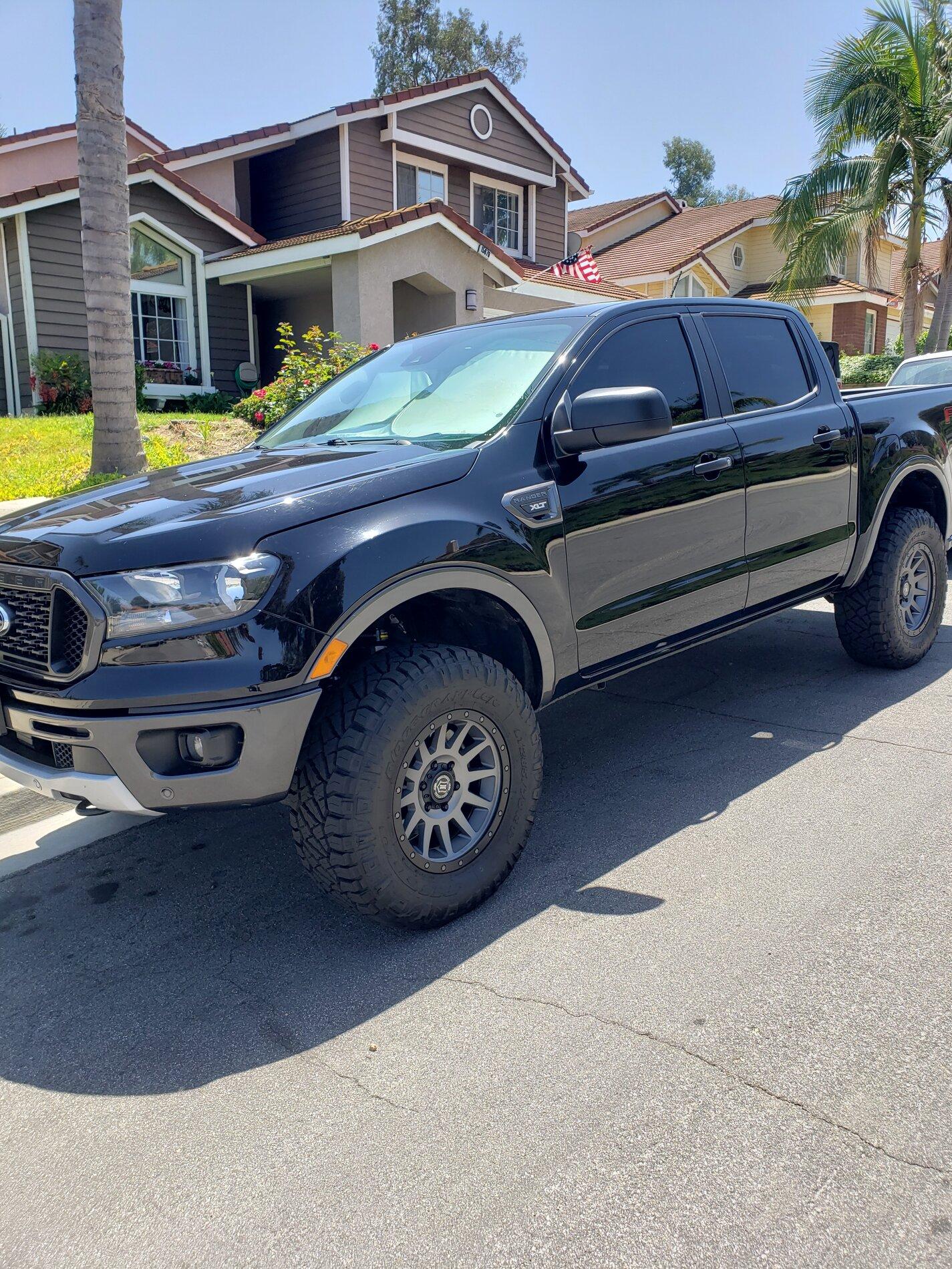

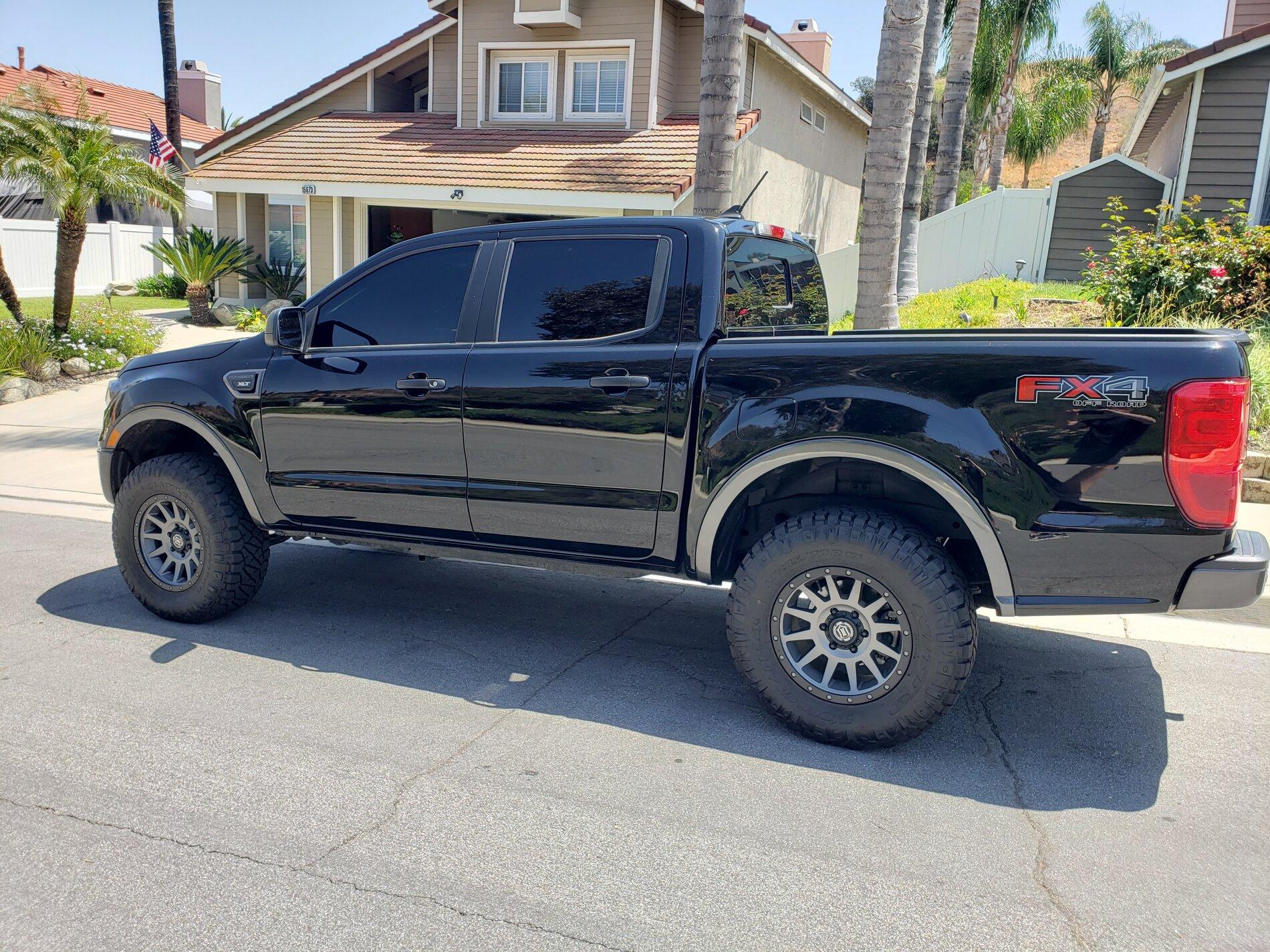

I just put on this new Icon 2.5 coilover kit, with upper control arms and rear shocks. I also added 285/70/17 Nitto Ridge Grapplers, mounted on these 17×8.5 wheels with a 25mm offset. The truck looks and rides great. It's a lot more trail capable, especially with the difference between the stock tires and new Nitto's.
I am taking a hit in MPG. I'm not sure if that would improve much with an aftermarket tune plus a cold air intake? I'm thinking about getting the Livernois tune and Roush cold air intake. Does anyone have any experience with these and thoughts one way or another?
Lookin sweet! Nice wheels!!
I have the 2.5's front and back with the adjusters.
My rear springs are apg deavers and it was night and day over stock. If you have a nice ride with stock springs then just keep em unless you don't mind taking a trip to the bank for em.
I'm running metric 33's too (285/75/r16) and I have no idea what my mpg's are lol.
I have a Mishimoto performance intake [not a cold air intake the main feature is the smooth elbow after the box which reduces turbulent air flow and increases flow rate by 50% and of course the cool filter (whatever lol)] definitely feels better

Thanks! Your truck looks sweet! Do you know if the Deavers have the 0
Thanks! Your truck looks sweet! I can see you have a few things on your truck that are next, on what's becoming my never-ending list, lol.
I'm really considering the Deaver leaf pack. Do you know if the payload and tow rating is still as high as the dealer FX4 leafs with tow package? Because I want those Deaver leafs for off-roading. But I still tow and load up the bed from time to time. Hoping for the best of both worlds.
Looks like you got rock sliders too? Are those the Shrockworks ones? I want to install Sliders next, then maybe a better skid plate.
Anyway.. nice truck! It looks bad ass

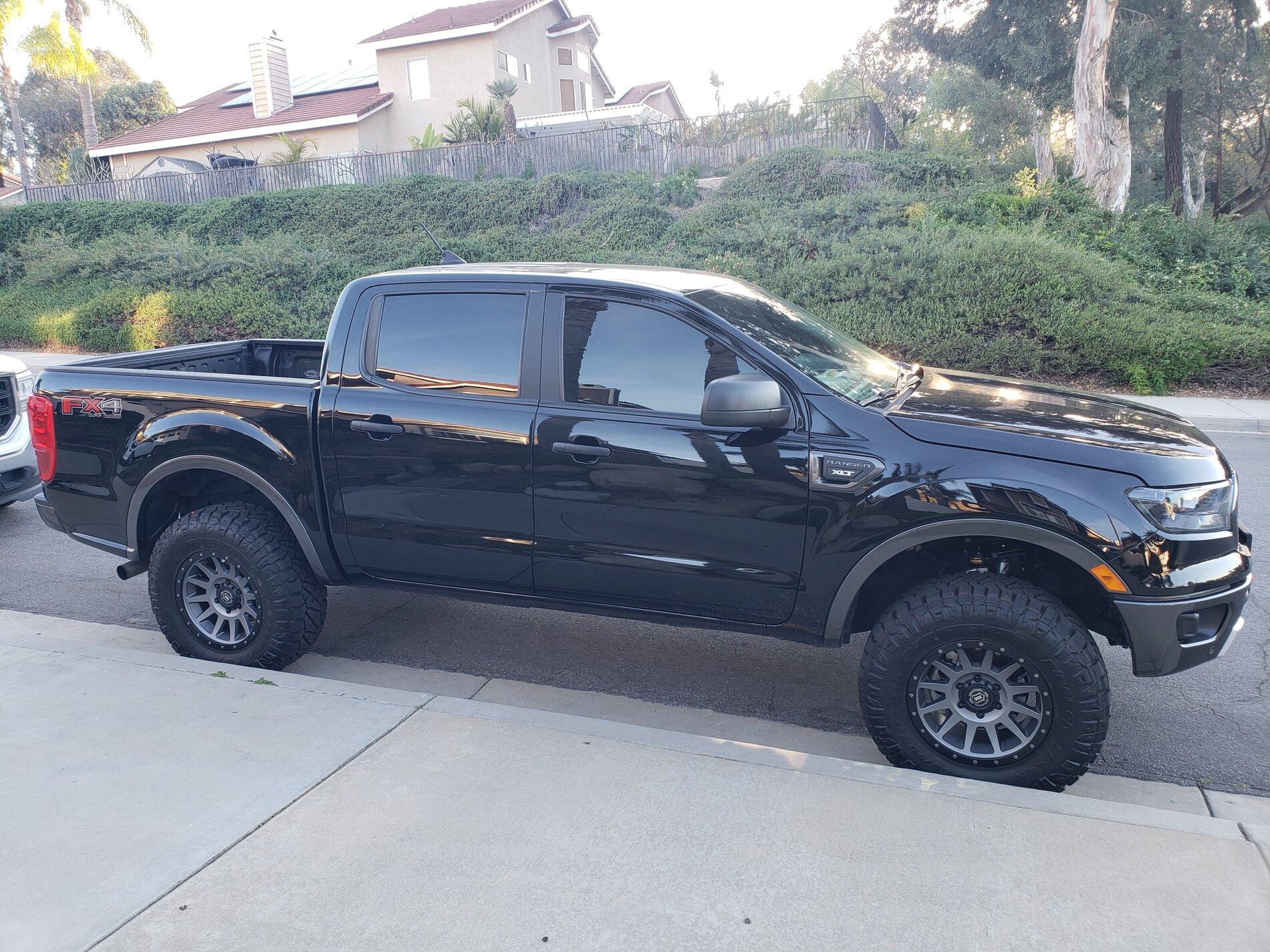

Never ending seems about right, tell me about it man.
I have no idea whatsoever about the deavers and towing. I only kept my bed to haul my my little pit bike to fart around on, and it actually rides so plush with it back there, 200 lbs.
I don't have rock sliders, my wife kept complaining about the ride height after leveling the front so I bought the steps that had minimal stick out and are actually level with my frame so they really aren't worth a crap I just kinda did it to say here you go lol.
But man with the 2.5's and some weight in the back it absolutely makes the ride even better.
I removed the stock spare and it actually made a difference and rode rough so I'll be putting 2 spares in the back when I go to 35's.

That's funny.. When I bought my truck it came with side steps.. They protruded out much more than the ones you have. I hated the look of them and just knew I'd clip them on something.. So I took them off. After installing the 2.5 coilover kit and putting on the 33's, my wife is complaining about the ride height too ?
