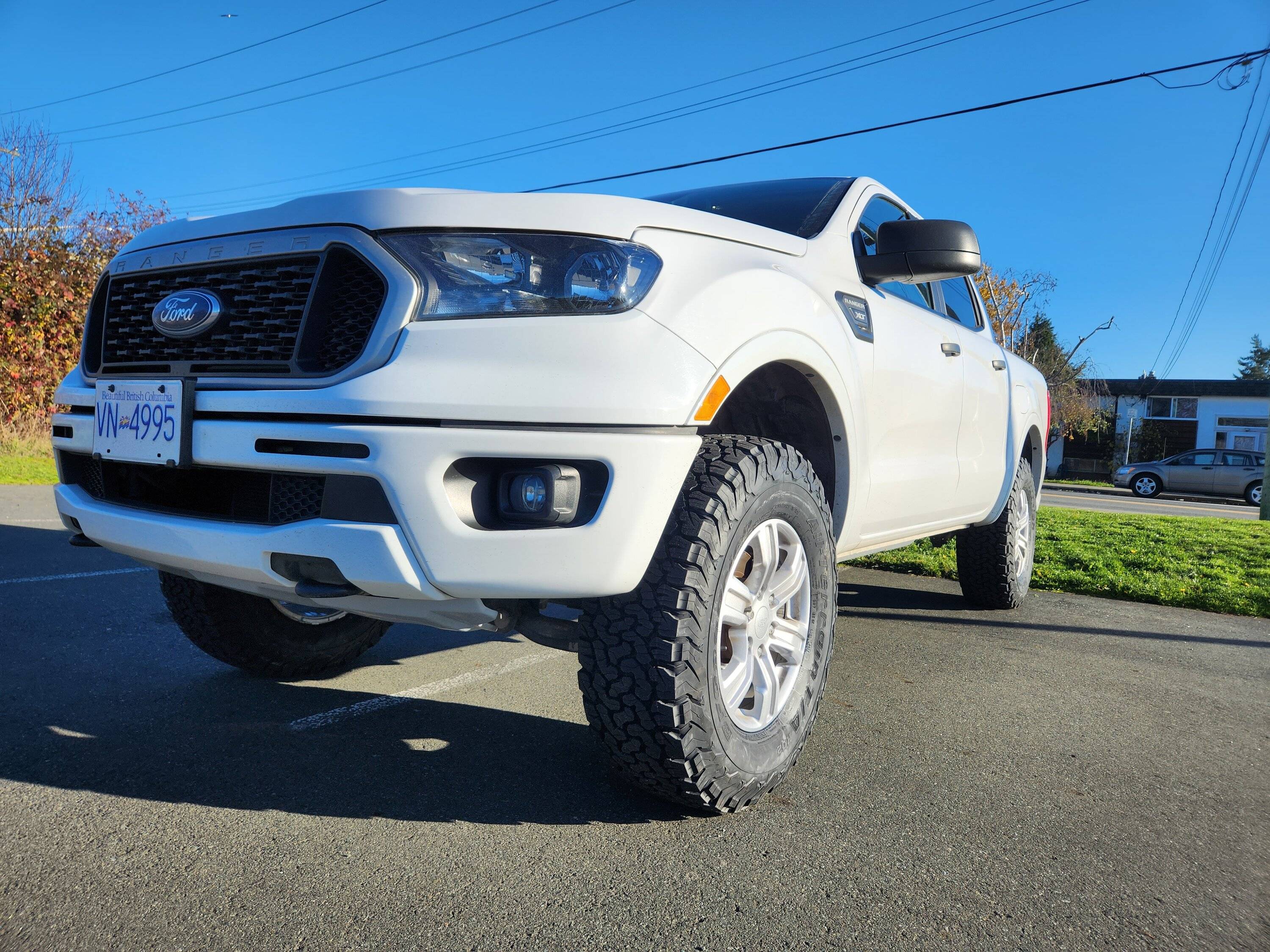

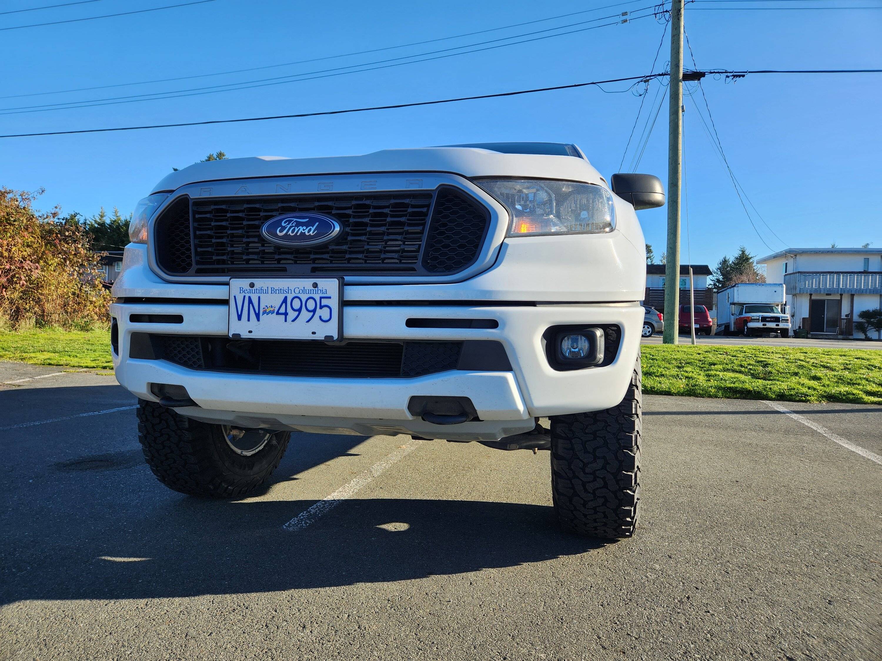

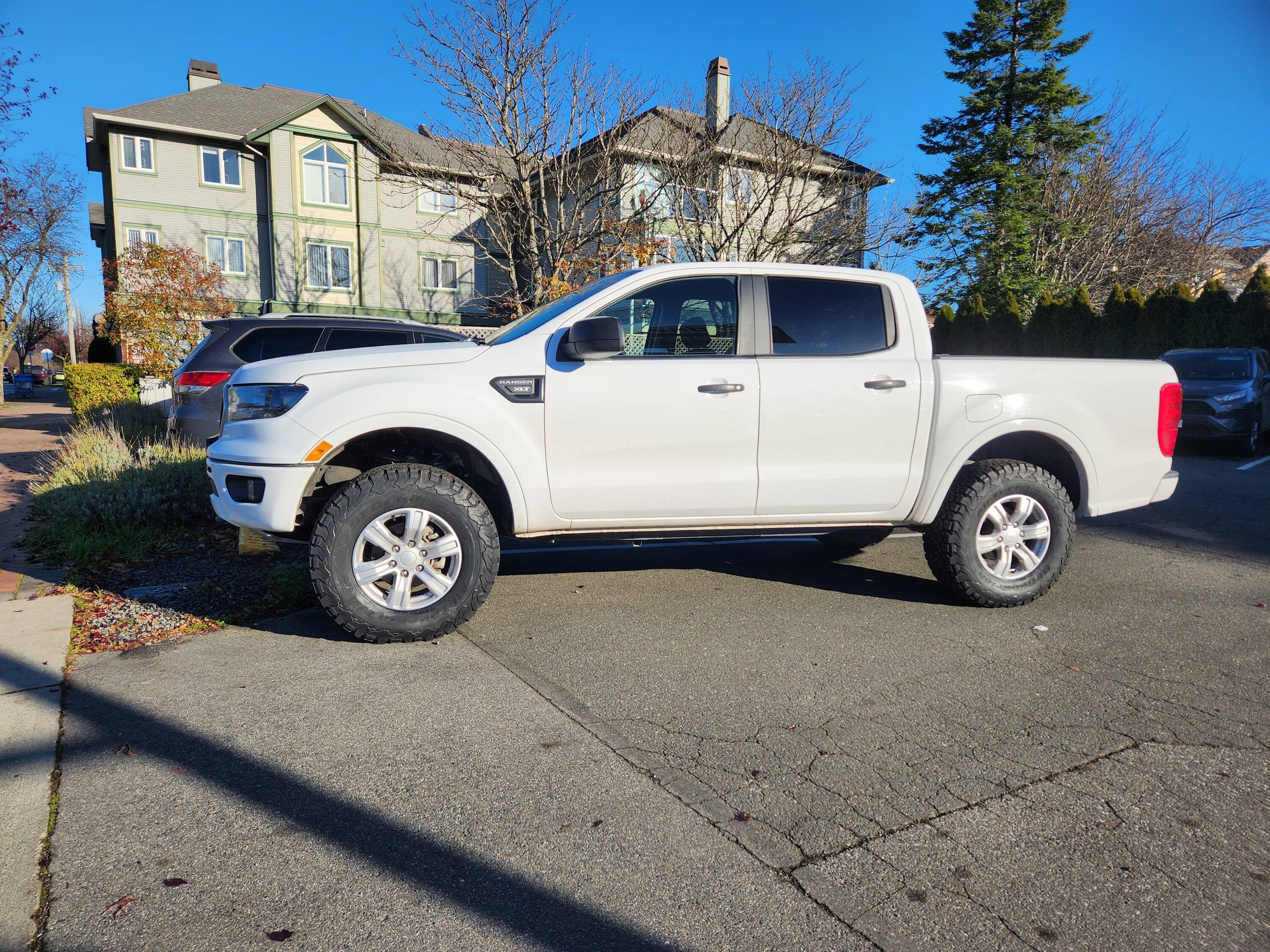

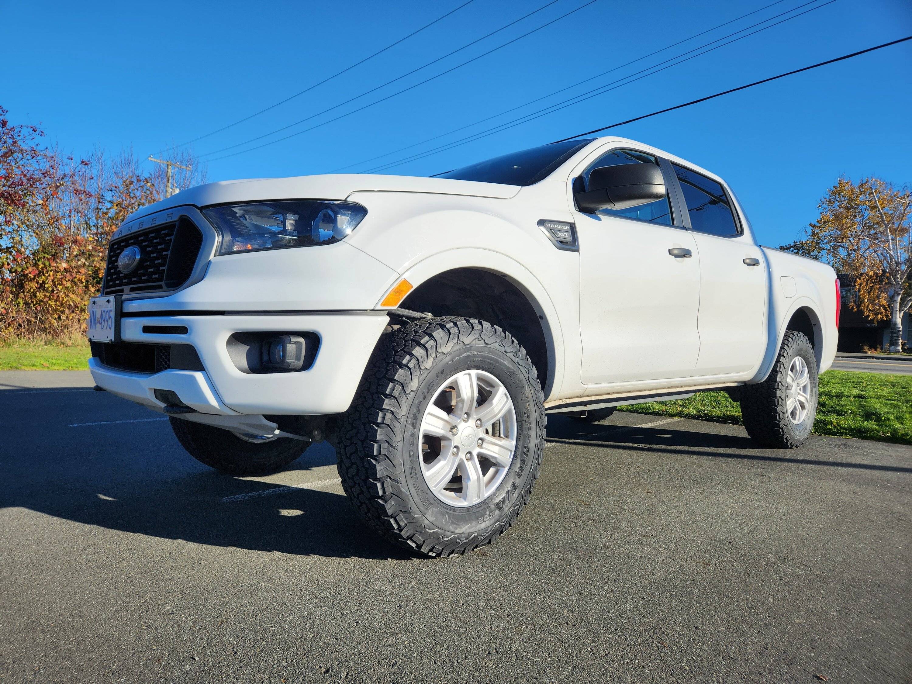

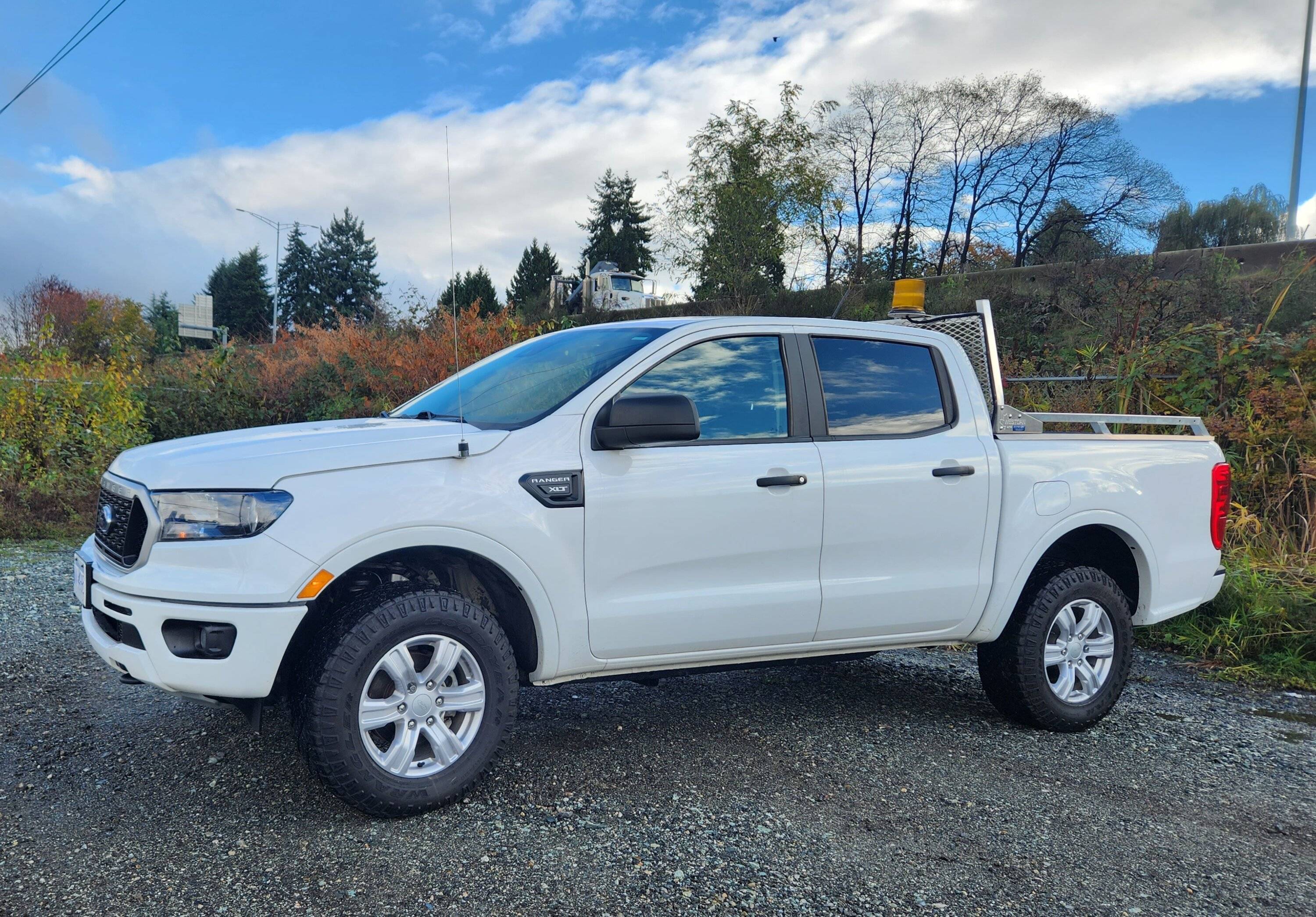

New to me 2020 off lease. Installed 2.5" level kit and tires.
Was an off lease City of Vancouver truck. Swapped out the aluminum rack and orange light for a Bakflip MX4 hard tonneau.
Heading south from Canada to Baja in 3 days!

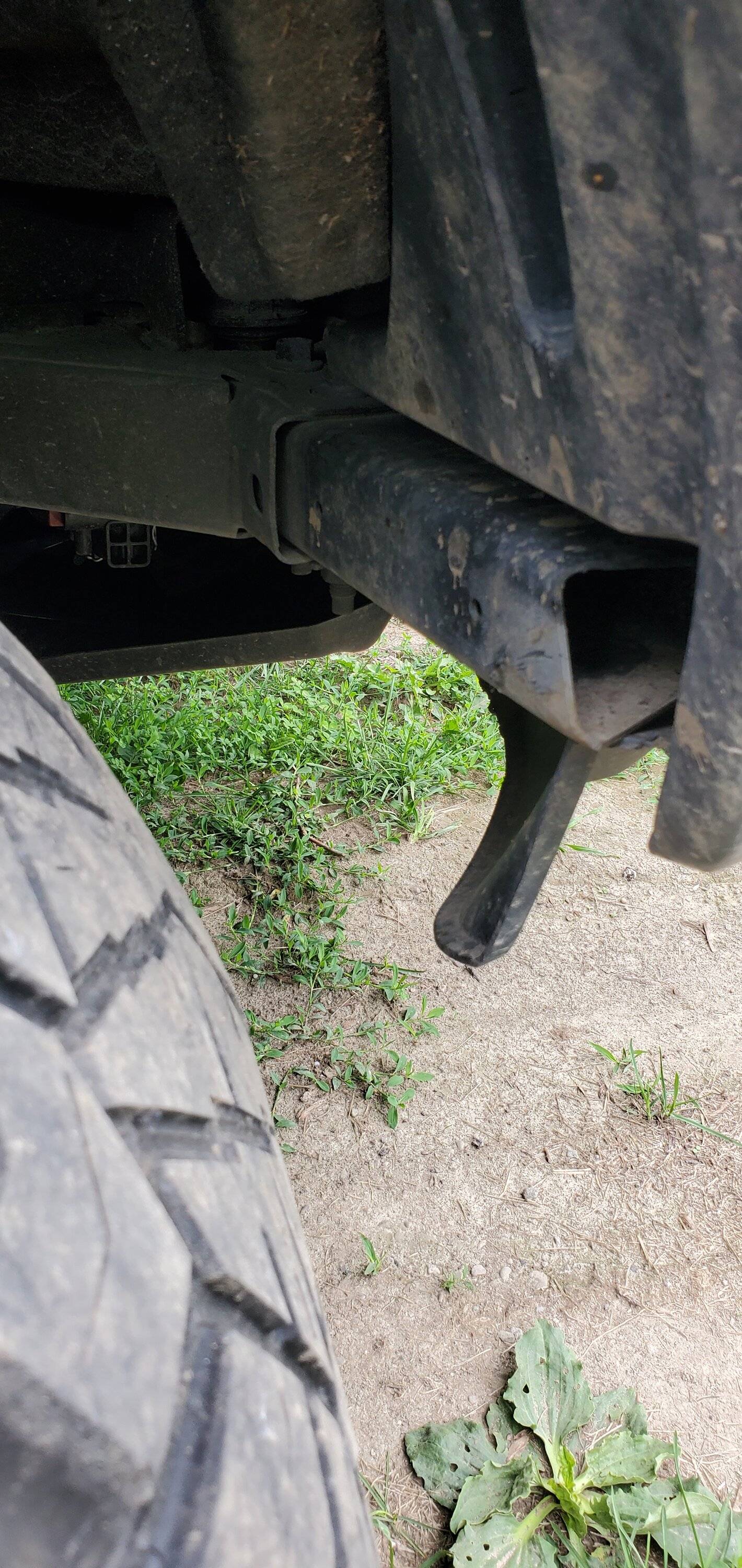

Crash bars are still in there. Only minor rubbing on the sway bar at full lock.

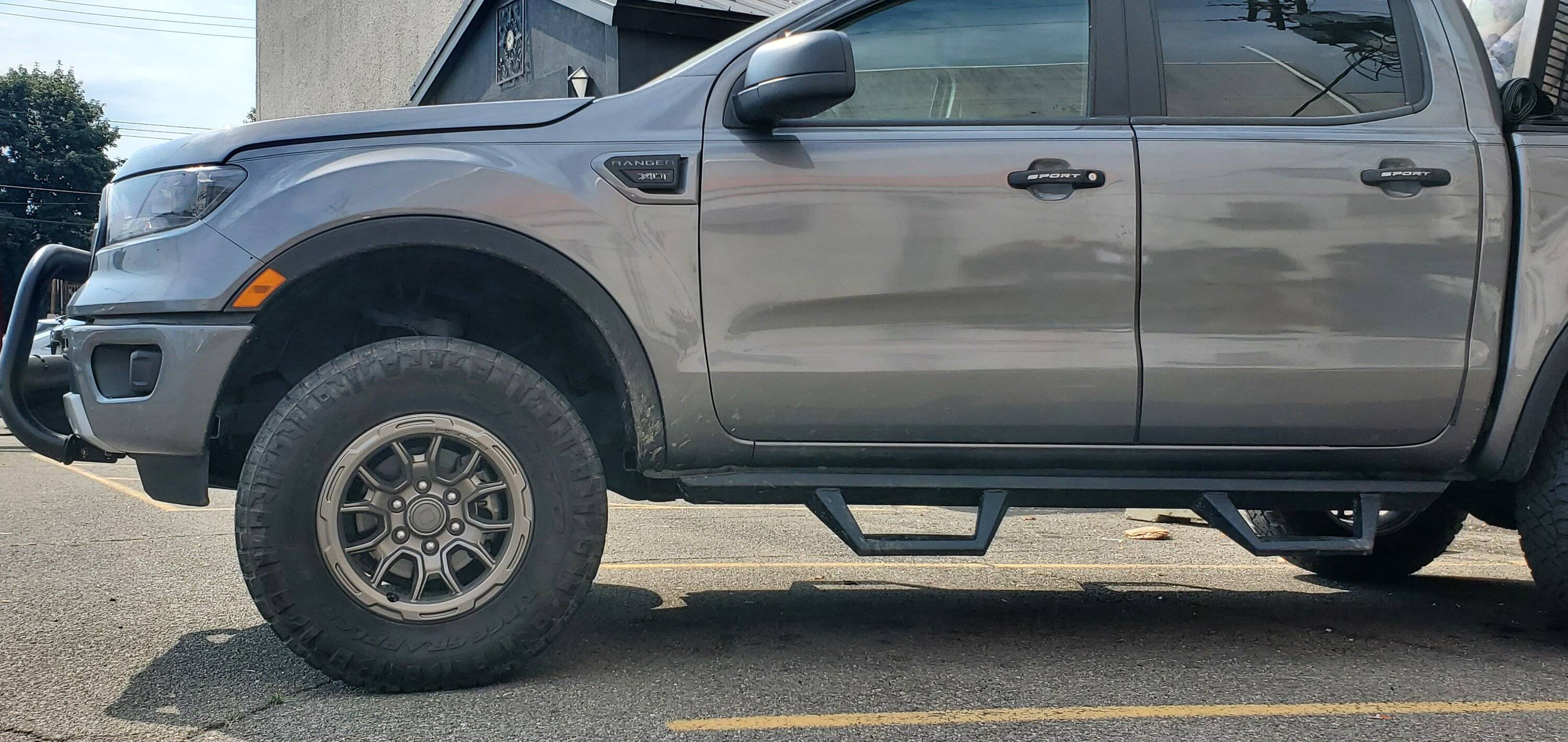

I have an RC lift running 285/70 no rub, still have my crash bars

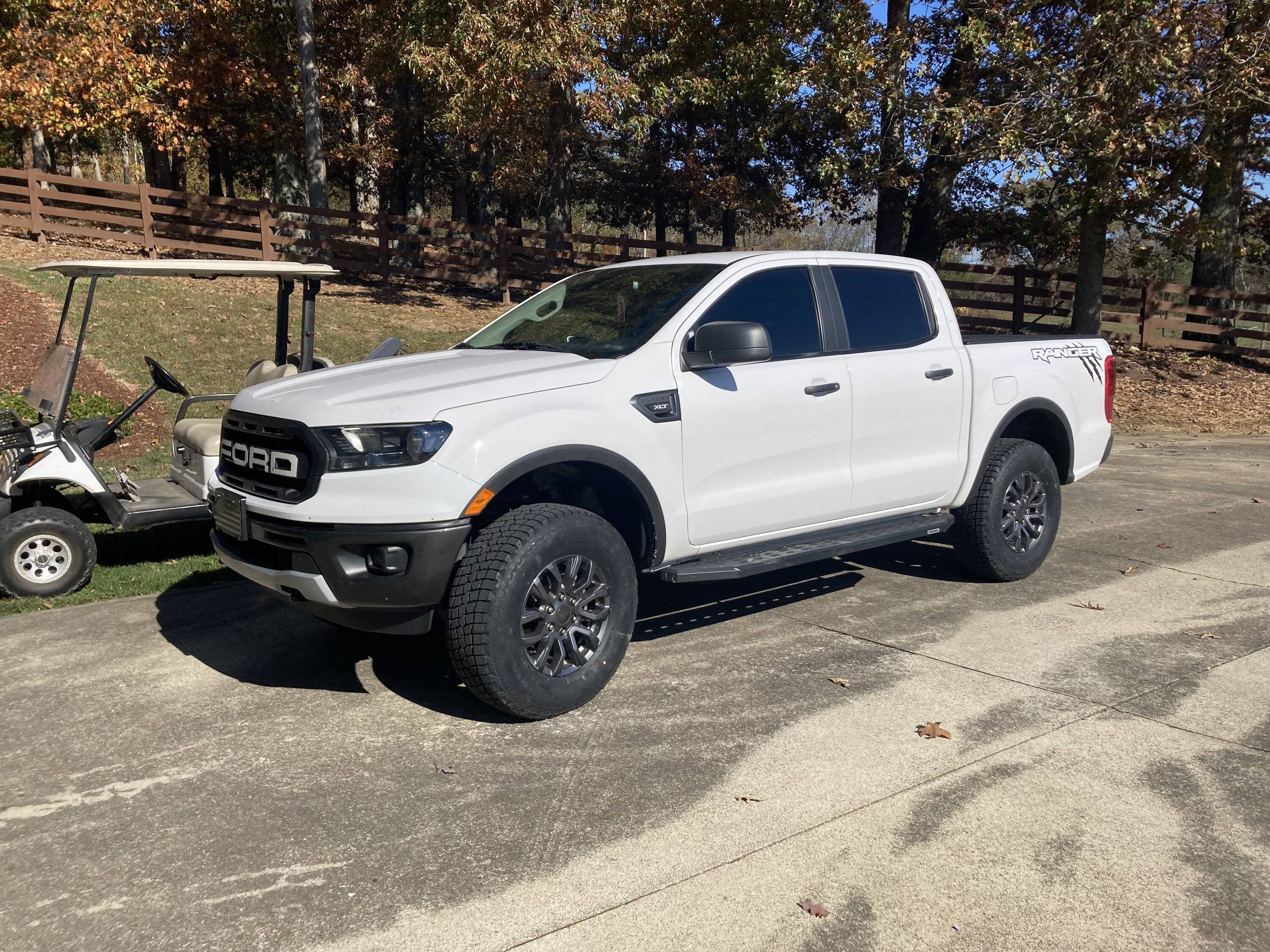

2.5 level 285/70/17 stock wheels. Front crash bars removed. No rub

No spacers. Crash bars still in.
Only very slight rub on frame at full full lock. Only on passenger side which is strange.
Lots of offroad driving, no issues.

No spacers. Put cheapest tire I could find because was afraid if I would not be happy long-term. milestar patagonia m/t. Actually pretty happy with tire so far...10k miles. Bought 1/4 spacers but studs to short without changes. Bolted on without and happy with setup.
