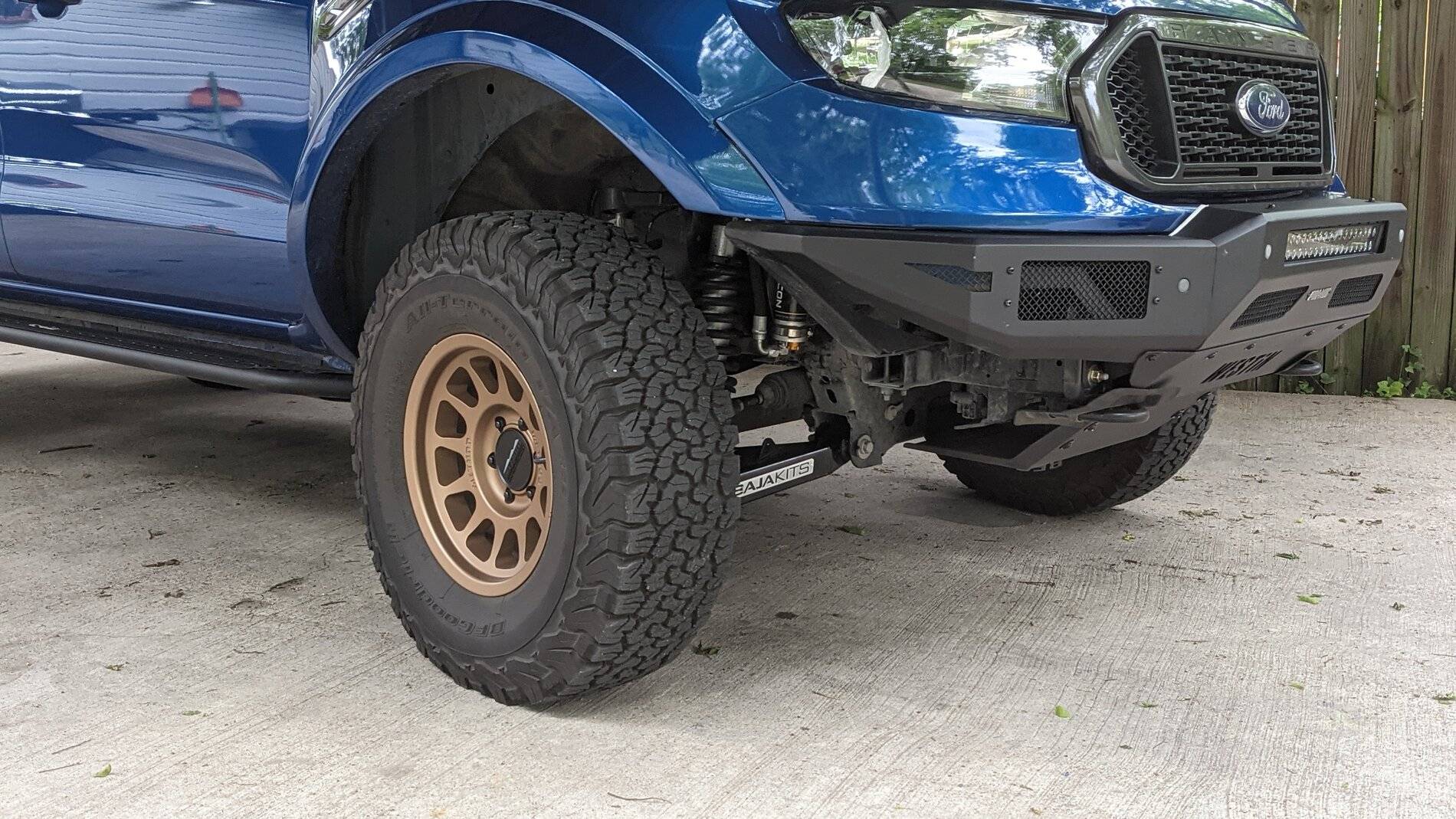

Lookin sweet! Nice wheels!!
I have the 2.5's front and back with the adjusters.
My rear springs are apg deavers and it was night and day over stock. If you have a nice ride with stock springs then just keep em unless you don't mind taking a trip to the bank for em.
I'm running metric 33's too (285/75/r16) and I have no idea what my mpg's are lol.
I have a Mishimoto performance intake [not a cold air intake the main feature is the smooth elbow after the box which reduces turbulent air flow and increases flow rate by 50% and of course the cool filter (whatever lol)] definitely feels better
Are those Method MR703s?

The fitment looks amazing. Don't mean to thread hijack but you are running 16s, right? Did you go 0 offset or 35 offset?
Cheers!
Yea I'm running 16's with 0 offset.
The reason I'm running 16's is because I wanted the sidewall to look thicker on a smaller rim with 33's. But I regret it now that I have fiberglass because who knows how big I'll go in the future but with 16's I can only go up to 35's. 35's look perfect but later later I'll probably cut some of the fiberglass to fit 39's or something once its fully caged and I get a new beefy rear housing. Probably another 2 years.
Another thing is the offset. I think 0 swings the wheel out a little too much at full lock if you look at the icon wheels they like 25 offset which makes sense. 25 pushes the wheel out to fit wider tires without spacers without swinging the wheel out at full lock.
I recommend 17's with a 25 offset wrapped in 33's (or a little smaller diameter if you want to keep crash bars or don't lift the front high enough).
Hmmm ok. Yeah I really want the meatier tire look on 16s. I don't have any plans to ever exceed 35s (probably even 33s) on my truck. It will only see moderate weekend trail action too, no crazy stuff. I was going to do bilstein 5100s on all 4 corners with the front set at 2" of lift.
