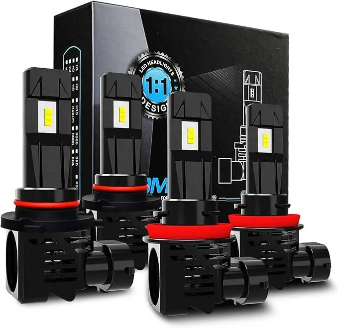

I'm looking at these GTR lights and cant figure out which bulbs I'd need?
Tried calling and no one answered, and none of the products have reviews?
Not really a good sign
Anyone have these and can tell me which ones I'd need for a 2021 ranger with halogen lights (4 bulbs total)

What brand is that?
Nobody flashing you Sid?

https://www.amazon.com/gp/product/B07YP1819N/ref=ppx_yo_dt_b_search_asin_title?ie=UTF8&psc=1
Zero flash back since I re-aimed my lights after leveling...that was at least 100K miles ago...
This bulb hasn't been in stock at Amazon for a long time...you can try other sources...
The key to this design (which I repeatedly beat to death) is the 1:1 design...that means the lighting element is positioned EXACTLY where the factory bulb filament is positioned...that allows the same projection performance as intended except putting more light from the LED on the the road...majority of LED bulbs don't take this in to consideration and therefore, light source is out of position and light bouncing off the reflectors not aimed down the road but shooting everywhere but...this is what causes glare that people are complaining about...because 90%+ of LED drop ins are improperly designed, everyone poo poos LED replacements...
Other brands that describe their bulbs as 1:1 design will do the job correctly as well...this is not a proprietary concept...just THE correct one...
GTR Ultra 2 9005. I purchased mine from Headlight Revolution for my high beams.

Are these the same H11 bulbs, simply labeled for fog lights?
https://www.amazon.com/JDM-ASTAR-Performance-Bright-White/dp/B07X3XYL5K
Any idea which ones for the lows.
They all say fog light LoL
