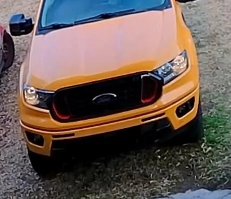

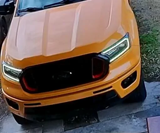

I can give the security cam images for now.
Old halogen DRL mode

Anzo DRL mode.
