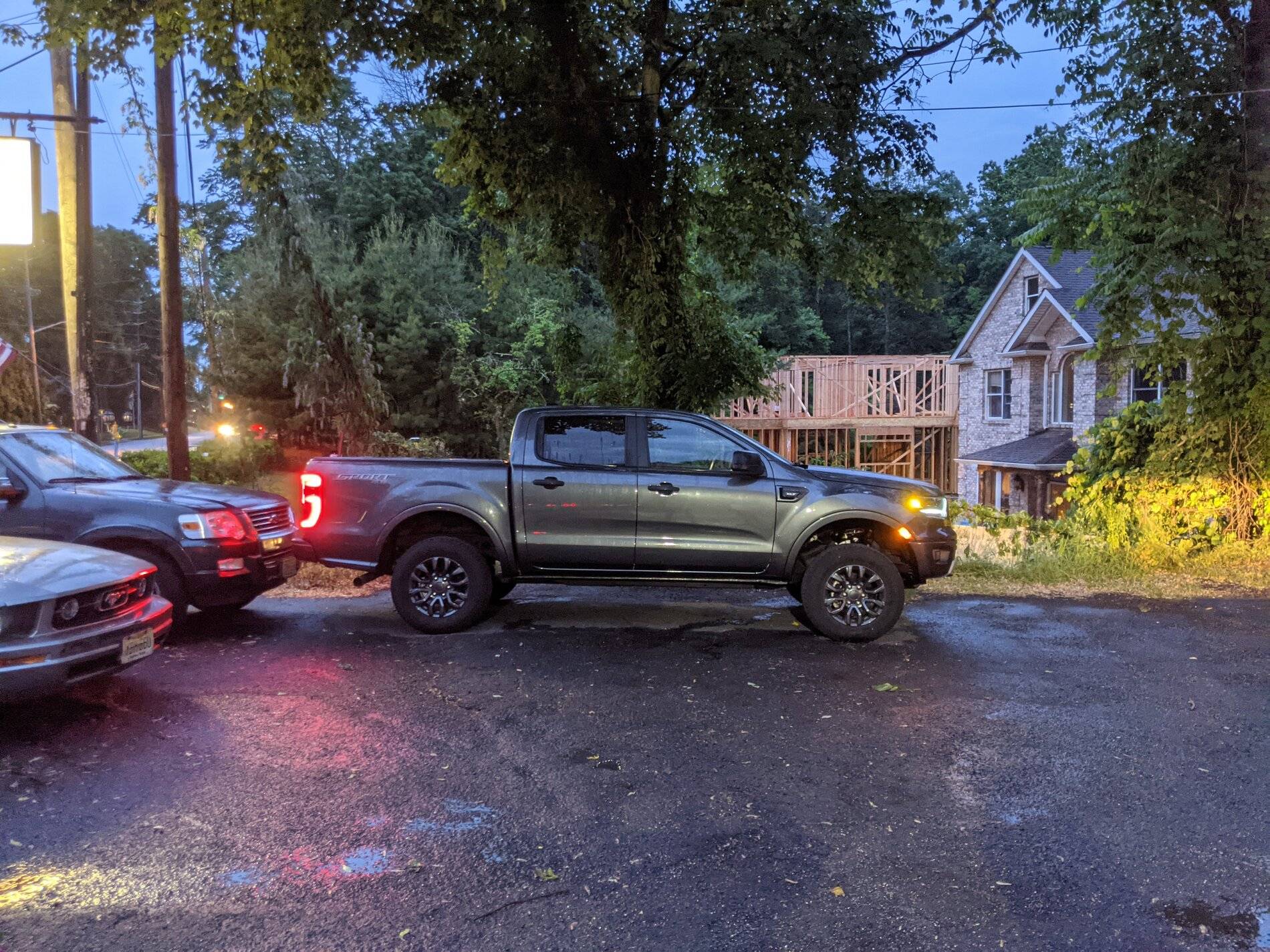

Icon Tubular Upper Control Arms and Fox 2.0's installed. put probably 300 miles on the truck since install and MAN. What a difference! Truck feels so much less wallow-y on highway trips. Feels like the dampening is exponentially better? could be using the wrong word. After many sleepless nights, my buddies shop had an opening so I had him install for cheap. I appreciate everyones feedback/advice on getting this done! I'm building a shed/bar in my backyard right now and just was running out of weekends.. i'm sure you all can relate.
Next Up: Livernois tune!
Next Next Up: talked to 4WP last Thursday, customer service rep stated estimated ship date on wheels/tires is today! Fingers crossed!

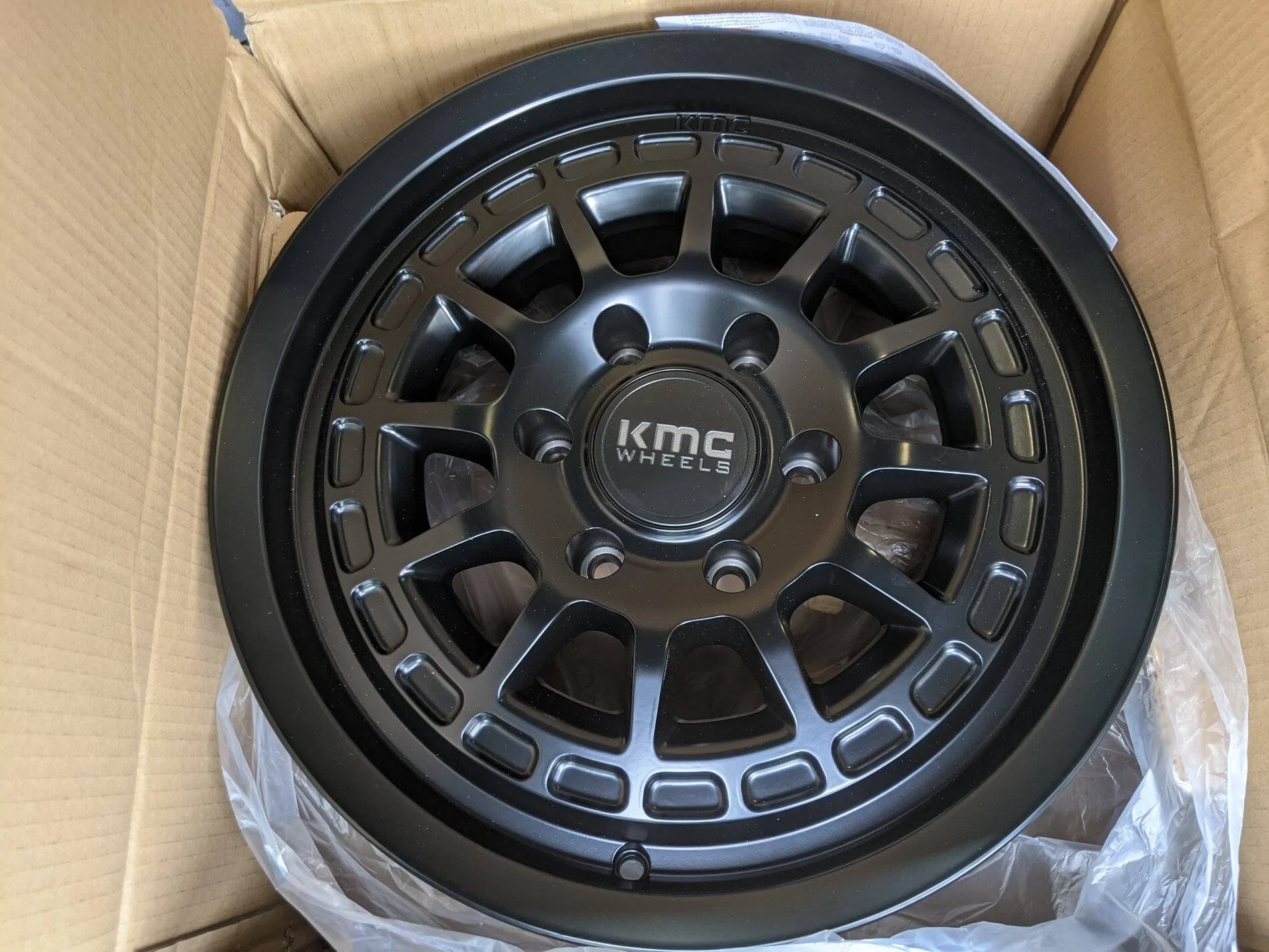

Wheels and tires are delivered. Trying to get them mounted this week, however I still need to find TPMS sensors. Anything you guys recommend?

So as of right now, they should have been on sunday. I had the wheels mounted last week and went to take them out of my shed and I saw a set of wheel weights (adhesive-based) laying on the floor and went uh oh thats not good. Lost about 3 strips of weights and lost confidence cuz I couldn't tell which wheel they came off of except for 1.
There's a curved 90 degree angle on the inside of the rim, I think when they balanced and slapped on the weights the weights must have been rested on this curved surface and not properly adhered. Couple that with being in a 110 degree shed with high humidity I'm assuming the adhesive failed. Had the guy order new wheel weights, dropping them off today or tomorrow I hope and having them on the truck by the weekend.

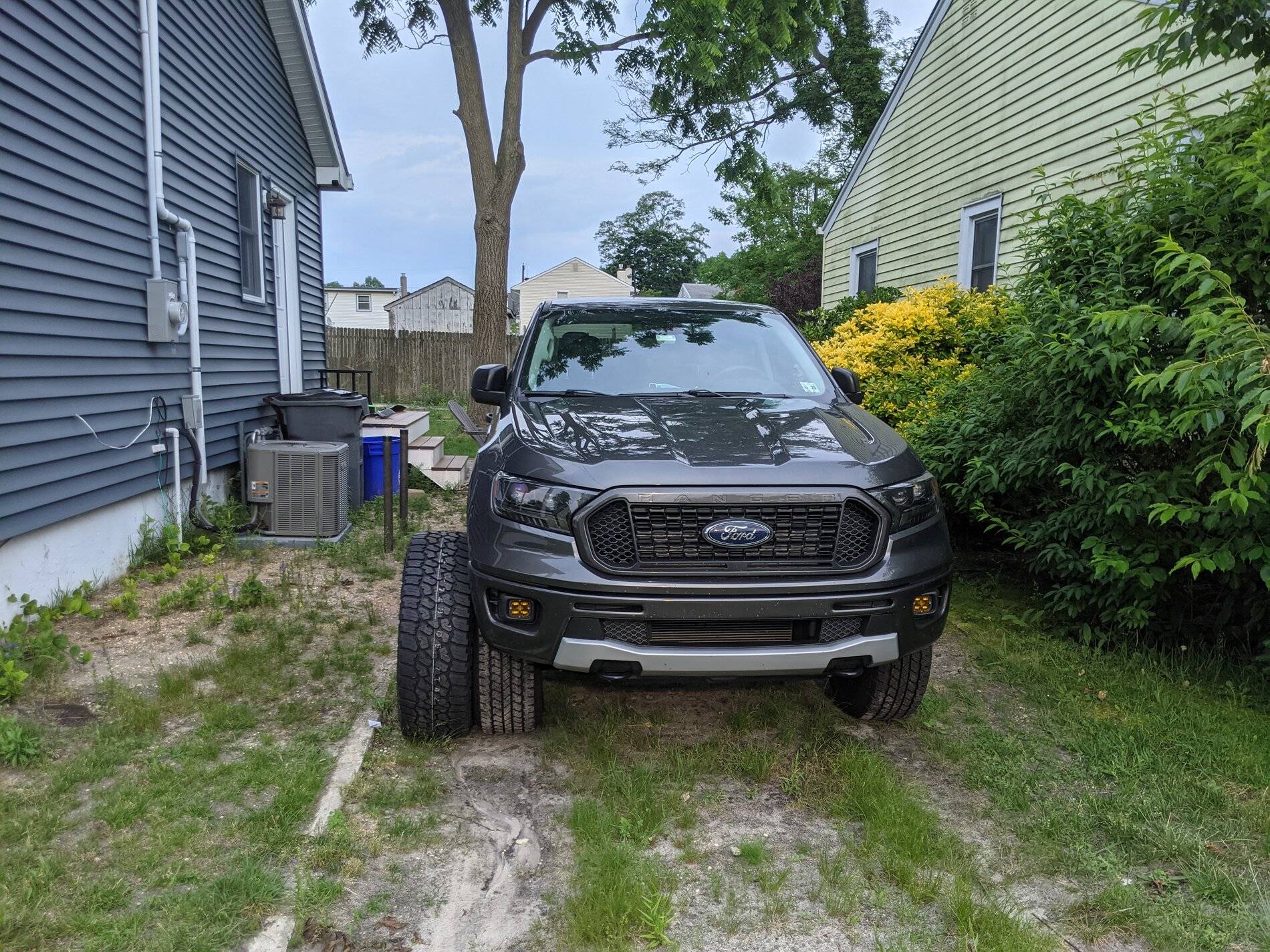

Only cutting I had to do was the rear intrusion beams. I replaced both the front and rear with the BDS kit which allows you to run up to a 33". Once I get them on the truck I'll confirm fitment etc

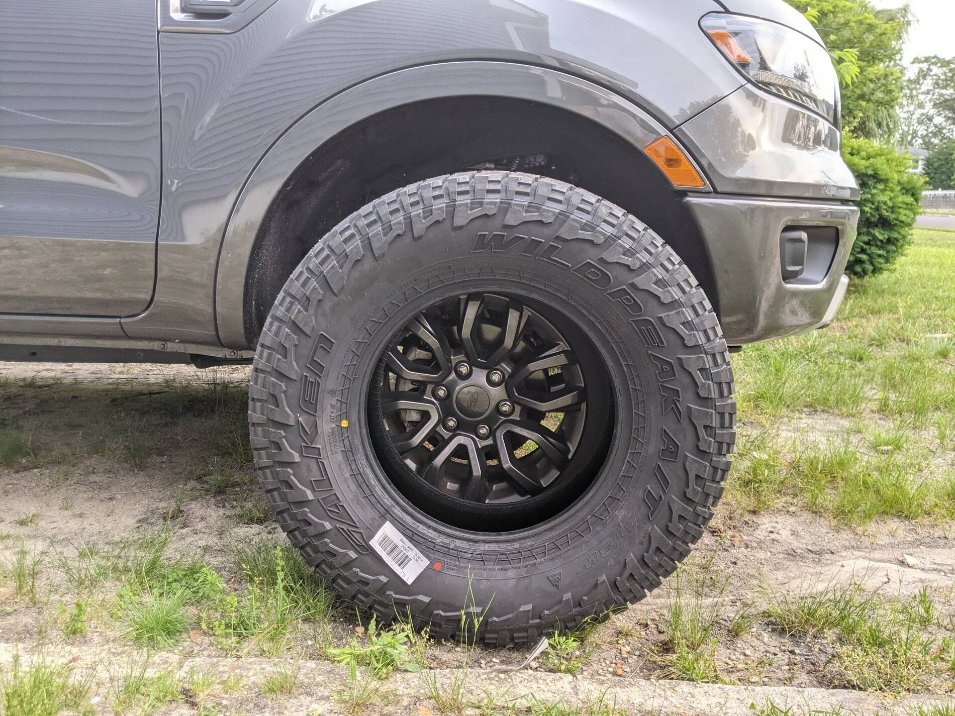

Well fellas... They are ON and I am BEYOND THRILLED for how this truck is coming together!!!!! It looks even better than I expected!!!!!

What offset did you go with for the Canyon’s?
+20, need to either remove your intrusion beams or replace with the BDS beams to get the clearance to run the 33. I had to heat up some of the felt anti-corrosion stuff as I bent it slightly when taking out the beams, but after I did that and alignment clearance has been perfect.

Looks really good. How is the road noise with the falken's?
Thanks man!!!!! Honestly so stoked with how it's came out so far. Next up is the Icon Progressive Leaf Packs.
Minimal increase in road noise at highway speed vs stock. Don't get me wrong: turn off the tunes, the AC, roll up the windows- you can hear them. But it's by NO means any type of drone, IMHO. Certainly not the BWAAHHHHHHHHHHH you get from brodozers on M/T's going 85mph...
***I got the C-rated 285's (P285) not E-rated
