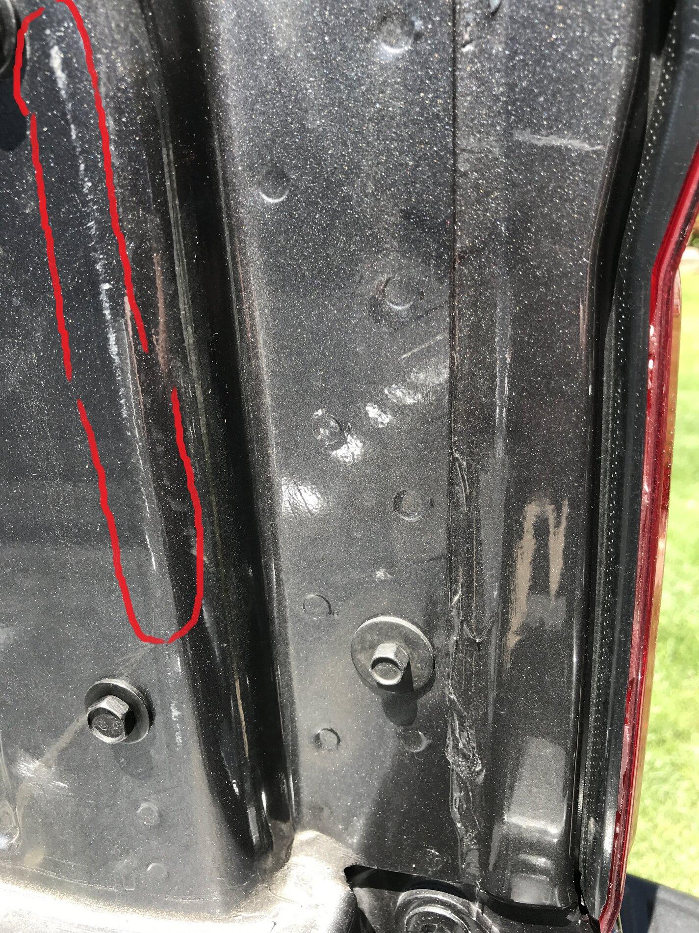

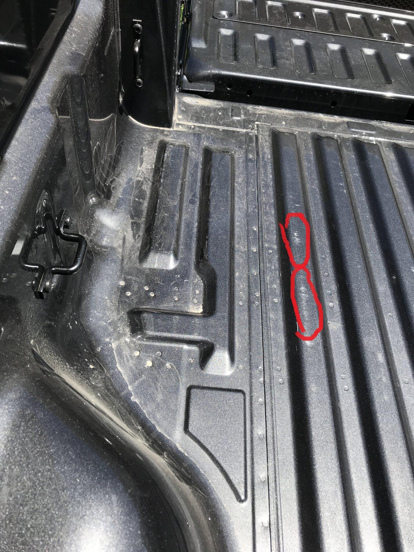

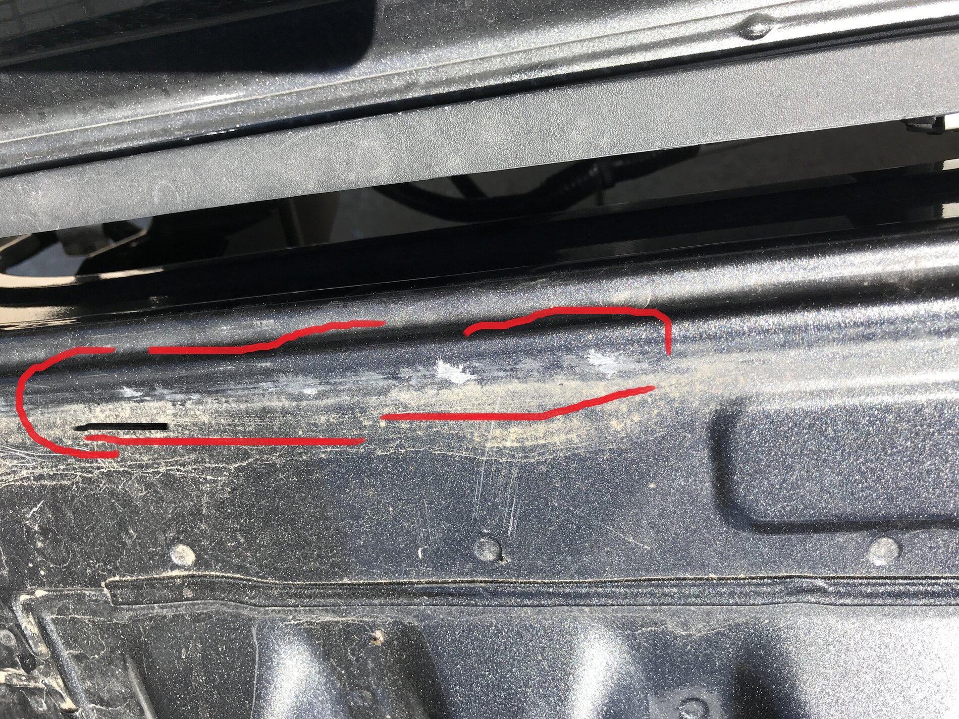

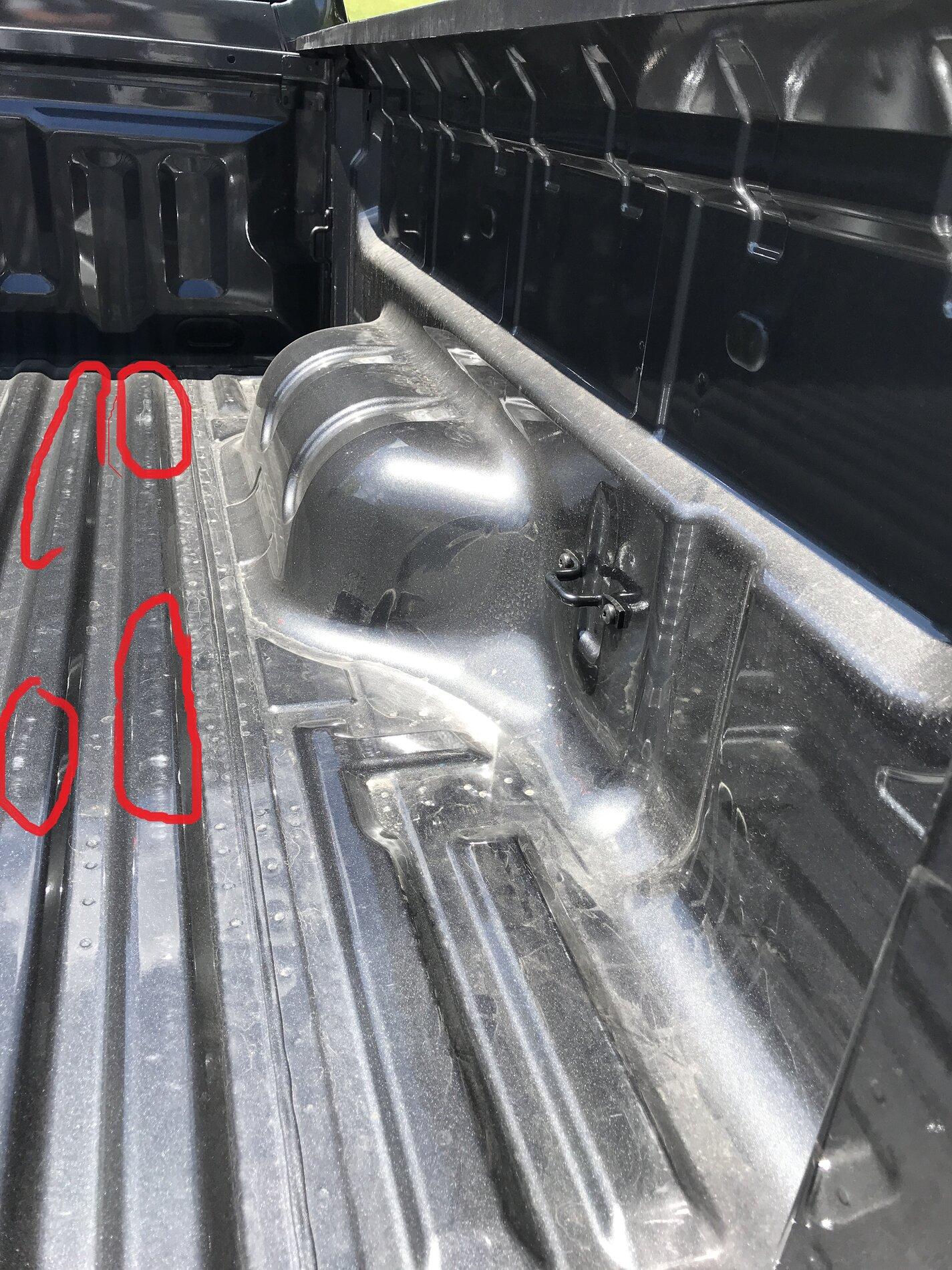

See the attached pictures of my 2019 at the time of removing the plastic liner at only 3,500 miles it has worn through the paint into the Primer at many locations and was probably going through the Primer to base metal soon. Note as well the fine dirt / dust collected under the liner acting as a sandpaper to cause wear.
I understand the Bed is made of aluminum and would not have a typical rust scenario but aluminum does corrode under a number of conditions so the question I did not want to experience is how fast it would degrade?

The bed is not aluminum, it is steel. The only parts that are aluminum on the Ranger are the front fenders, hood and tailgate. The rest is all steel.

Hey thanks for the clarification on the steel bed it makes the decision even more valid.
