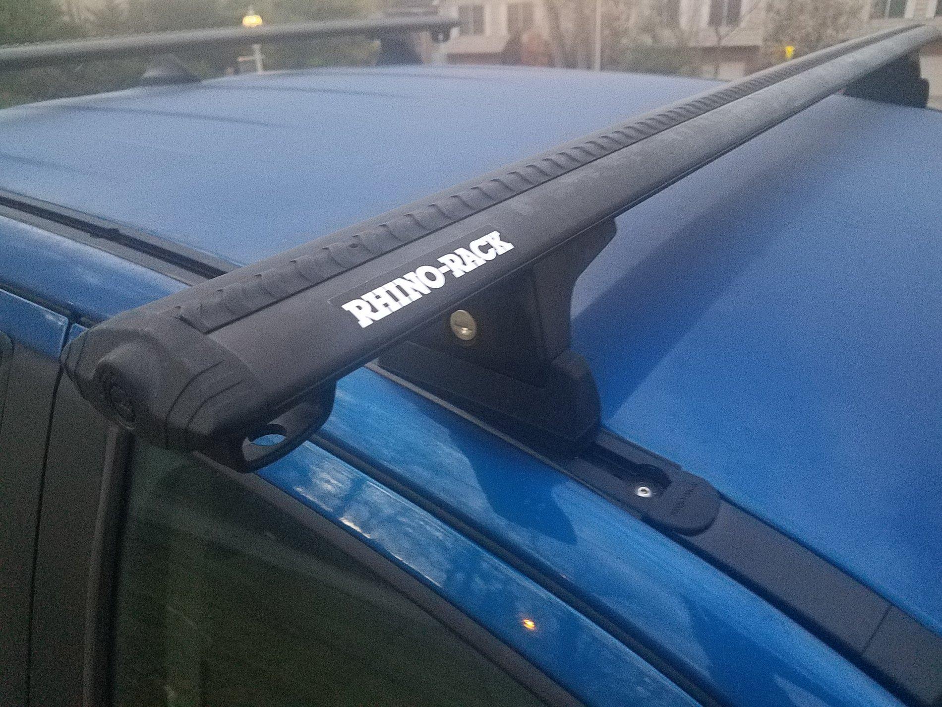

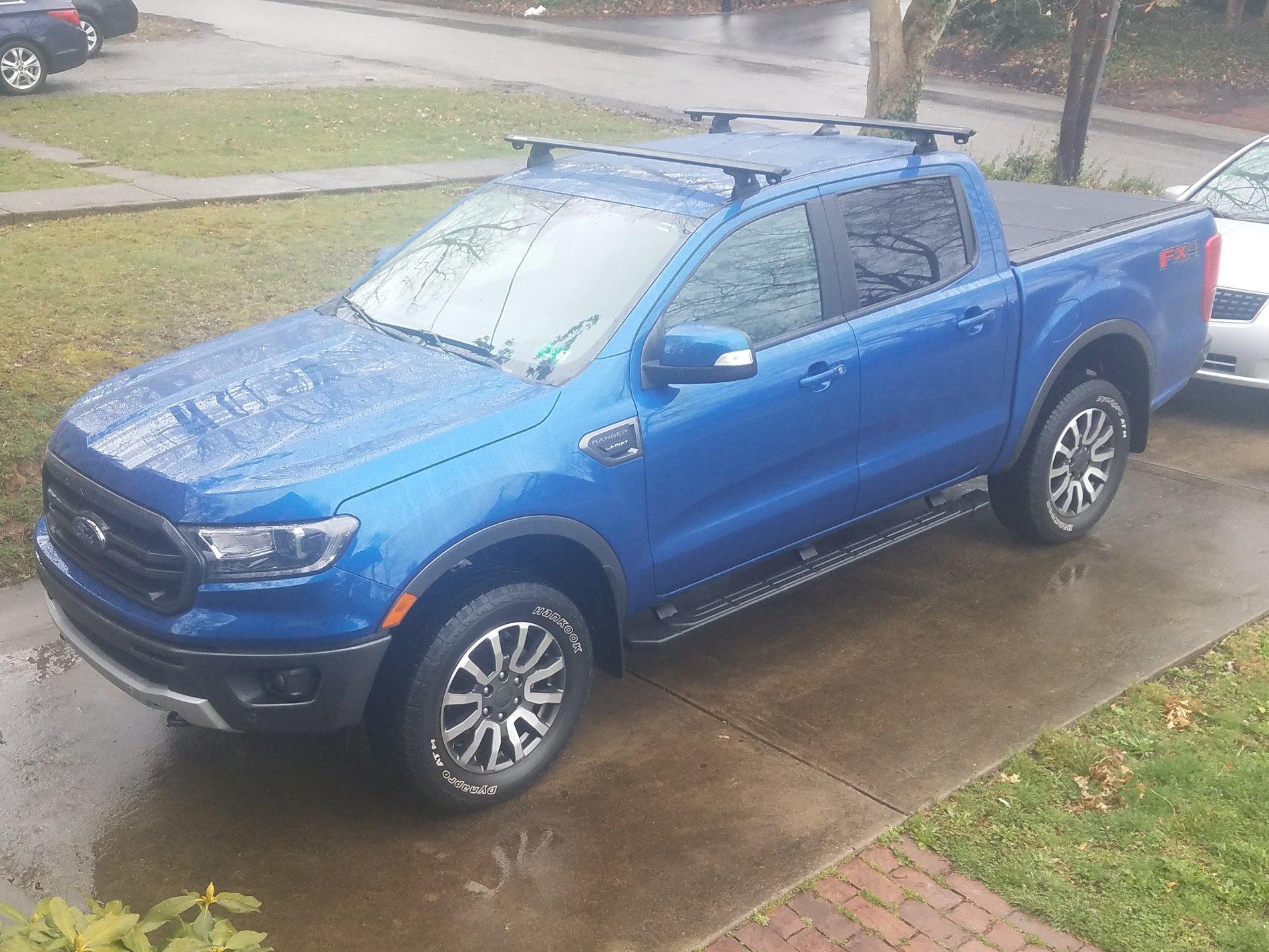

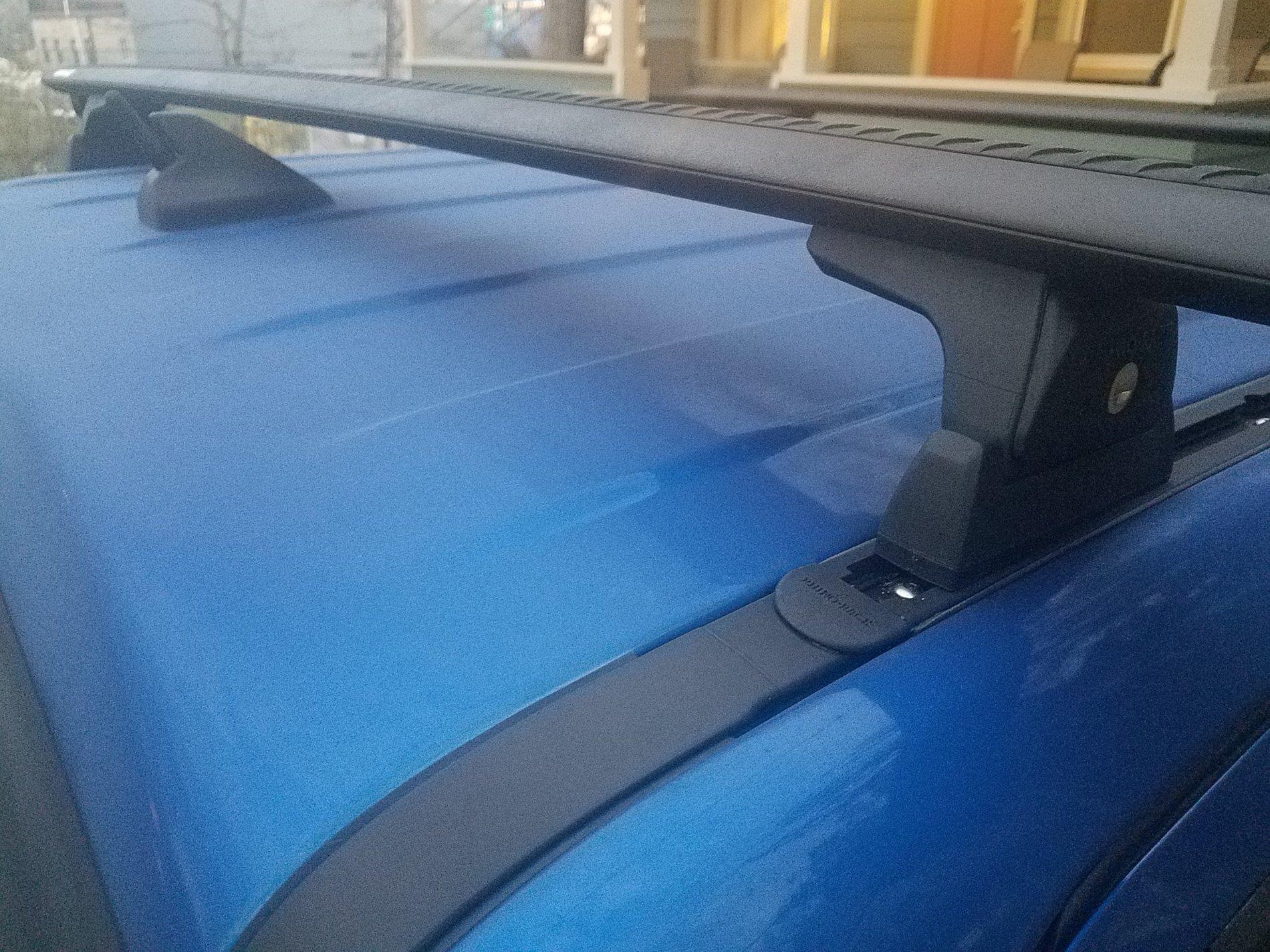

Finally got a chance to get these racks on.
These Rhino racks are very well designed. I used plusnut fasteners rather than the supplied poprivets. I really don't think the poprivets could tighten it down well enough since you are compressing some grey foam strips.
I had them substitute 59" bars in lieu of the standard 54" bars.
I can't lie. Drilling all those holes in the roof is always frightening. Oddly, one of the holes ruined a drill bit. Not sure if it was on a weld or what made that particular spot that hard.

Would you be able to post photos closer up to the roof... this has my attention now! LOOKS GREAT!!
