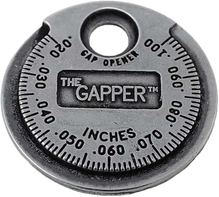

I just measured mine i ordered with the coin thingy. Two at .031 and the other two at .030

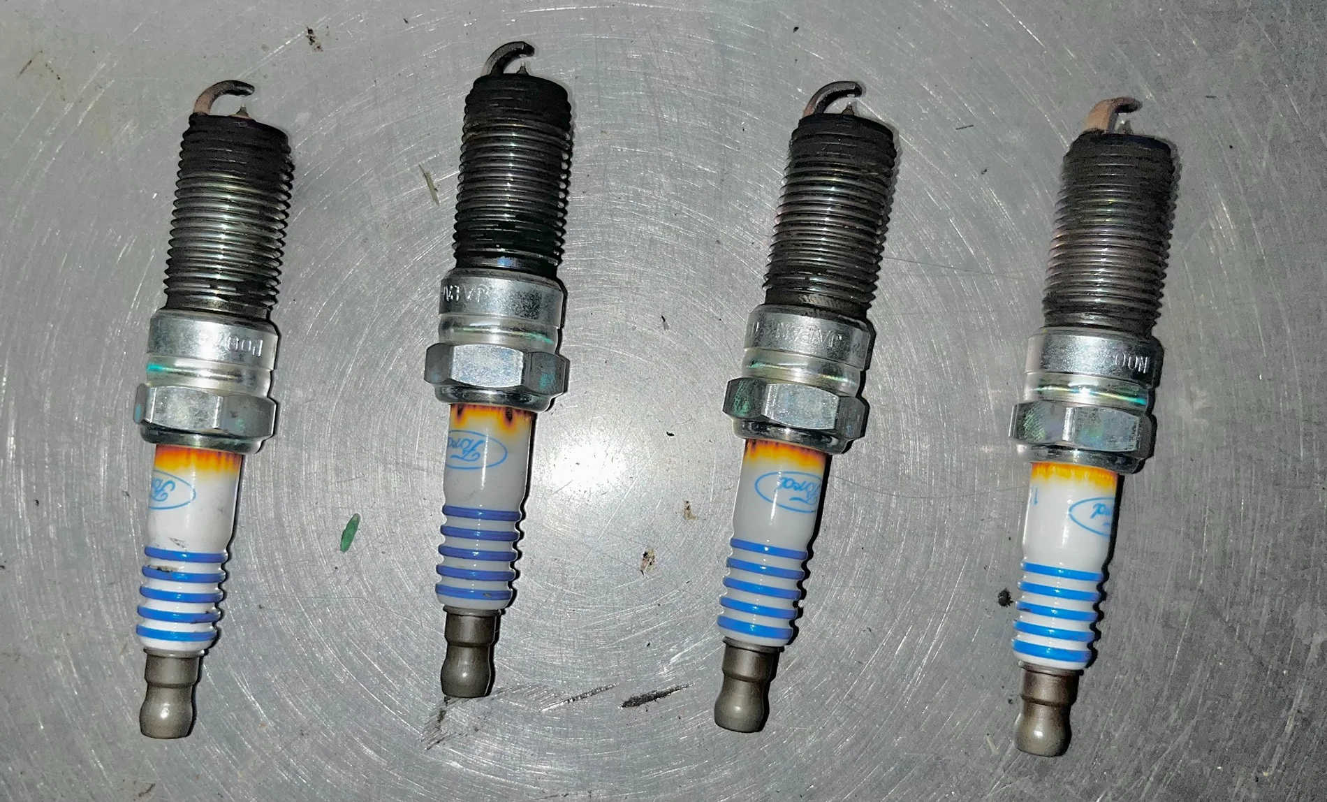

Installed mine as they were pre gapped. Install was straight forward.
Here are the oem ones with 55k miles.
1 through 4, left to right.
