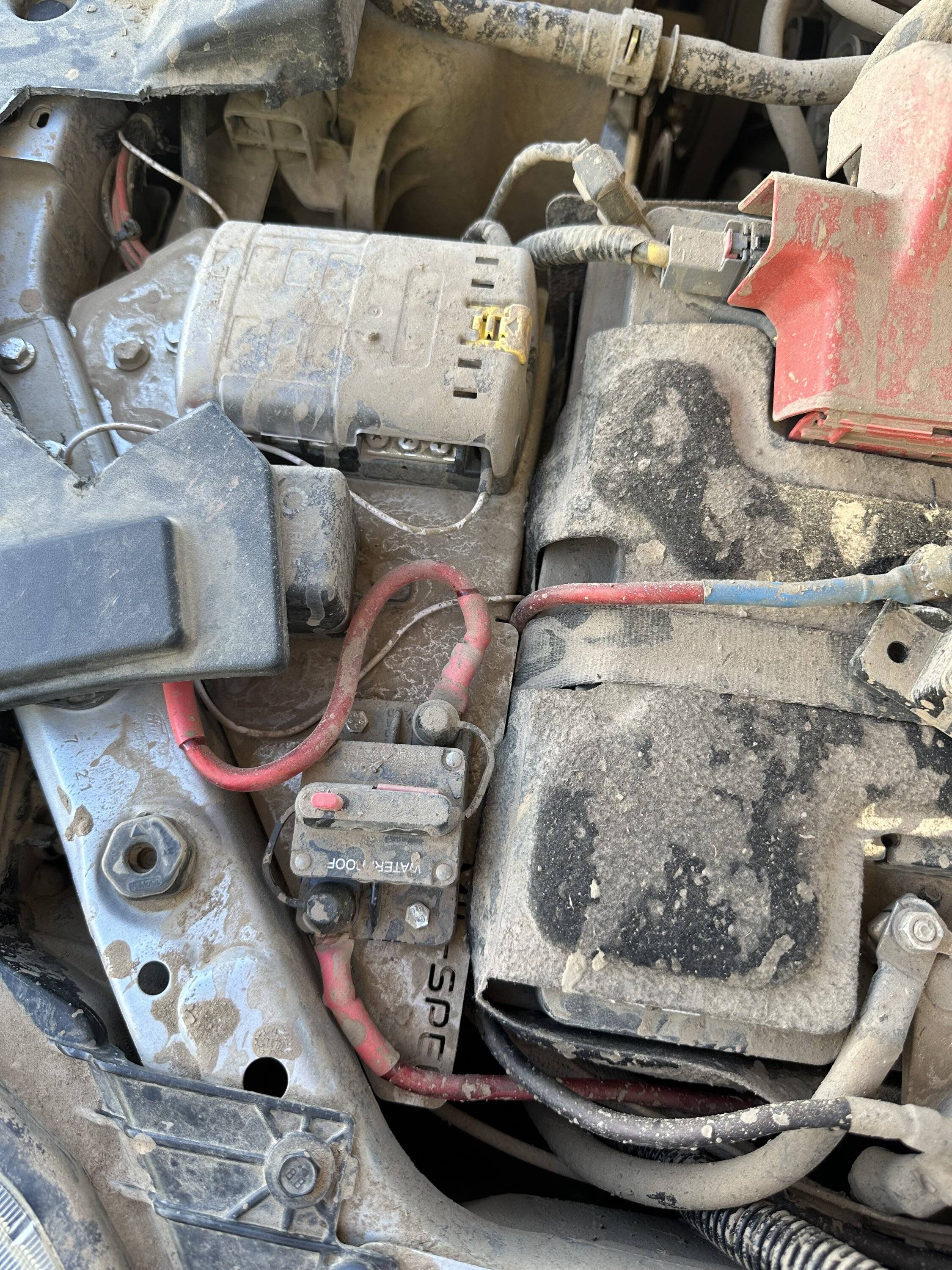

I don't need the winch part, but I could use a few connections. Front LED Bar Relay and I might put a quick connector to my portable ARB compressor and then for the Audio Upgrade eventually.
I hard wired a battery maintainer with a connector, but I'll leave that on the battery.

While that plate looks nifty, I say hold off til you have a cohesive plan or confirmed list of intended installs.
That's just a real pretty fuse block. You need a plan for how you will handle the relays that go along with this project.
Remember also.... a winch uses 2 gauge wire at least. Even with those midi terminals, the winch cable lugs may be too large.

the relays have a way to hang off the bottom, but I installed a plate at the firewall. Again, I’ll have to snag pictures later.
the winch should be run directly to the battery. A relay can run through the block.
OP- take your time and design your system. If you lack knowledge, start watching YouTube videos about custom fuse panels. I watched a ton of them, as well as videos on how a relay works. Now I’m confident in my wiring skills and that all my runs are safe and protected by fuses. Even redundancies.

I wired my rock lights directly to the battery, which has too many leads coming from it already from factory. I wanted a remotely mounted fuse block to run them from and have more terminals ready for future use.
My last rig, I wired the winch directly to the battery. I might just get the blank and hold off it.
