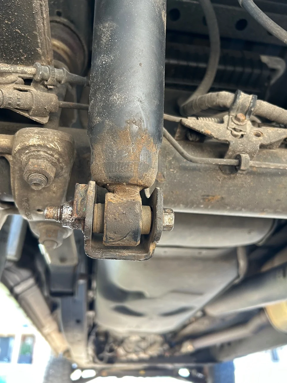

I am having the same issue and the only spot I’ve found loose is the drivers side rear shock absorber bottom bolt. This shock moves freely about a quarter inch left and right and also the top half sheath of the shock is smacking the interior portion of the shock making noise. This is supposed to be a bolt that simply unscrews and the nut should catch the box it’s installed within and not move…of course it’s spinning freely and they either loc-tite’d the heck out of it or it’s seized or something but I couldn’t get it unstuck with a wrench and impact…going at it again this weekend to try and get it tightened up. Check yours.

If I recall the nut is captive. Undo the bolt.
