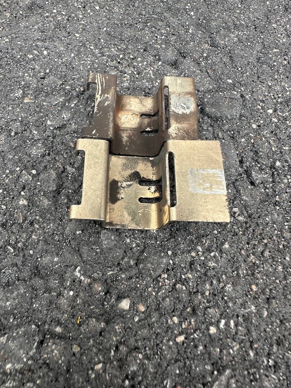

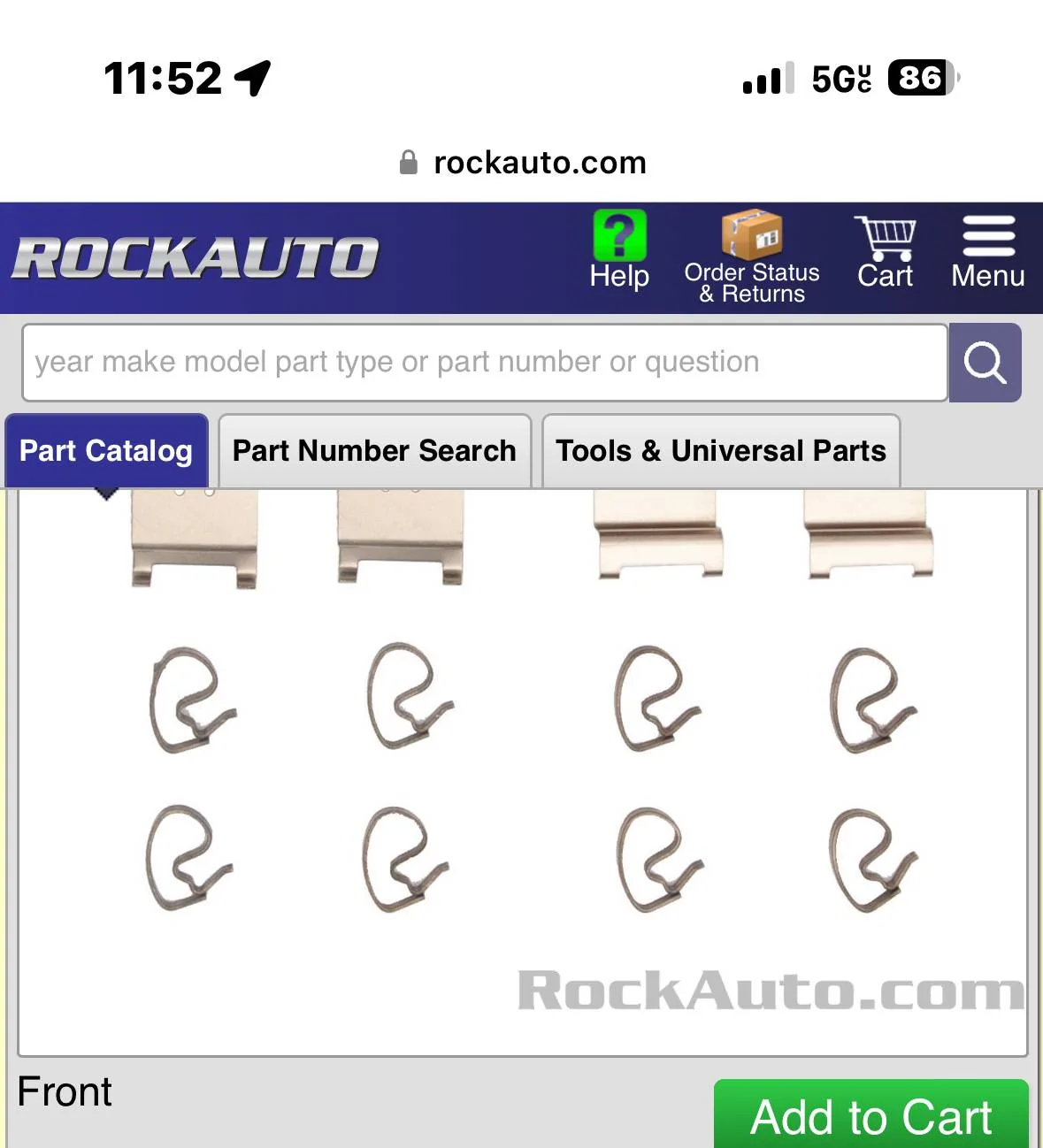

So hopefully this thread is seen by anyone who runs into this issue my problem was the clips i posted above, my kit did not include them front or rear and without them the pads have play in them im linking a great video explaining in depth brake job. Rookie mistake, the clips are ordered and will go on Friday night when they arrive I’ll update then thanks all
