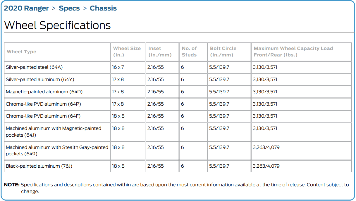

Hello All,
I'm trying to find the Stock rim load rating for the sport package rims, is this even important? I'm looking into rims and I'm seeing most of them are between 1800-2500+ lbs. From what I understand and, I can be totally wrong is the load rating is distributed to the 4 wheels plus the weight in the bed. For example the weight of the truck is over 4000lbs. So Im assuming 1000lbs go to each wheel (in a perfect world). I'm just trying to find out what the stock load rating is, just so I don't go below that.

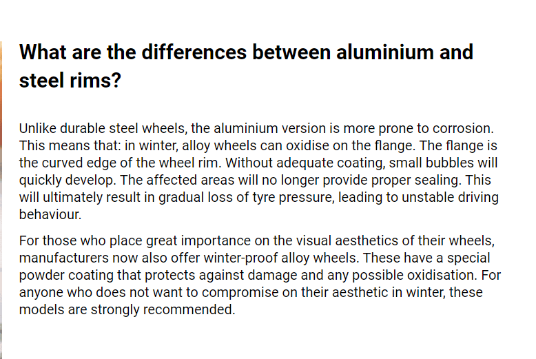

I guess my second questions, still relevant to rims is, whats a winter approved alloy and how is it different to a non winter approved? Is it more susceptible to cracking, or is a paint thing?

They are 17", I'm more looking to run them all year round, so really want to stick with alloys. Just not sure what this "winter approved" means

I bought a set of the inexpensive silver XL/XLT 17" wheels for winter, and they have no noticeable corrosion after one winter in the salt. About $110 each on eBay last time I looked.

I am looking for rather the same type of information. similar use, for a trailer. 15x7 aluminum wheels from a 92 ranger. they look exactly like the American racing ar62 wheels. How do we find or obtain this "maximum wheel capacity load" rating of an OE ford wheel when it is not stamped into the wheel itself like other manufacturers do?
