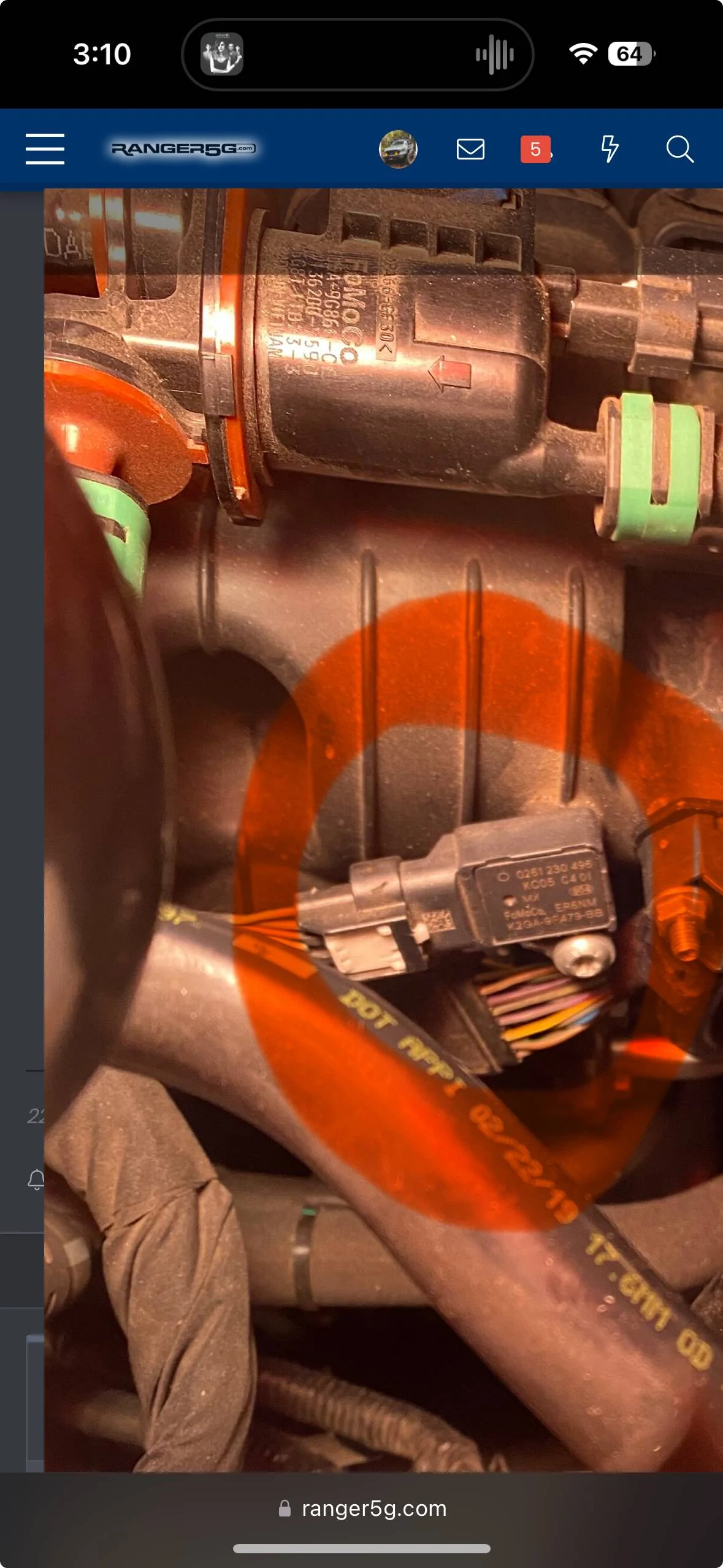

I’m getting a MAP sensor diagnostic code. I thought it was on the drivers side of the block. Can anyone confirm the location?
Im at work and I’m fighting the dealership
Parts dept.
airline tech
Aug 24, 2022
4,554
8,667
Midwest - KS
Aircraft Tech

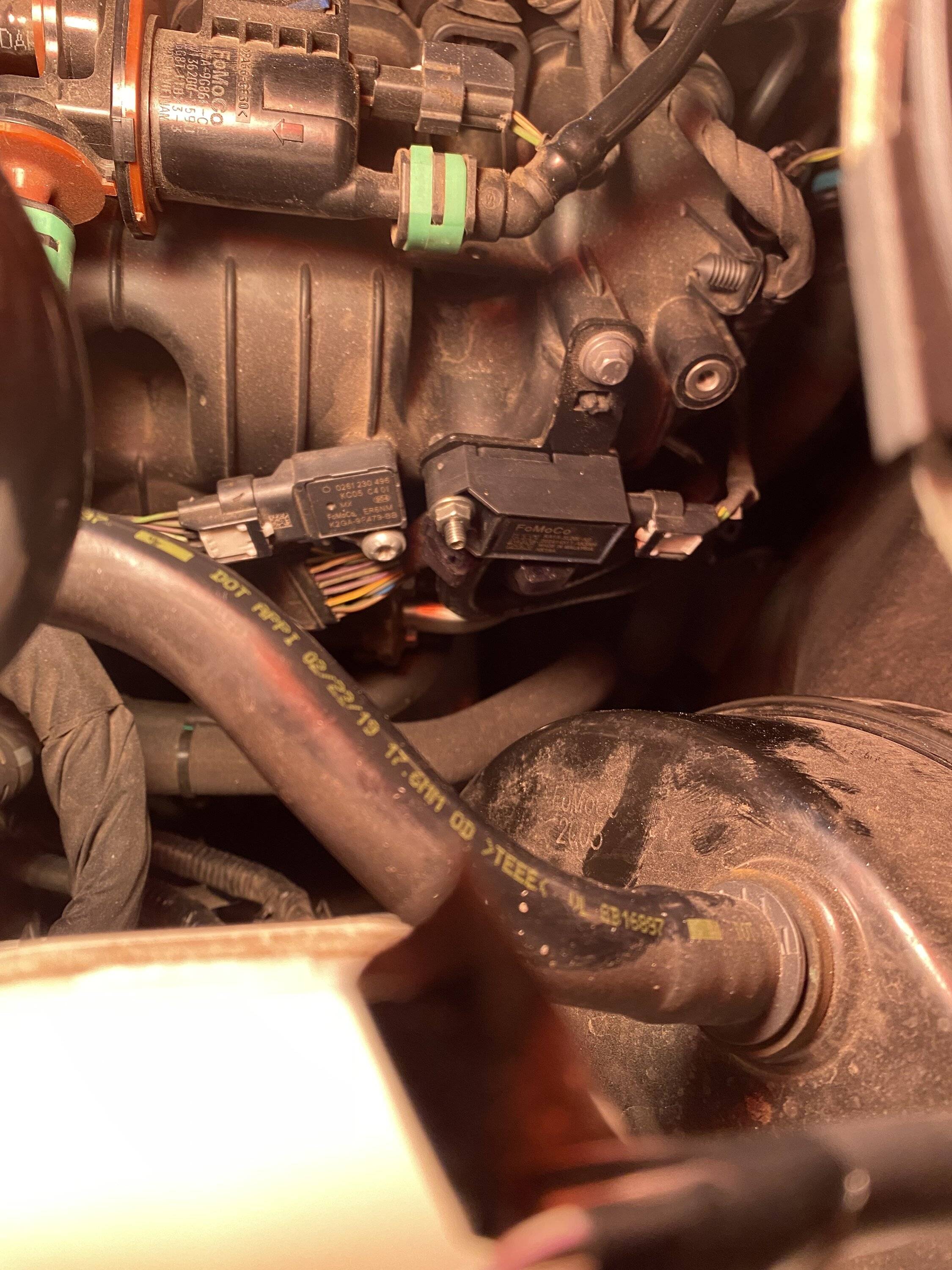

It is not called at MAP sensor on the Ranger it is called a MAPT sensor - FYI
The smaller sensor P/N - K2GZ9F479A
It is located right next to the DPFE sensor - Drivers Side, near the Brake Booster
