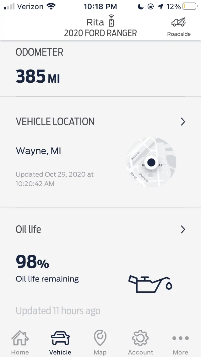

Recently purchased a new Ranger - when trying to use the car location feature on the app it says my car is still in Wayne, MI (not where it is located) and last updated in October.
Has anyone had this issue? Quick fix or will this require a trip to the dealer?

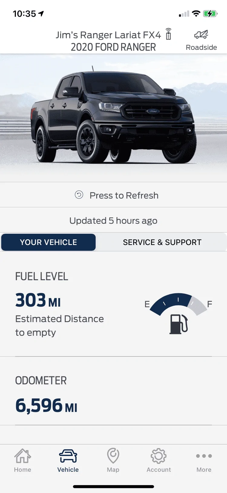

what happens when you push the refresh button under the picture of your Ranger?

Everything else seems to update fine when refreshed except for the location. I find it odd that it says it is still located at the assembly plant in Michigan...
