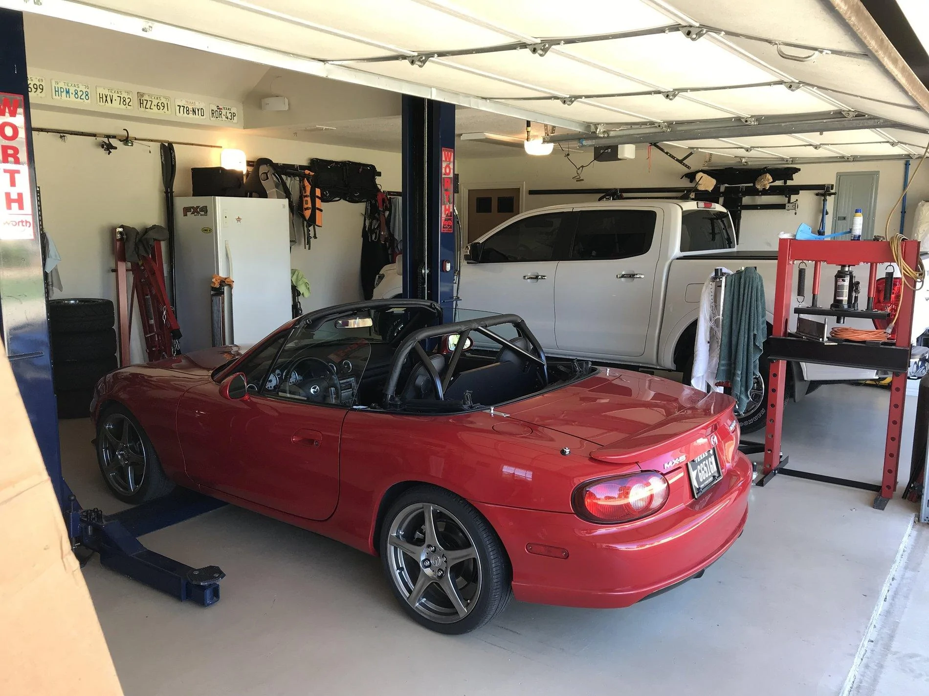

Just buy a nice MX5 and get all the shifting you desire and leave the truck alone.
Nice 94-96 NA Miata! Looks like you've added vent rings, white gauge plates, roll bar, low profile tires, and is that a trailer hitch peeking out from under the rear?. Are the wheels stock (I see the Mazda center cap on the wheels)? I think 15" was standard back then. I've got the 15" BBS wheels from the '95 M Edition on my '93 LE.
