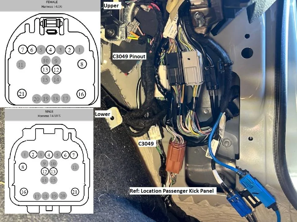

To fully T-Shoot this requires a scan tool that will show the following PIDs and wiring checks
SST - U , SST -D and TR Range Corrected
SST = Select Shift Transmission (Up / Down)
So the issue can be in the Shifter - TR Range Sensor and or cable or in the (SST) switch circuit
Just below the shifter boot and (aft) is a small connector for the shifter knob - pull and reseat that connector, this feeds those switches plus below the shifter is the main connector for it, also try pull and reseat.
These are 2 quick possible solutions without digging into full T-Shoot.
You may also try, rocking the shifter back and forth while pushing the buttons to see if you get some kind of operation out of the switches.
And cycle the - Tow/Haul Switch
Another connector in the circuit that contains wiring for the (switches) is C3049 located here so another connector to try - Pull & Reseat if the shift knob and shifter connectors are no help.

Great info. Much appreciated. Tow/Haul functions normally and so does sport mode. I do have a temp version of Forscan so I'll look for those codes and will check the electrical connections. Would the "SST = Select Shift Transmission (Up / Down)" code mean the switch/knob assembly is the culprit?

The PID is the PCM (signal) of the switch input not a code, basically when you press the (Up or Down) switch - is the PCM seeing the switch inputs. Not sure if Forscan will have those PIDs.
