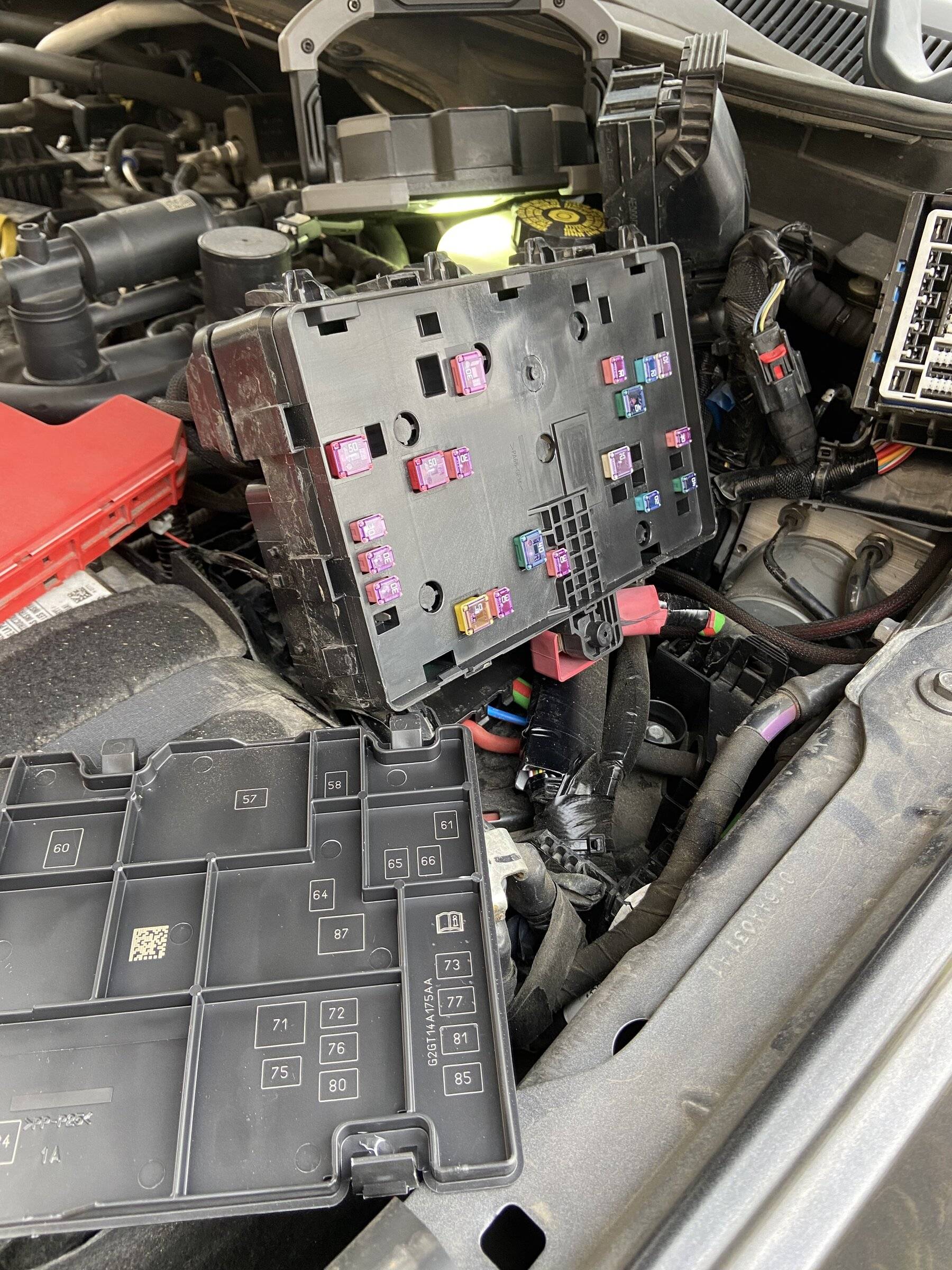

Anybody seen this issue? Fogs work, high beams work, but no low beam (or DTL). Bulbs are good and no voltage at light.

This was interesting. There is a hidden fuse box on the bottom side. Took me 10 minutes to find it. Fuses checked out.
