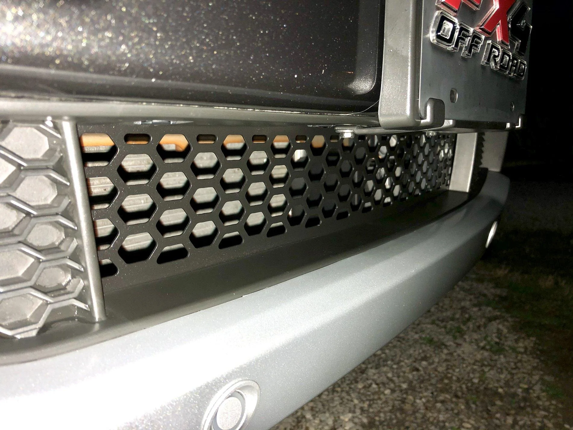

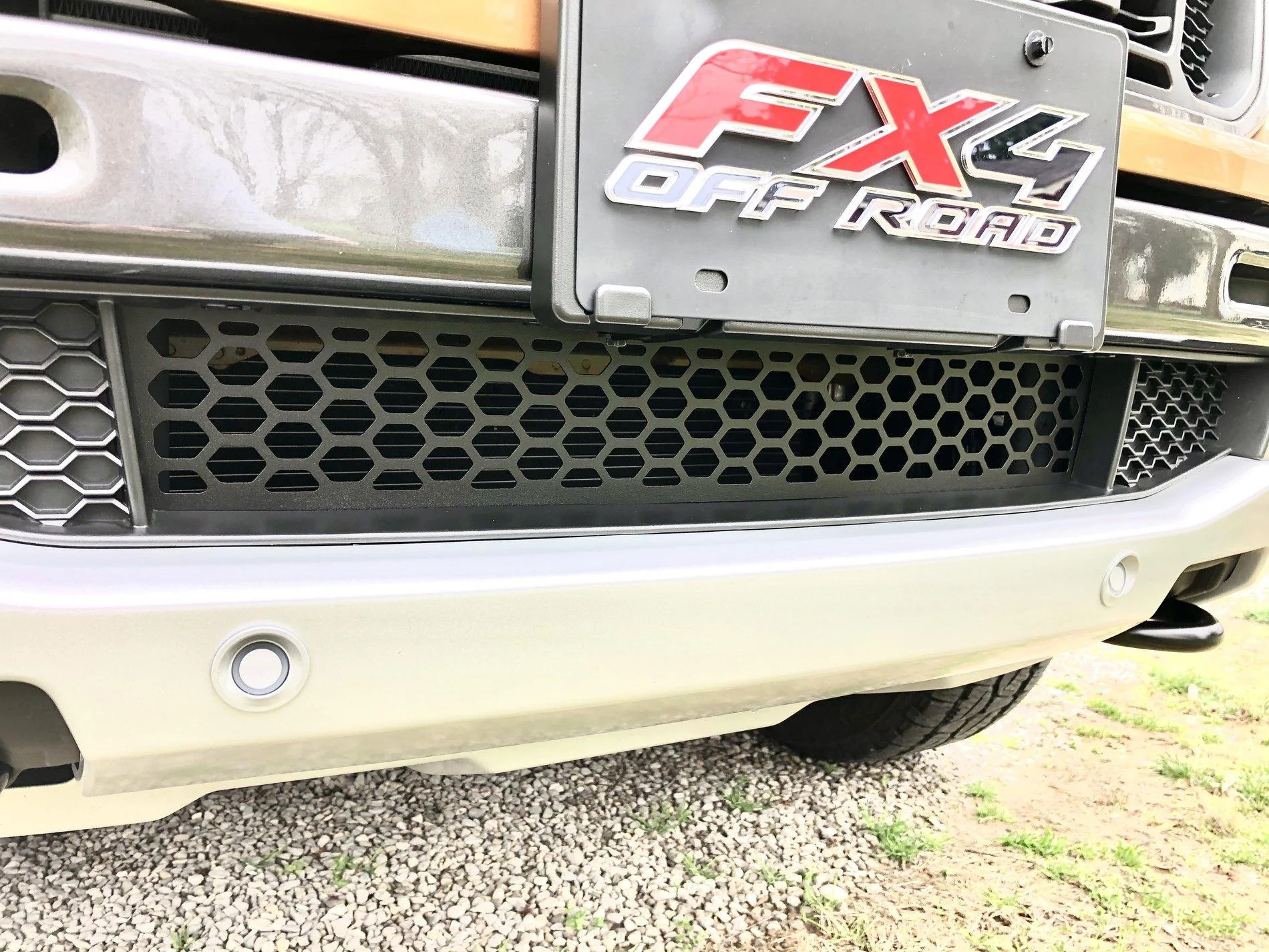

I installed mine this evening. Getting those metal clips to release was a pain. If they slide off the plastic tabs, reattach them before reassembly.

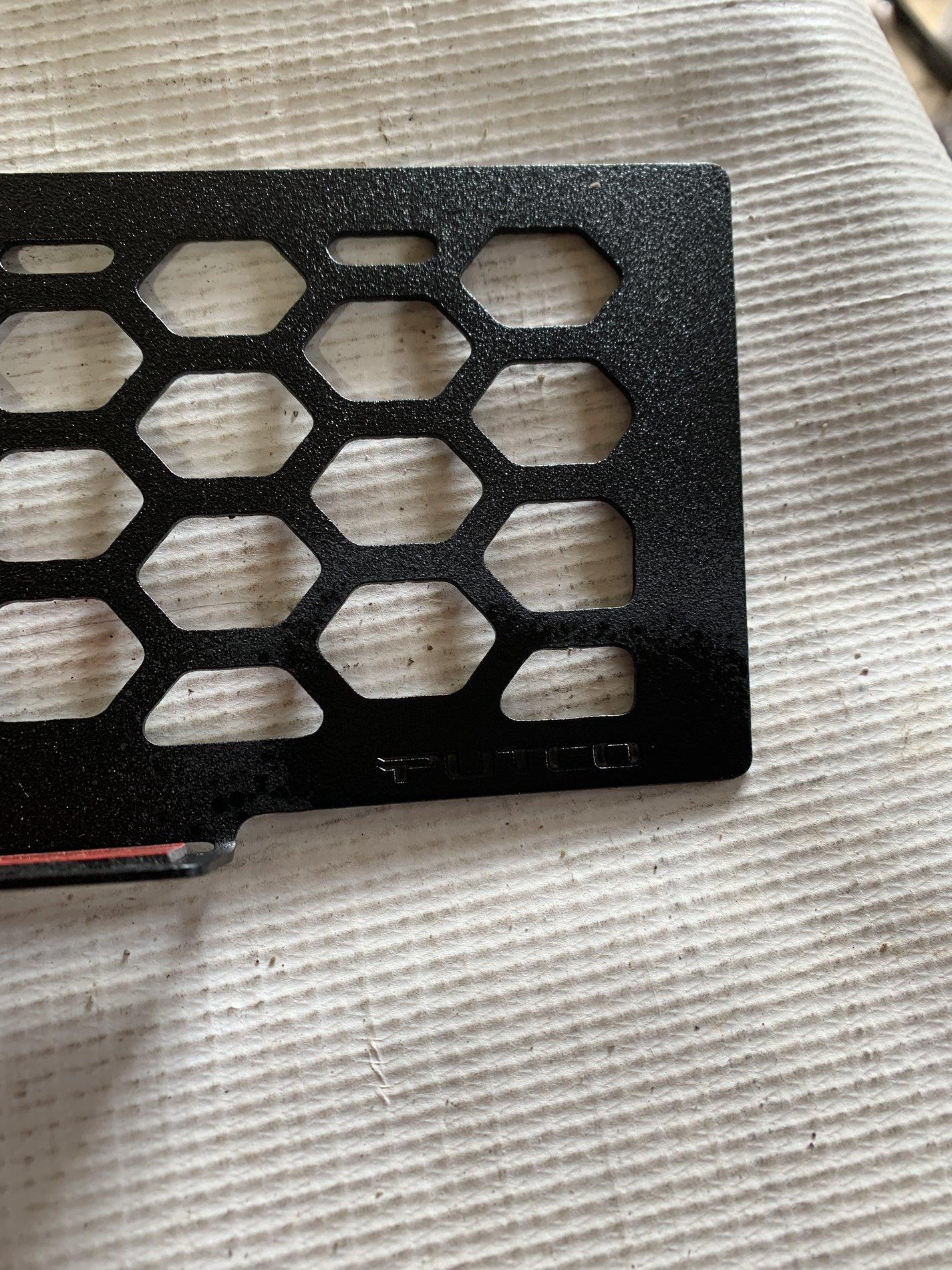

Glad I found this thread. None of my valence metal clips came out with the valence so that was rad.
My logo faced the engine, do no issue. Not sure if they messed up adding it.

Mine faced the engine as well, thought I was installing it wrong. As there is only one way to get it on, I felt better that I was somewhat sane, mostly, and they just have weak production standards... I hope.

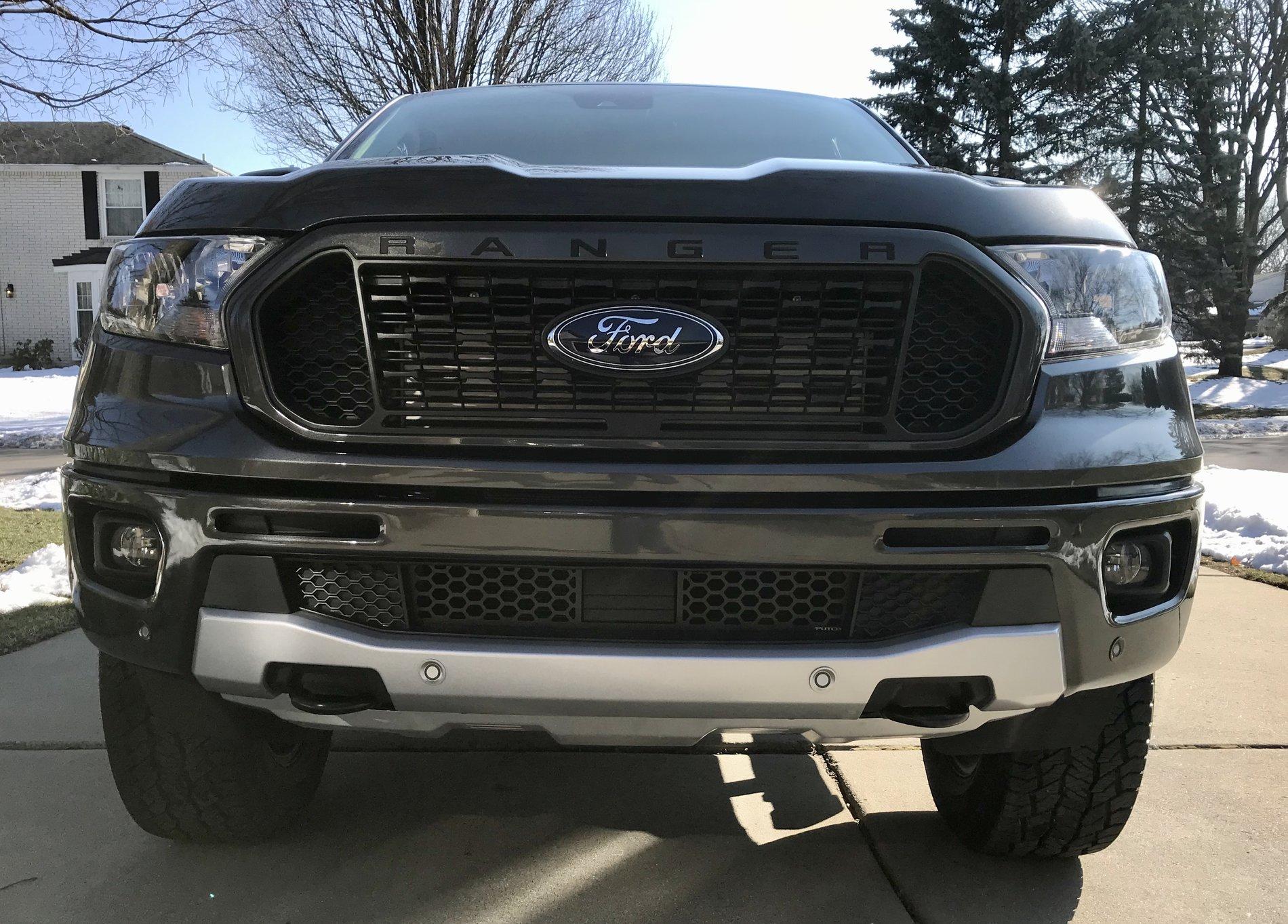

Tony beat me to it but I also did my install. Easy and yes about 30 minutes.
Be advised though.
This is designed to utilize the 2 bolts in the upper license plate mount for securing the grille. Some of us (like me in Michigan) do not have a front plate and because of that no bolts to secure it. I used zip ties as a temporary measure and will have to get 2 bolts to make it right. Stage3 and Putco need to know this and I’ll contact them.
All in all I like the look - it completes the front and now no big holes.

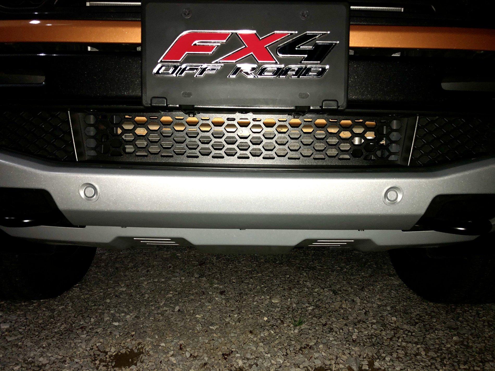

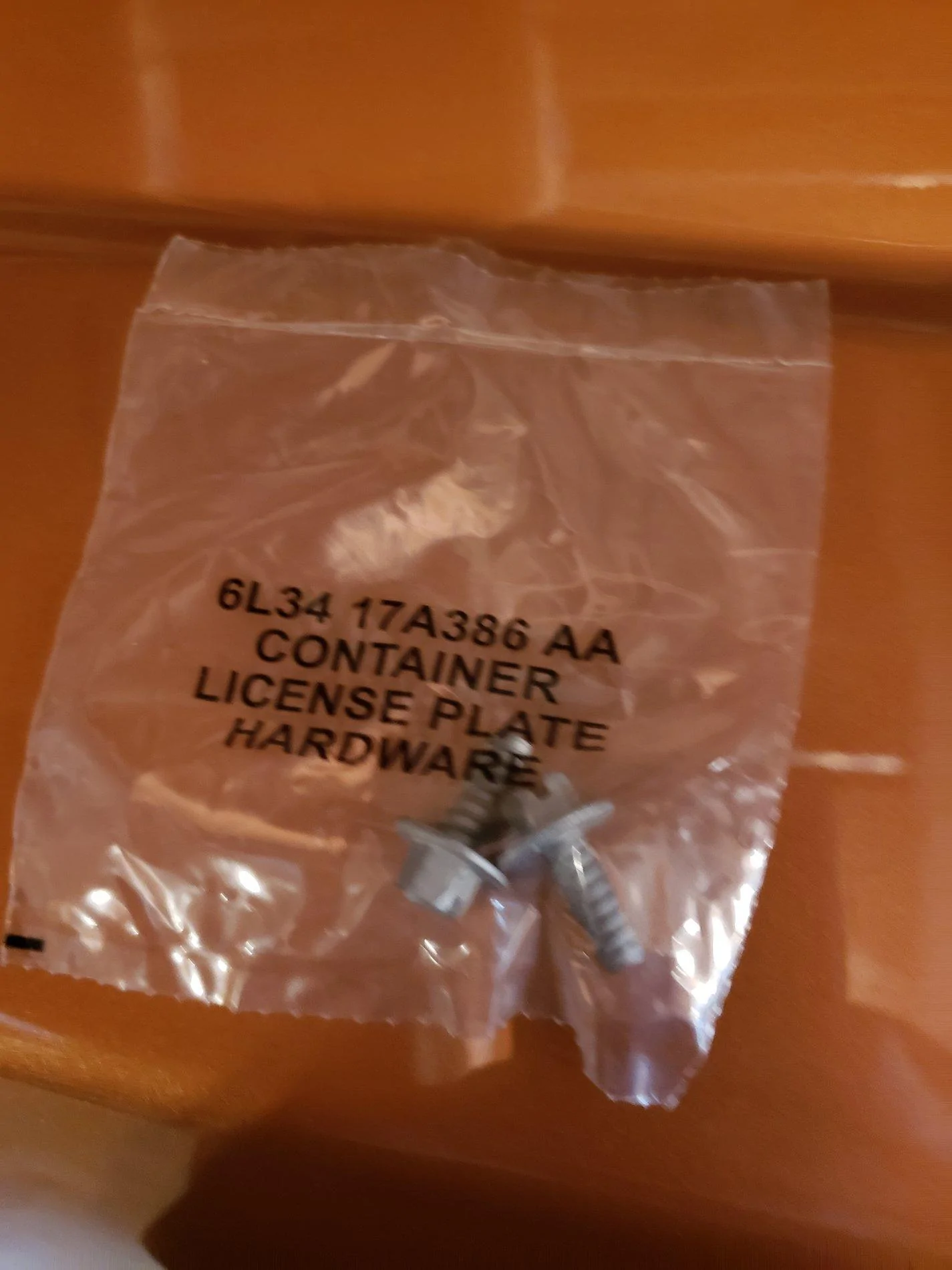

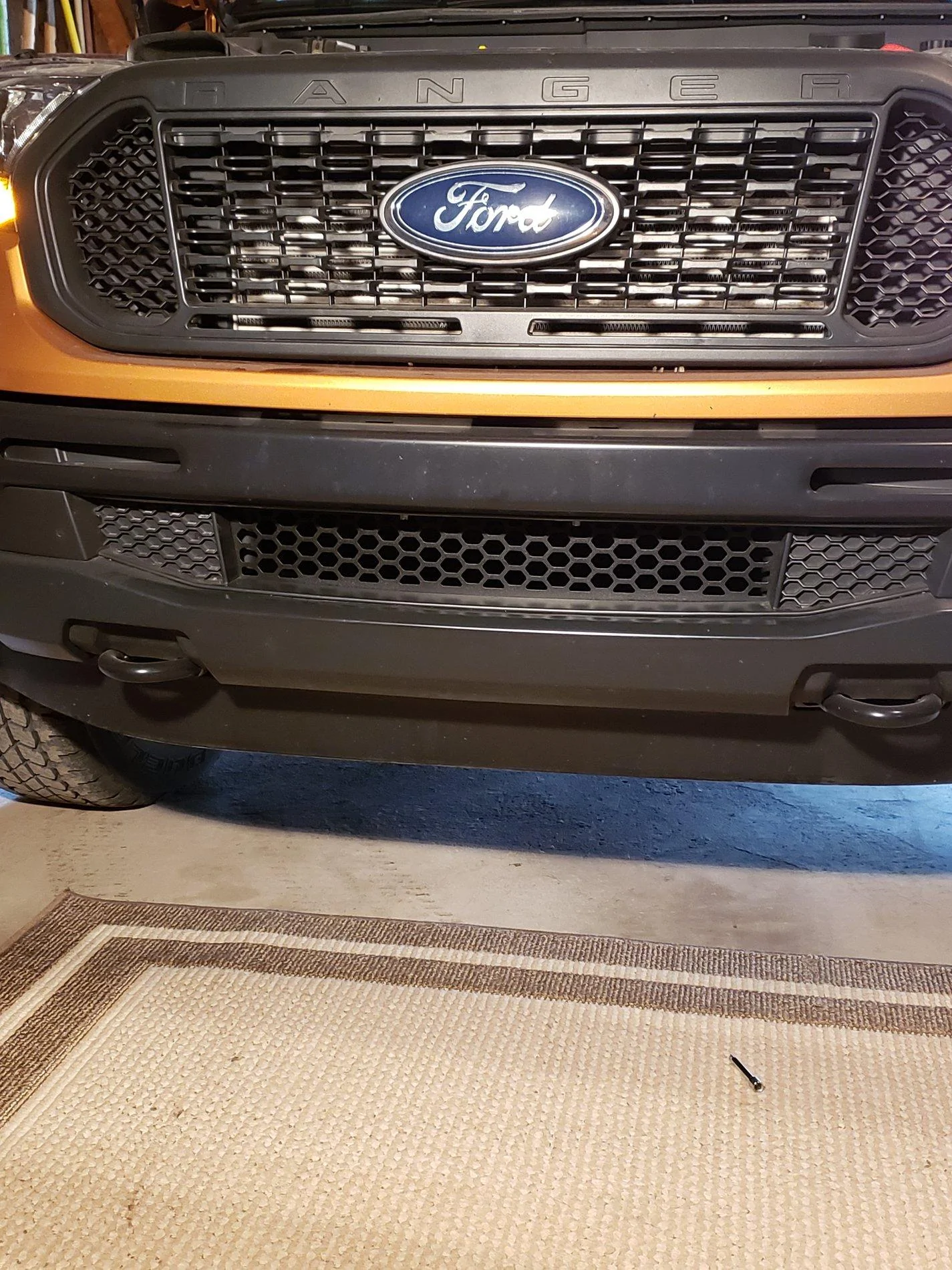

Installed my putco lower grill guard today.
I do not have a front plate, but the dealer had put the bracket bolts in the glove box. No clue where the 10mm comes from. Takes 6mm socket. See pic for part number
More important, install took less than 10 minutes. Not having the adaptive cruise, NOTHING has to be removed to install. Almost too easy to install.
