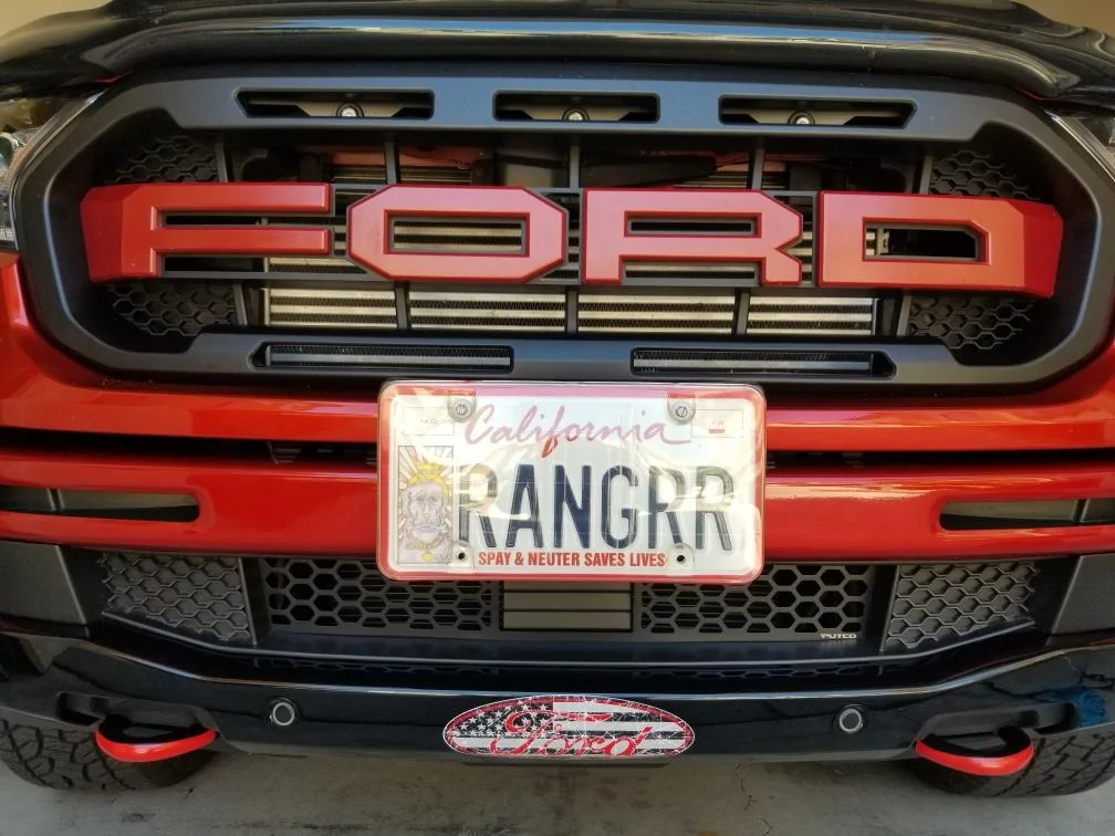

Installed he Putco “grill” a few weeks ago.
8,803
42,024
Here
XLT
1 . i ordered ABS plastic grill off Amazon, https://www.amazon.com/gp/product/B01BR0OEOE/ref=ppx_yo_dt_b_asin_title_o01_s00?ie=UTF8&psc=1, and
Plastruct A-8 Angle,1/4" (4), PLS90006 https://www.amazon.com/gp/product/B0006O09Z6/ref=ppx_yo_dt_b_asin_title_o00_s00?ie=UTF8&psc=1
2. I cut a template from cardboard to have the opening size and reduce the size by 1/16" top and bottom for the plastic angle. I then sanded to grill to precisely fit the opening.
3. Remove the license plate holder.
4. I removed the lower grill by taking off the skid plate (4) bolts; removed 10mm bolts holding the bottom of the lower grill; and the snaps holding the top of the lower grill. The clips hold the piece on and you can use a plastic trim removal tool to help get them to release. Disconnect the sensor connectors.
5. I glued the grill in place ensuring that the clip and license plate holder holes are not blocked.
6. I marked the placement of the clips before I installed the lower grill assembly so I would know where to apply pressure.
Everything works fine because it is plastic and not metal it does not interfere with the operation of the Adaptive Cruise Control.
That's a killer mod! It really looks like a factory feature. And that honeycomb grill insert material is hella cheap. Thanks for posting instructions.
Lots of owners are disappointed their grill inserts are so flat and this adds the 3D effect the Putco can't deliver. When my Raptor KO grill comes in, I'm going to modify my XLT grill to fit in the lower cavity. Yes, with the blue oval attached. The procedure will be similar to yours, I imagine. I don't have ACC, so I'm not worried about the badge blocking anything. I'll have to watch my temp levels closely but I don't tow anything. Fingers crossed. Pics will follow when it's done.
Nice job!

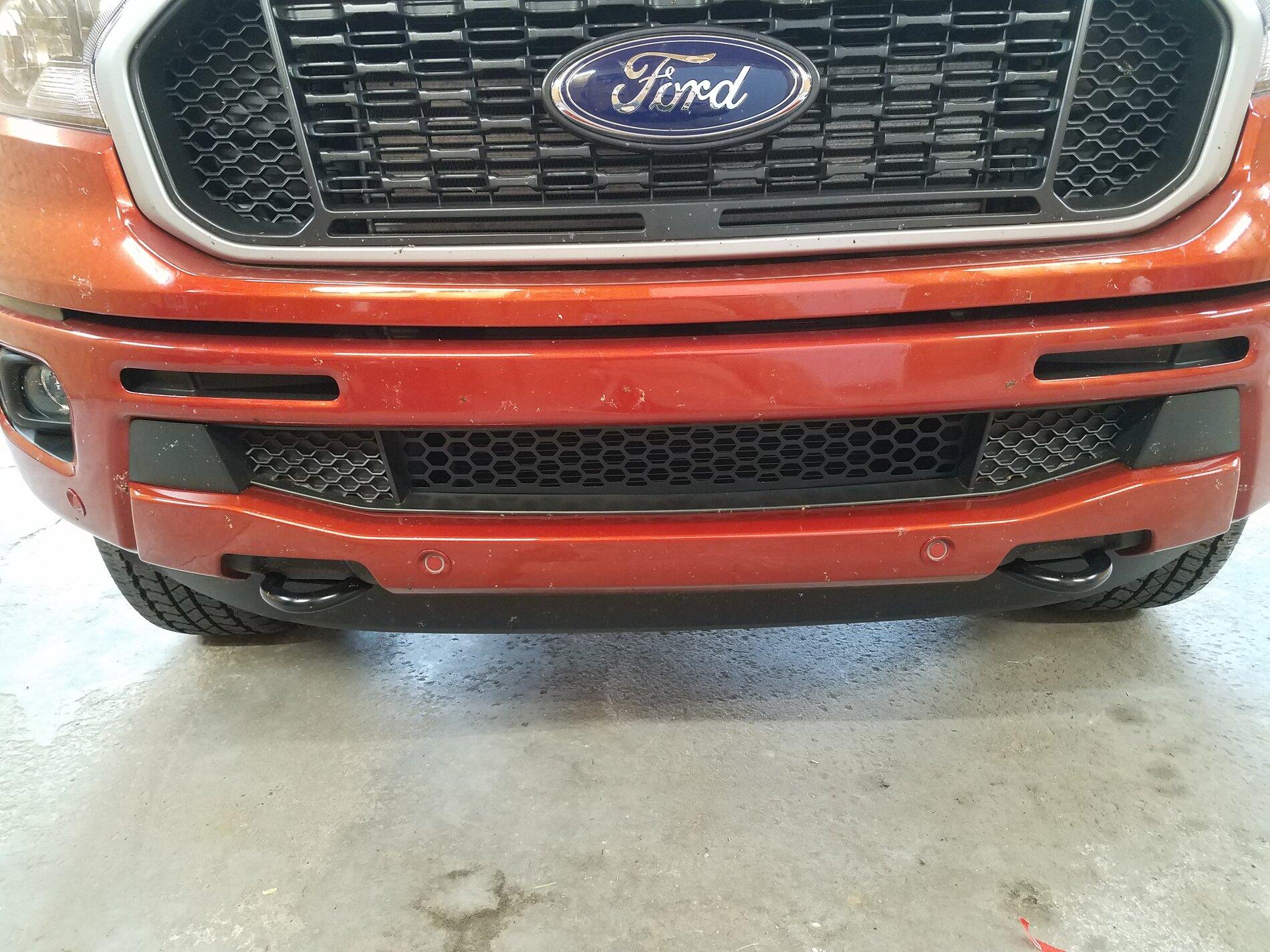

Well, I didn't go with an aftermarket insert...I decided to be a tight wad and make my own. Not too bad for $5. I'm pleased with it.
Nice!!! What kind of material did you use? Do you mind outline the basic steps for mod?

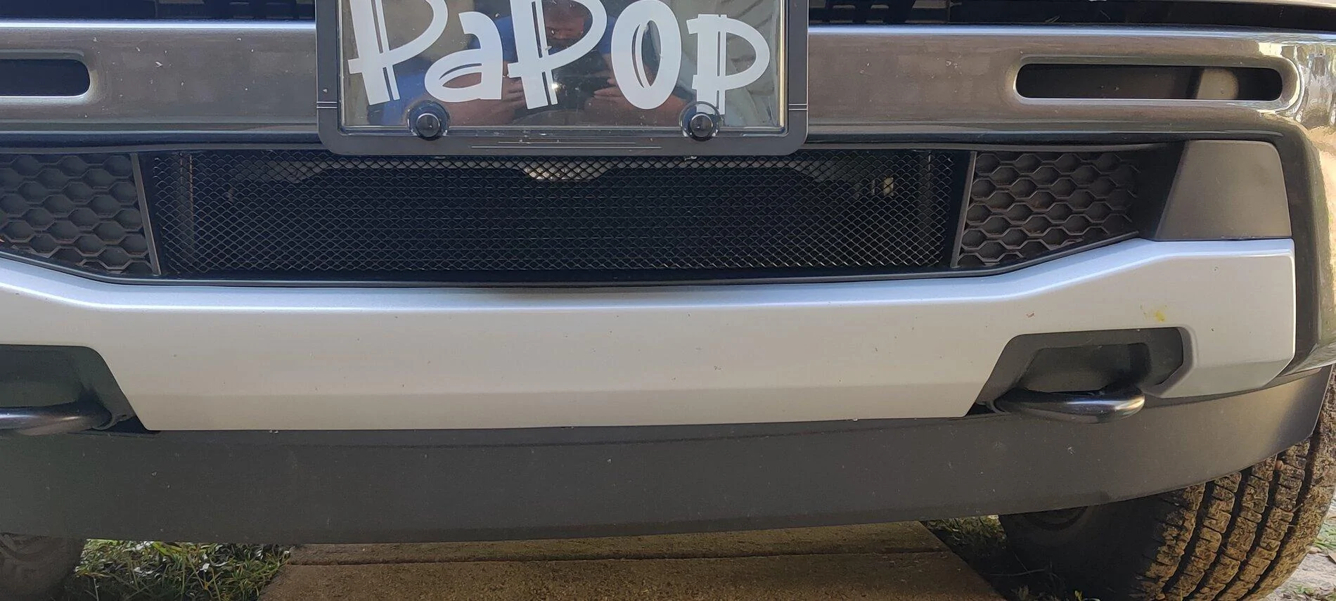

All I used was rain gutter guarding. I took a piece of cardboard, put it behind the opening, traced the shape, then cut the metal guarding 3/4" bigger than my trace. I bent the sides and top on a 90° inward, for screws to be hidden, then the bottom is actually bent to "clip" onto the lower part of the opening, in a "c" shape I guess you'd say. I was flying by the seat of my pants when I did it, and my profanity library ran out fairly quickly. I'll try to draw it out and post it.

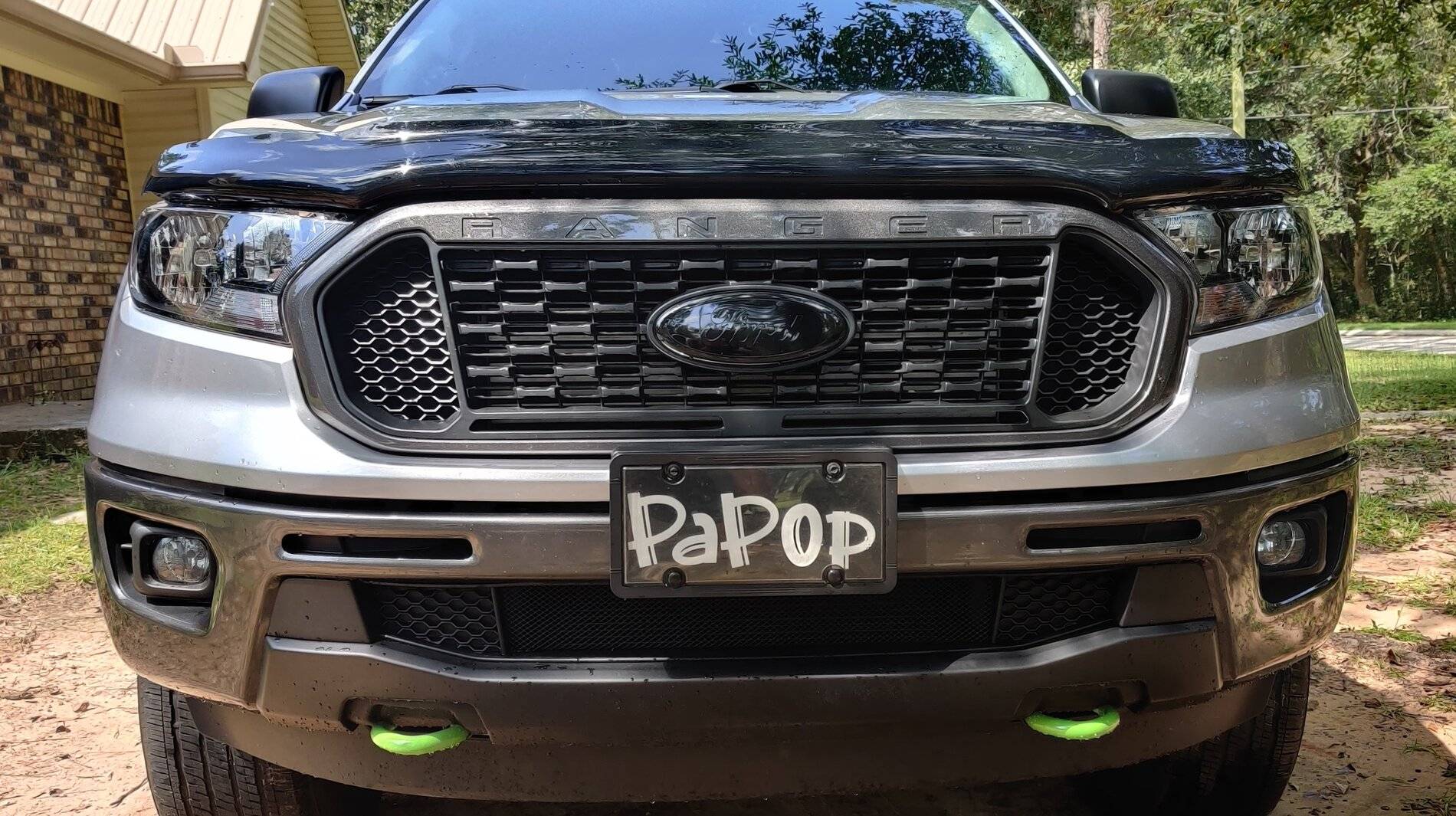

Honestly, it's rain gutter screen, cheap, but effective. As far as a basic steps...it's been more than a day since I've done it...CRS...Lol
Seriously though, I took the lower valance off, traced the shape onto a piece of cardboard, cut it out, taped the cardboard to the gutter screen, and cut it about an inch bigger all the way around. I bent the inch excess on a 90°, towards the inside of the valance, and used small self tapping screws in the left and right side. That's the simplicity of it. When I did it originally, my intention was to take pics of the process...we see how well that worked out.
Here's my original post, a little more detail
https://www.ranger5g.com/forum/threads/lower-grille-insert.5948/post-180912
It's still holding up perfectly! This was taken last weekend.
