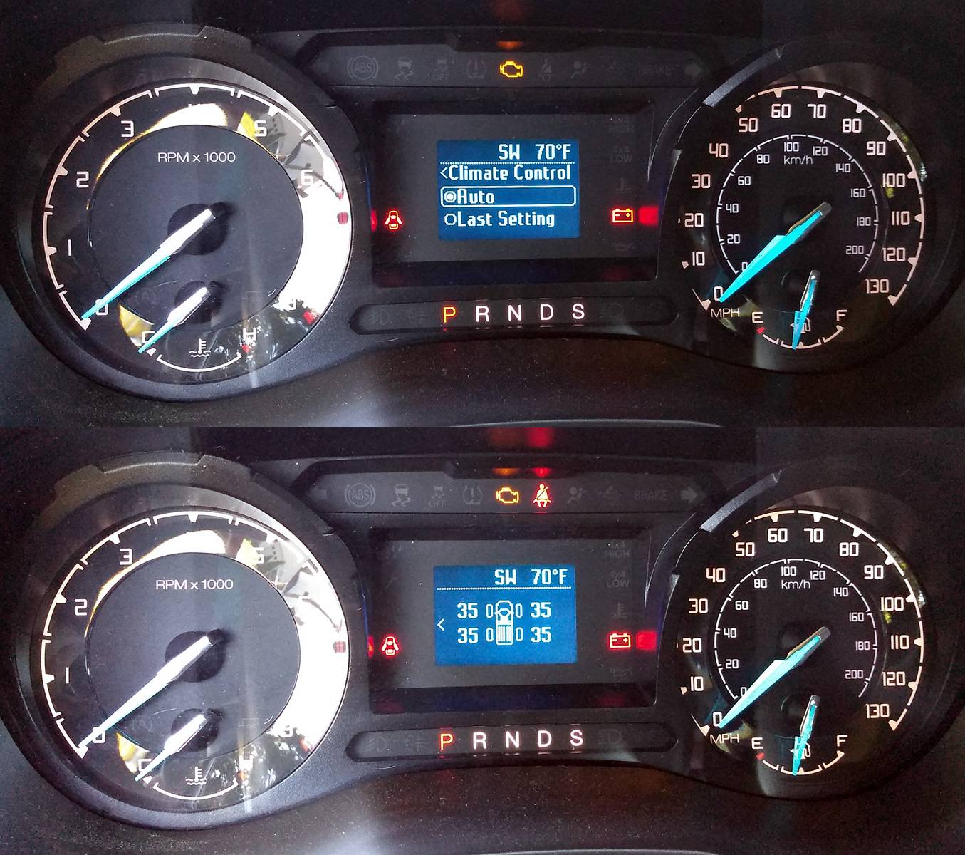

You don't have to do anything to the climate settings (before exiting) if using Ford pass to reportedly start. If you FP remote start and it’s hot outside, it will blast the ac; if it’s cold it will blast the heat.
Yep, you're right and I use both settings at different times.
So in Settings, select "use last setting" or whatever it's called. And when I do that here for hot days, I set the AC to Max and shut off the truck. I do this on days when I know I'll be outside most of the day (like working on the driveway, clearing brush, and those ever-so-glorious dump runs!).
Otherwise, I use the "automatic mode".
This works on the '22 XL with 101A via the Ford app, and I thought it was on all trucks, but it looks like some may not have it according to some posts on this forum. =/
I had to include the tire pressure one. I use a Milton stick to actually measure the tires but this is the first time the display actually was accurate.
