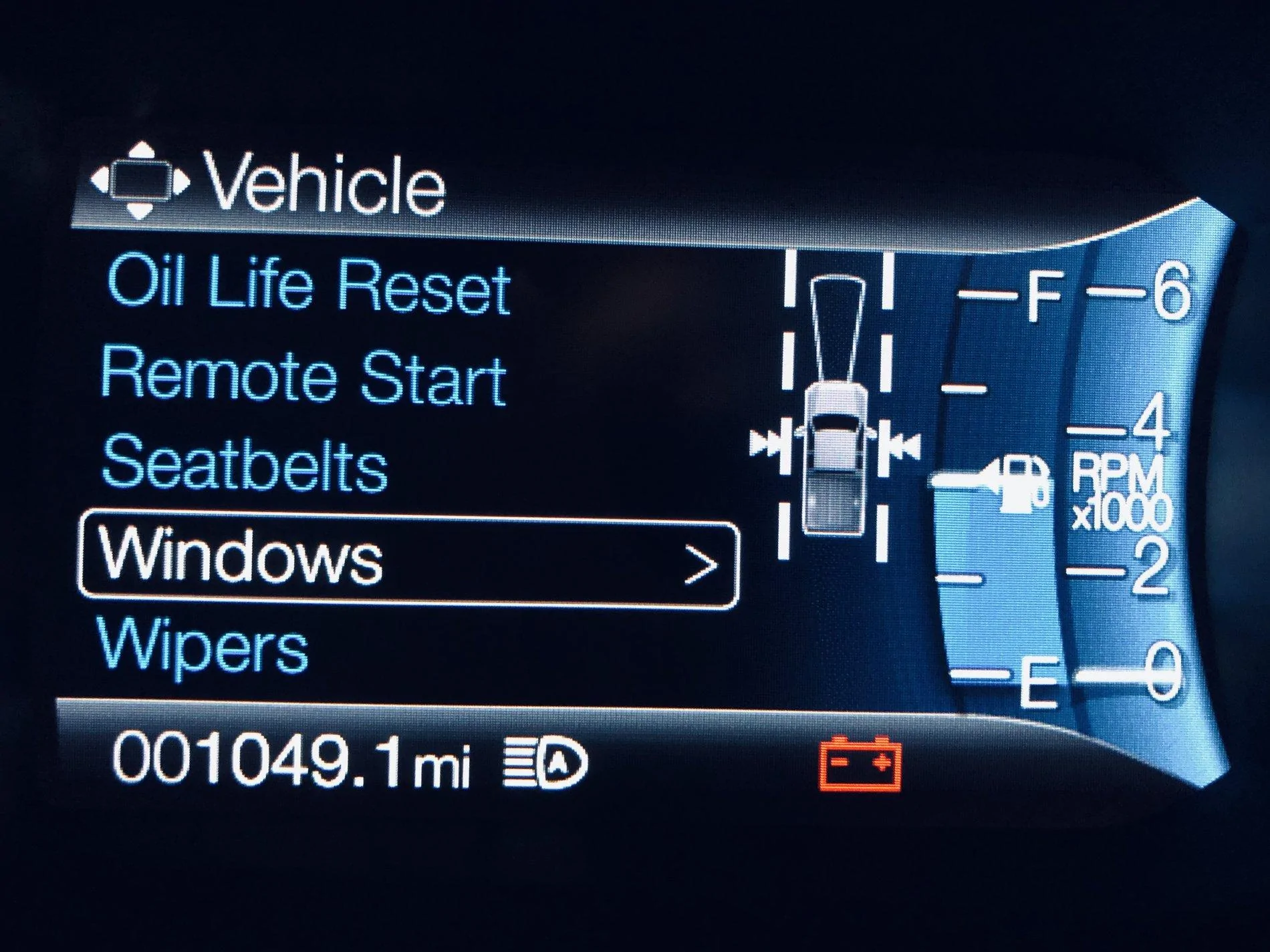

Do SuperCrew models have the Windows menu? According to our manuals it looks like it should be on all models but I’m not seeing it initially on my SuperCab Lariat and there is no text in the manual (page 90 or 94) saying it’s optional in any way.
It looks like to enable the option is
IPC 720-02-01
to show the option but it doesn’t seem to work.
Xxxx xxxx xxxx
for a US truck you either need a 3 or a 7 as the value for the first X.
Anyone have any idea if Ford just tried to short change us and not provide options they say are there in our manuals?
Maybe there are other switches needed. I’m still investigating but any help would be great. It’s possible we need another controller. If we do... which one maybe we can get it working.

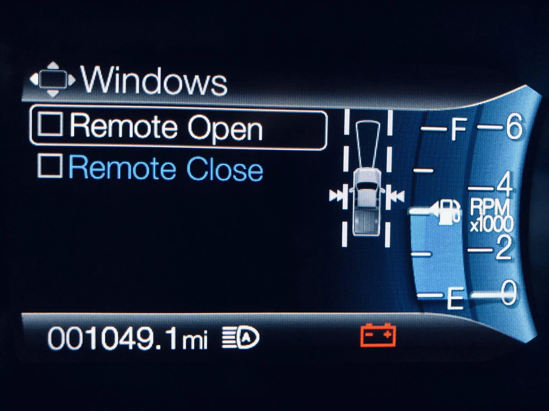

What does the option allow you to do?
I think allow you to toggle the ability to raise and lower the windows using the key fob.

So I think I have found more info. I haven't had a chance to investigate any of these settings. I've been looking at the Explorer Forscan list https://www.icloud.com/numbers/0AtiYU-yJ4Nrfyfuzp-Mi0l8A#FORScan_2011-2019_Explorers
Remote Global Windows **Roll up/down windows by holding keyfob lock/unlock
—Enables Global Close
BCM 726-17-01 x*x* x*x* x*zz 0=Disabled, 1=Enabled (change all *-ex. 0101 0101 01xx)
—Enables Global Open
BCM 726-17-02 x*x* x*x* x*zz 0=Disabled, 1=Enabled (change all *-ex. 0101 0101 01xx)
—Open/Close Master Enable
BCM 726-30-01 x*x* xxxx xxzz 0=Disabled, 1=Remote, 3=Key & Remote
—Driver Door Module Enable
DDM 740-05-01 *xxx zz 1=Disabled, 9=Open Enabled, D=Open+Close Enabled
—Passenger Door Module Enable
PDM 741-05-01 *xxx zz 1=Disabled, 9=Open Enabled, D=Open+Close Enabled
—'Windows' menu on IPC (for remote global open/close)
IPC 720-02-01 *xxx xxxx xxzz 4=Disabled, 6=Open Enabled, 7=Open+Close Enabled
BCM 726-04-01 xxxx x*x* 0=Disabled, 1=Remote, 3=Key & Remote

If I recall, we don't have a DDM or PDM module

No door modules. That's why were cannot do auto fold and reverse tilt. Auto folding can only be done with the plug on module I found.

No DDM or PDM yeah that makes sense. Anyone have an idea if the Explorer or F-150 modules might work. Or how make them work? The programming is there in the IPC and the BCM.

There's no way you can integrate them. You'd have to re-engineer the entire truck electronics.

The Switch cluster is also incompatible. The “Global Windows” function only works on vehicles that have the auto down feature available on all windows. Went through this on my Escape.
