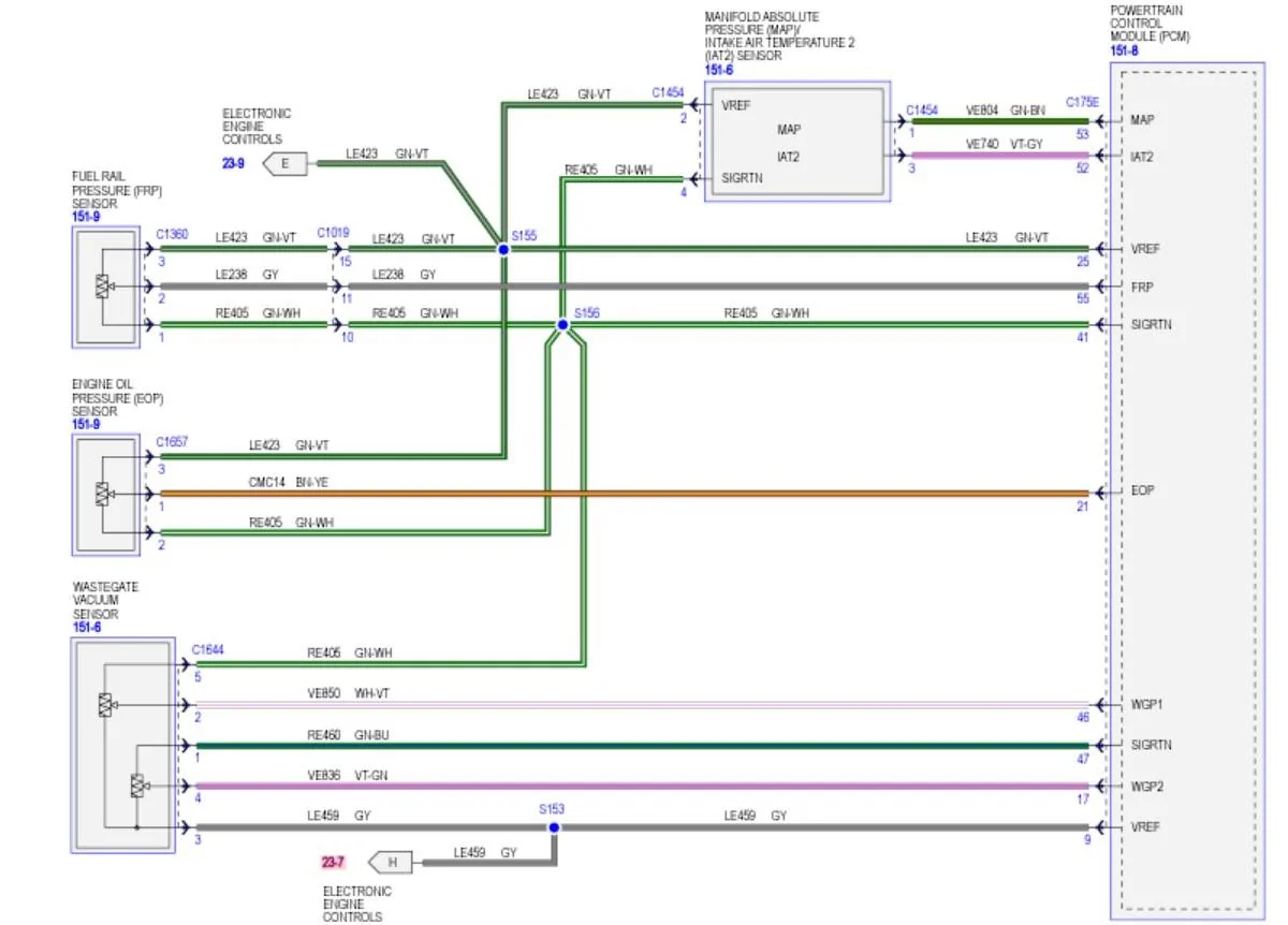

Well here I am over a year later. Fan clutch was replaced along with blown fuses and oil pressure sensor. Now I get just the low oil pressure indicator light and car eventually goes into limp mode, dealership had two master techs look it over and attempt to troubleshoot, called a Ford engineer and their solution is to replace the entire engine wiring harness which will NOT be covered under powertrain warranty and will cost me 2300 bucks with only 43k miles on this thing. I’m done with it after this, definitely trading it in somewhere.
Do you have any DTC codes for the low oil pressure? Here is the circuit for the oil pressure sensor wiring.

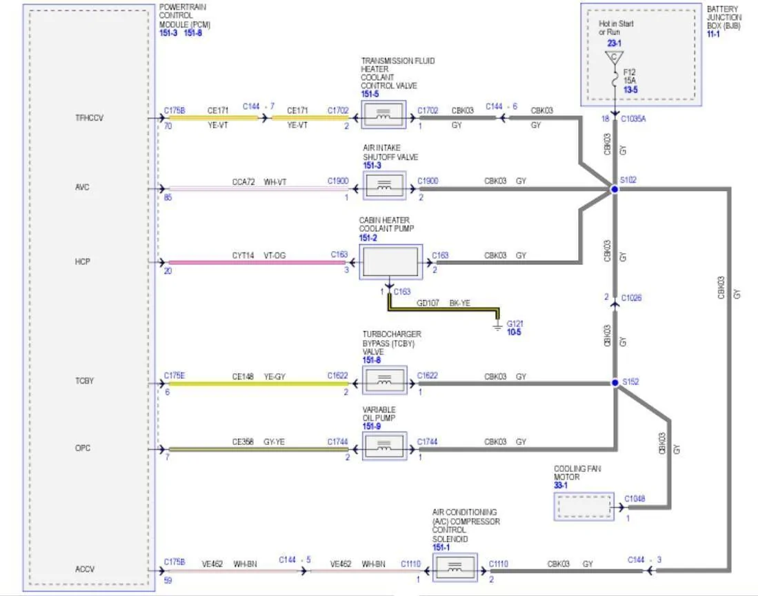

Here is the wiring for the variable engine oil pump control solenoid.

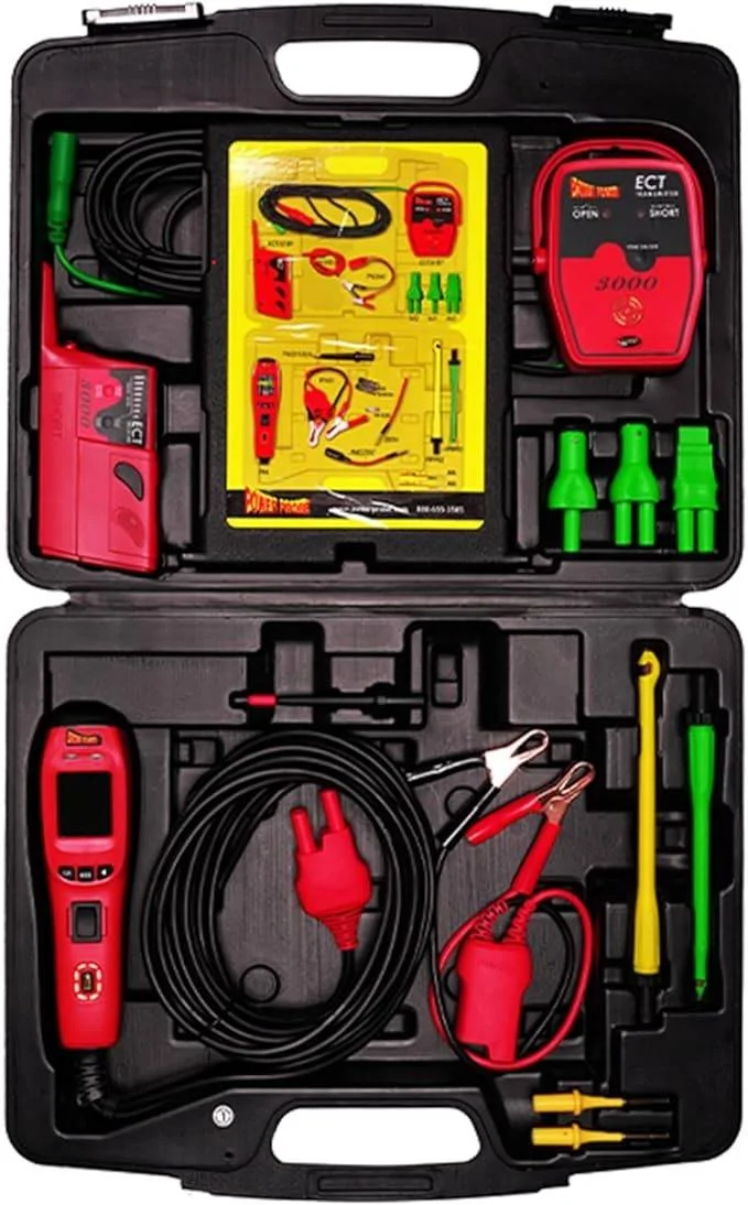

In either case I would break this out - I have this and its proven to be a great tool (expensive - kit) but it is a time saving tool.
I like this tool for the fact I can use it as a Tone Generator or Apply Voltage to a circuit and test for voltage drops along the harness run. it works great for issues like this

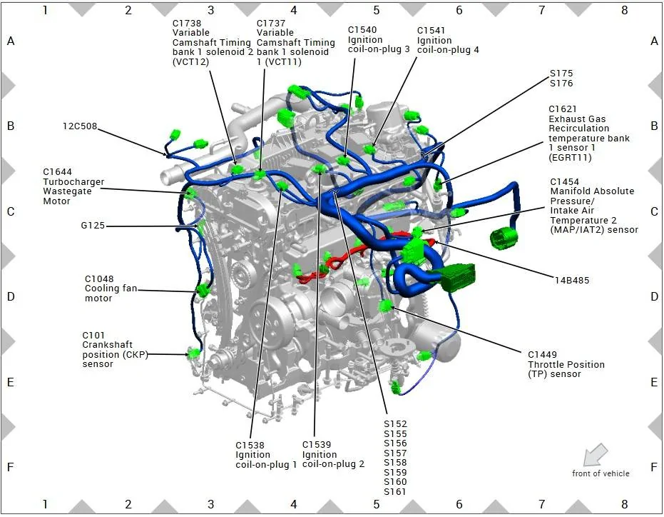

With the recent post (single code) Turbo By-Pass valve after Fan Clutch - Wire Damage.
I am even more certain that S152 is the (issue location)
It is HIGHLY LIKELY - that this Splice is burned and melted and is damaged just enough to drop power (voltage drop) the power feed to the Variable Oil Pump.
The issue is its buried in the harness - may take a bit of time to get the harness opened and locate it. (approx. 1 hour) for just a hunch (possibility) but way cheaper than a harness replacement.
My - Hunch lies at S152 as a HIGHLY Suspect failure point
A test would be - check for voltage at the (3-Connectors) that feed off of that splice.
Look for a Voltage Drop (I suspect the Var Oil Pump) will show under 12 Volts
