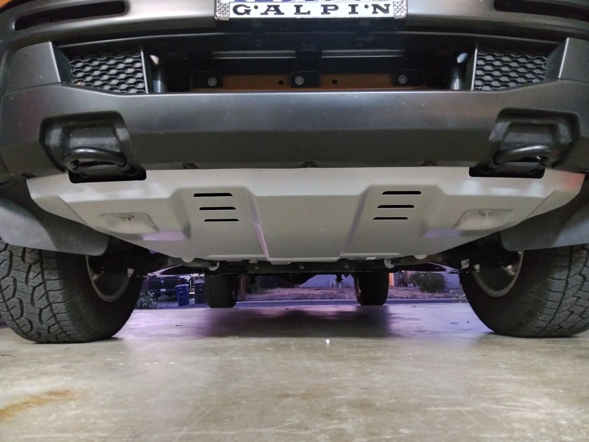

I've done the Swap, all you need besides the Skid and Trans plates with bolts are 2 Tow Hooks off of any 4x4 Ranger. They have the threaded Mounting point that the skid needs to bolt to in the front. The 2WD, even the FX2, does not have these mounting point. The FX2 i think was originally going to come with a full skid plate, as early pics show it with a full silver plate. Later Bean counters must of gotten to it, because that changed to a sad piece of plastic. I guarantee you it's gonna be a blast to thrash around on the dirt.
Incidentally, there are 2 Front skid plate available, a black one that doesn't have the front coverage and isn't all pretty- sub 100 bucks. Silver is around 300, a little less. Budget around 600 for new Ford parts. About 75? for each tow hook, less then 100 for the Trans plate- pretty small piece, and 280 or so for the silver Front plate, a must for any self respecting FX2 owner. I wonder sometime how these Scrooge bean counters sleep at night?
