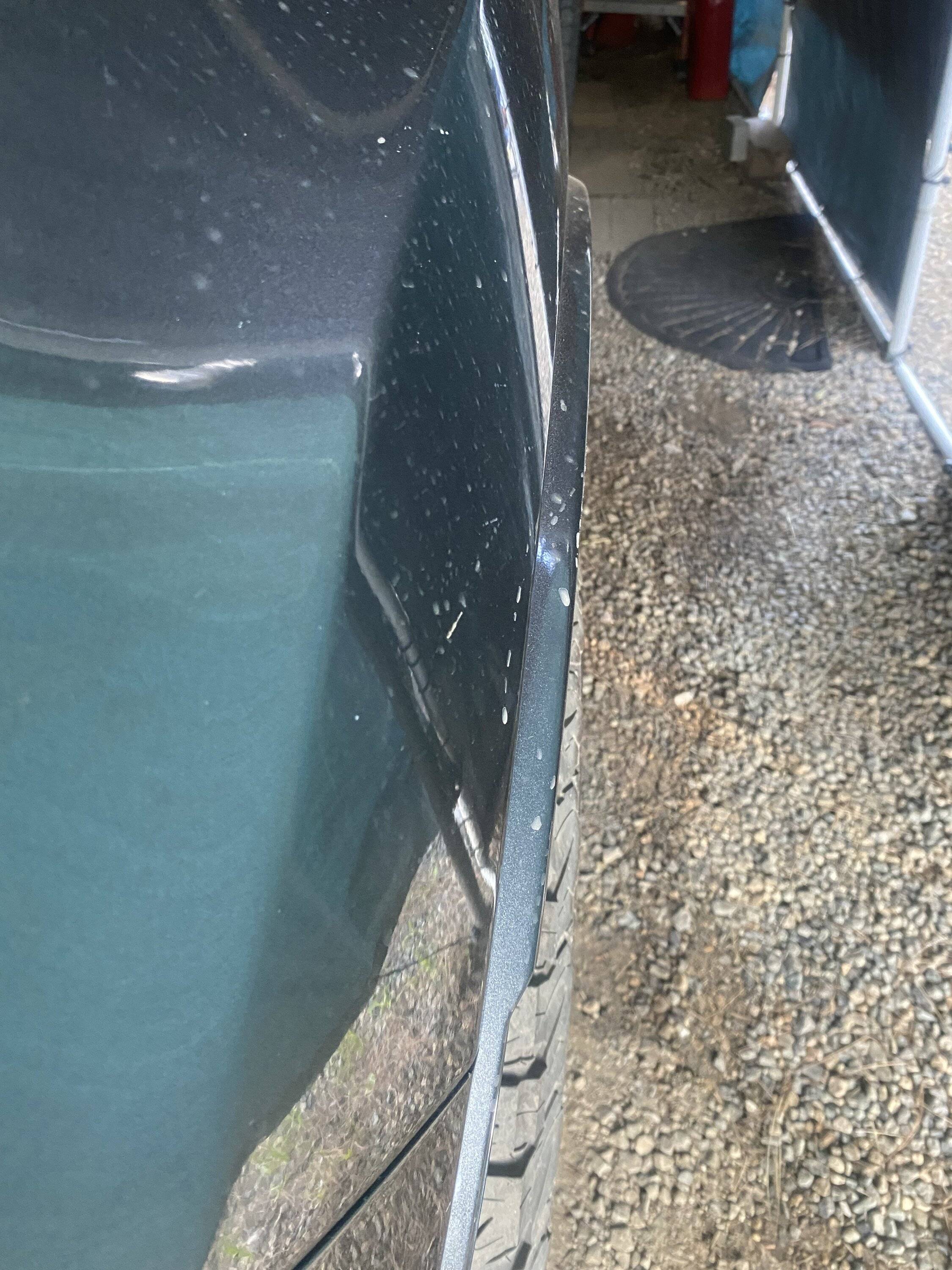

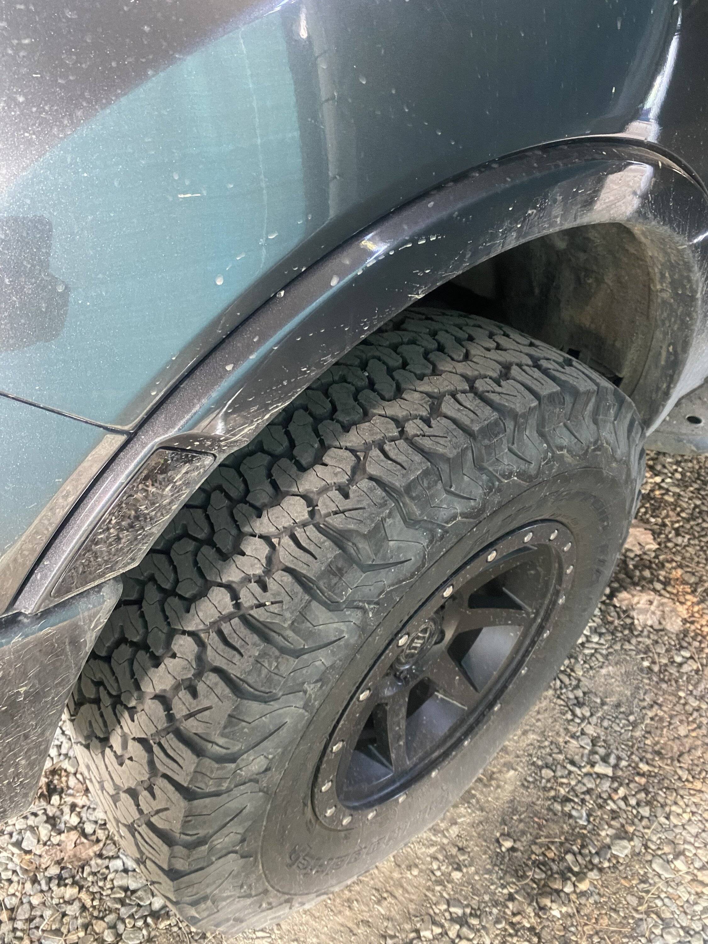

I had some Bushwacker fender flares on it for about 3 months. I was washing it and noticed they were damaging the paint where the rubber trim meets the fender. Also it was black underneath! Is there a better fender flare out there that won’t damage the paint? I’ve been looking at the RTR flares but don’t want to wast more money.

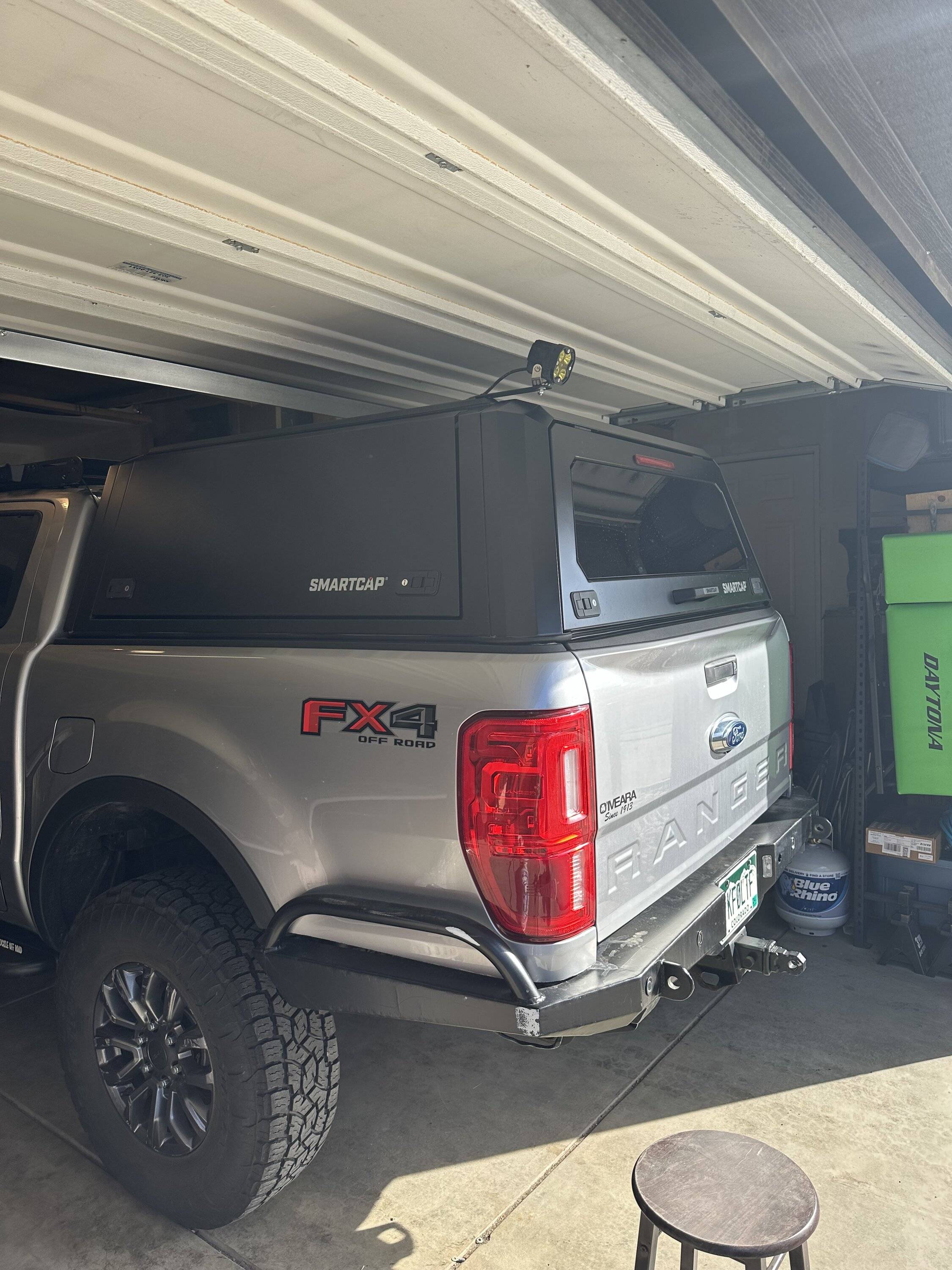

I am working through a chase light right now. Below is a picture and I hate how it looks so far.
I am thinking an SSC2 on the underside of that bracket would look less out of place.

For fender flares I went with Tremor flares for a stock look and they come painted carbonized grey.

I didn’t realize they were 10 ply until my buddy pointed it out after a few thousand miles! I have thought about the Tremor fender flares. They add an inch of flare. I loved the over size flares I had but they were hell on the paint
