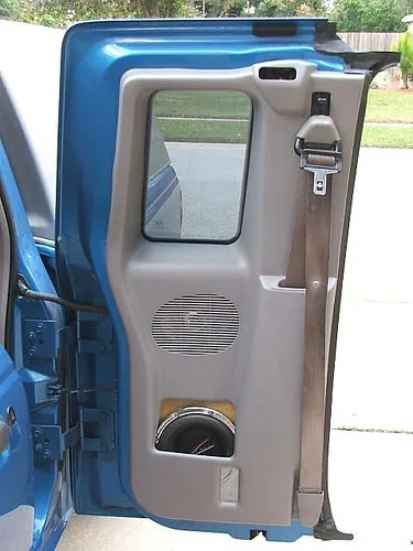

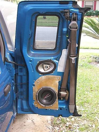

Since I had my 2003 Ranger Edge, Ive toyed with door mounted subs like this, especially since I have a Supercab again.
I just gotta get brave enough to make it happen. That and, the wife needs to approve, LOL

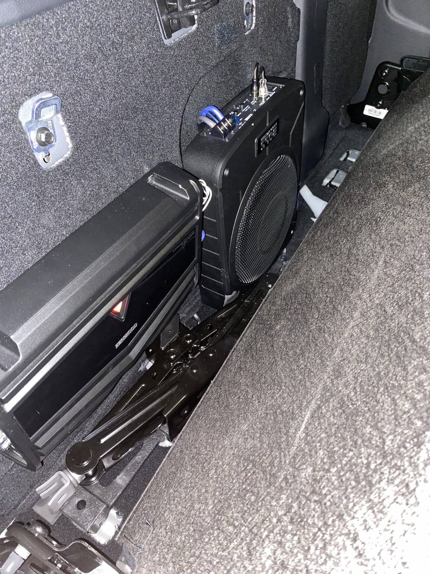

I used the plug and play kit with LC2 converter,a Rockford Fosgate 600W amp,and Kicker shallow 10ā€ sub in this eBay box that’s fits in the cubby under the passenger side rear seat.I bought it from a local gentleman who removed it from his truck.
ā€˜He went full sound system build.
Super happy with added fill

If you have the skills to make one by all means do so.For me, I just bought it,albeit used from some one local who was going full crazy.
I am satisfied with the bass I get from this,as it does shake and rumble nicely.I did wrap the poop out of it with some sound deadening material to make it a little more rigid,and added some poly fill to it.
It is not a sound DB competition box,but allows me to dial back the bass from the factory speakers,and have the sub do the heavy lifting.
My trucks an XL,and I can tell you I have no desire to replace any of the factory speakers after adding this sub.The sound is very nicely changed for the better.
I have had many people very impressed with the sound,and the simplicity of achieving it with minimal effort.

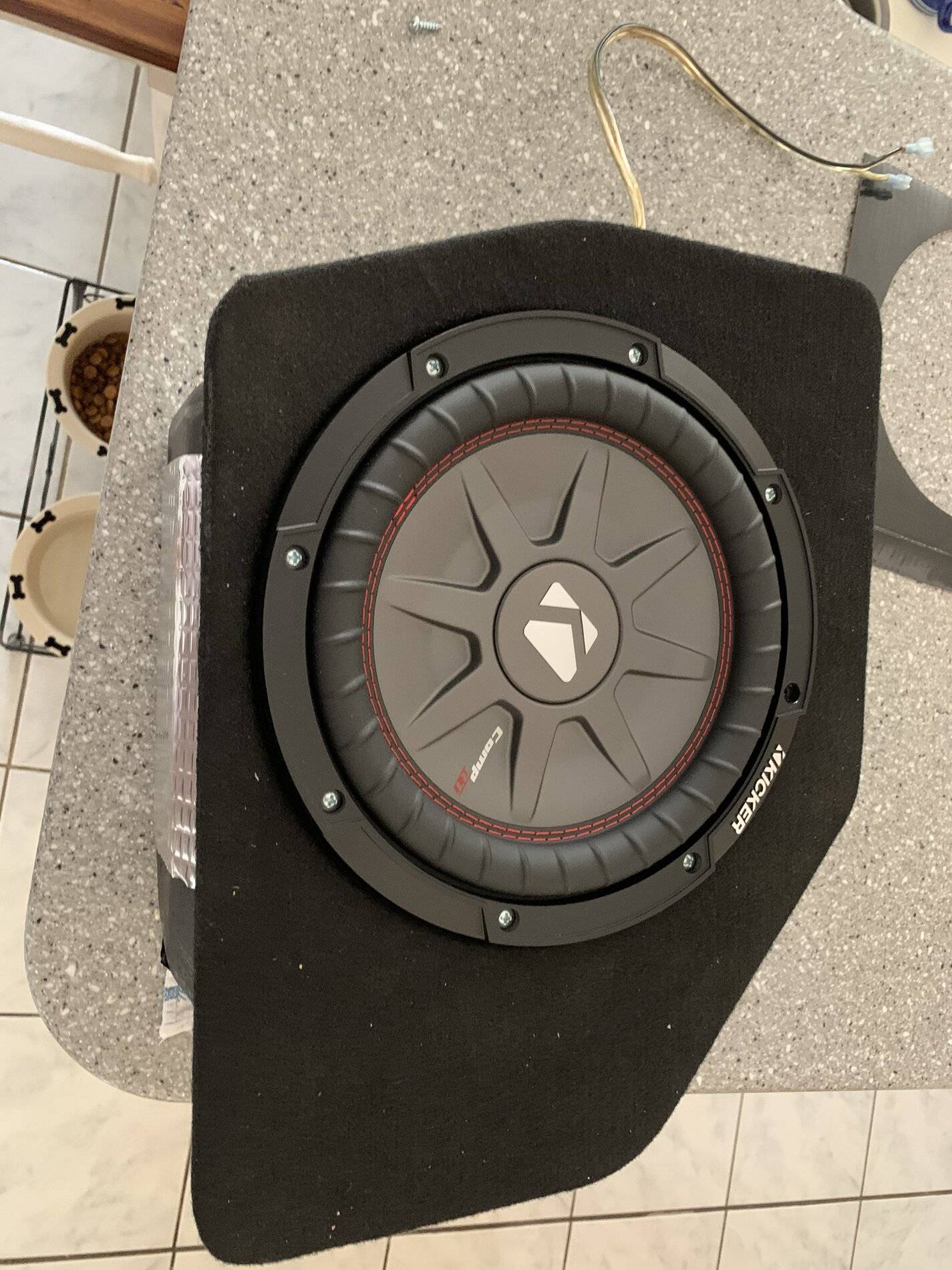

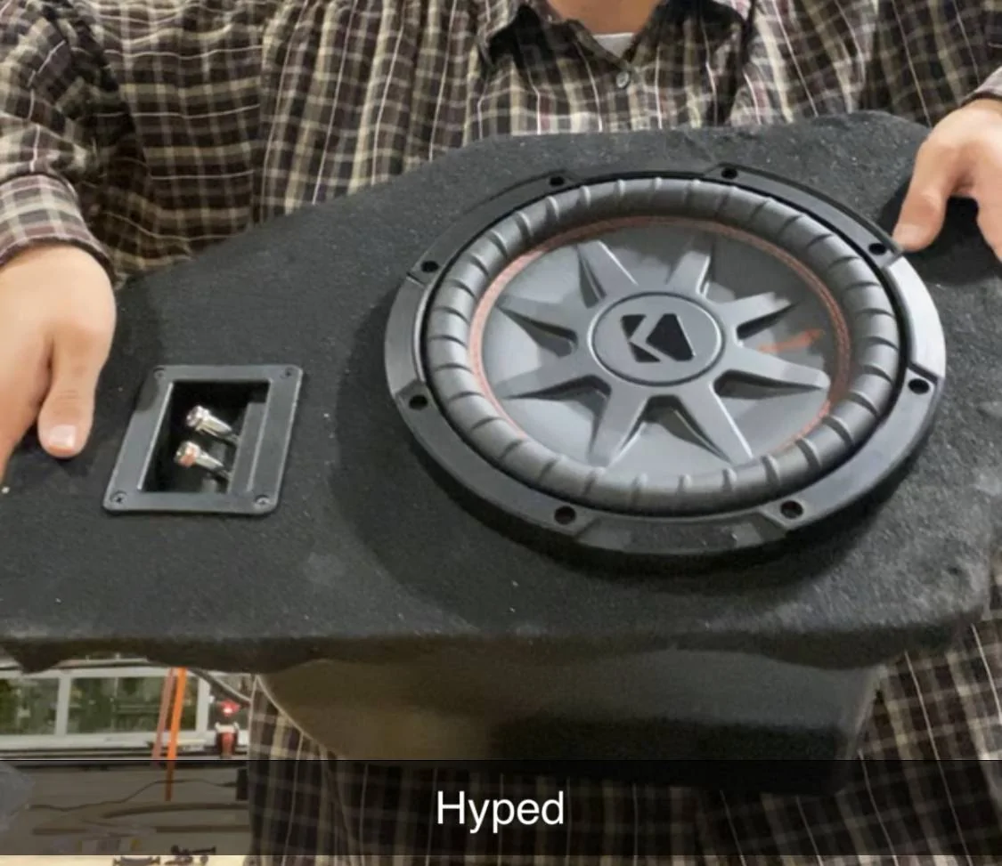

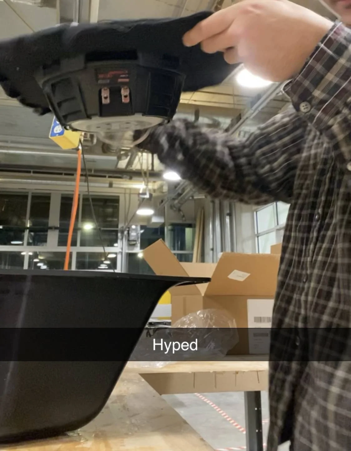

Hey man! I’m not gonna lie your post inspired me to get the same exact system for my truck. I ended up making the box myself which saved a lot of cost. The Kicker fits perfect and sounds so much better then stock. I honestly couldn’t be happier. It looks awesome too. I highly recommend this project for anyone who wants to make a cool little lid for the OEM plastic box that you can slap a sub on top of.
(btw I cleaned up the carpet a little bit so the raged edges aren’t there anymore , I’ll try and post a picture of what it looks like now soon.
