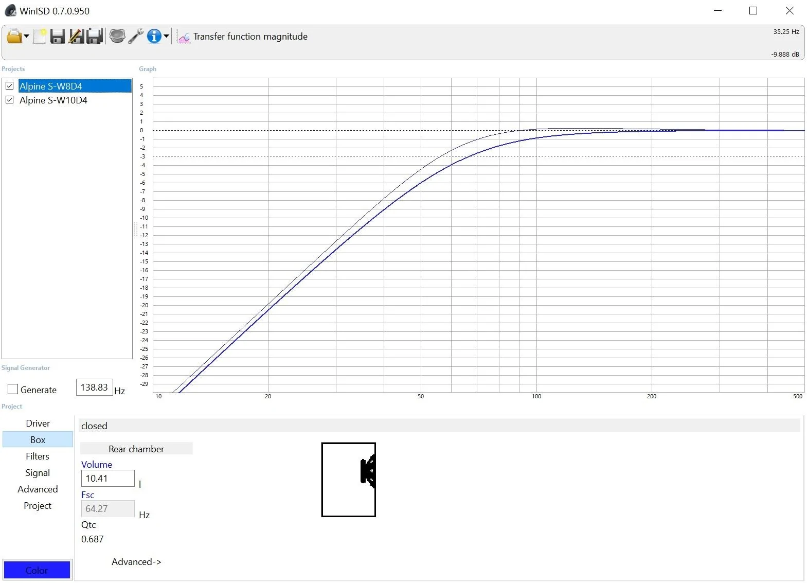

Here is the S-W8D4 vs. S-W10D4:
It looks like the 10" *could* work as well with better low end only a marginal increase between 100 - 150Hz. Now I'm doubting myself...

Don't forget the cone, magnet and frame assembly of the 10 are going to take up significantly more volume that the 8", making the effective enclosure volume even lower and the upper midbass even peakier. The 8 has almost the same extension on the low end without the peaking from high box Qtc in the 80-100 Hz range. You made a good choice, no worries. The 8 is the more musical choice while the 10 in that box would just simply be a booming noise maker in my opinion.
edit: I've got more discussion to talk you out of that 10 if you want to hear it.

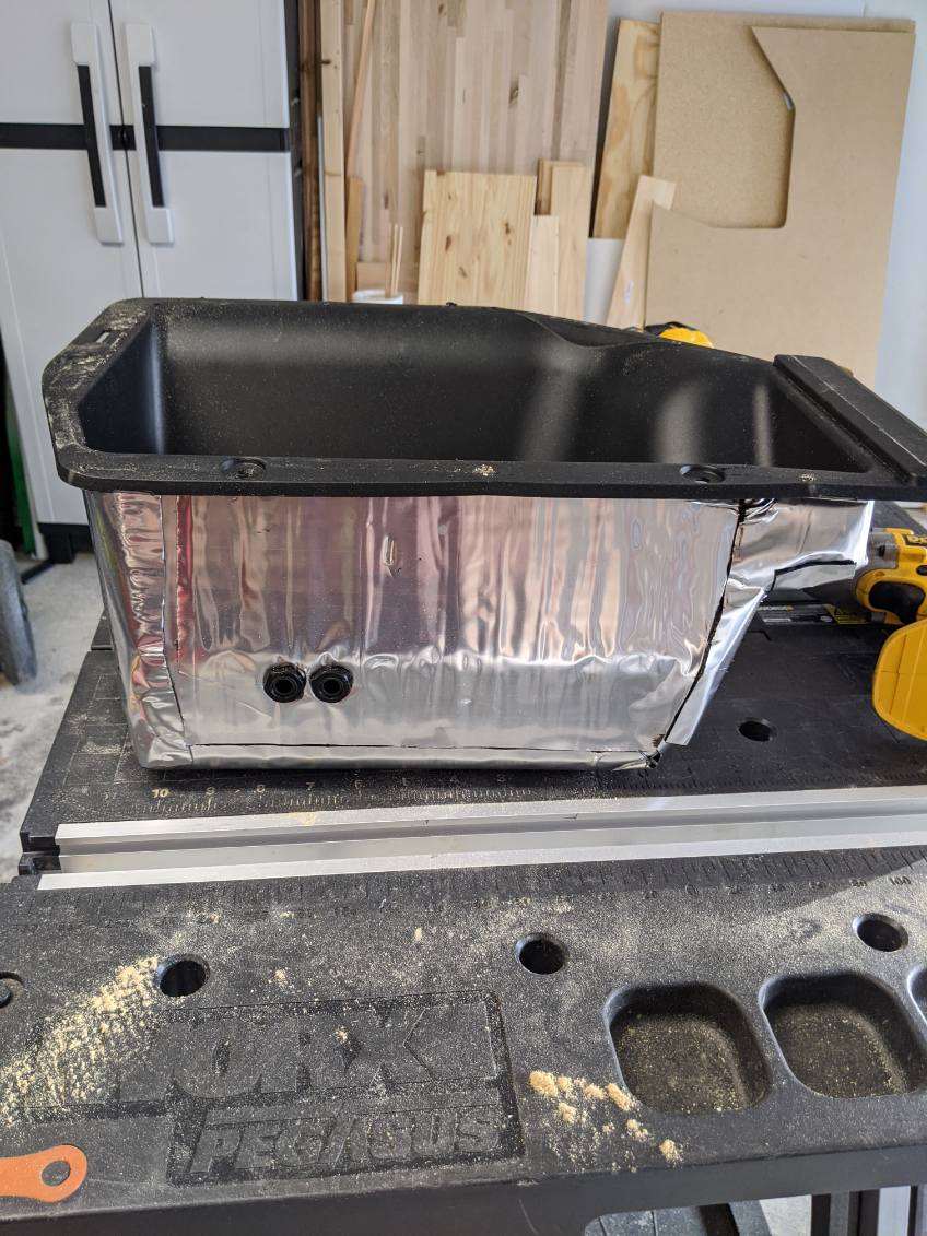

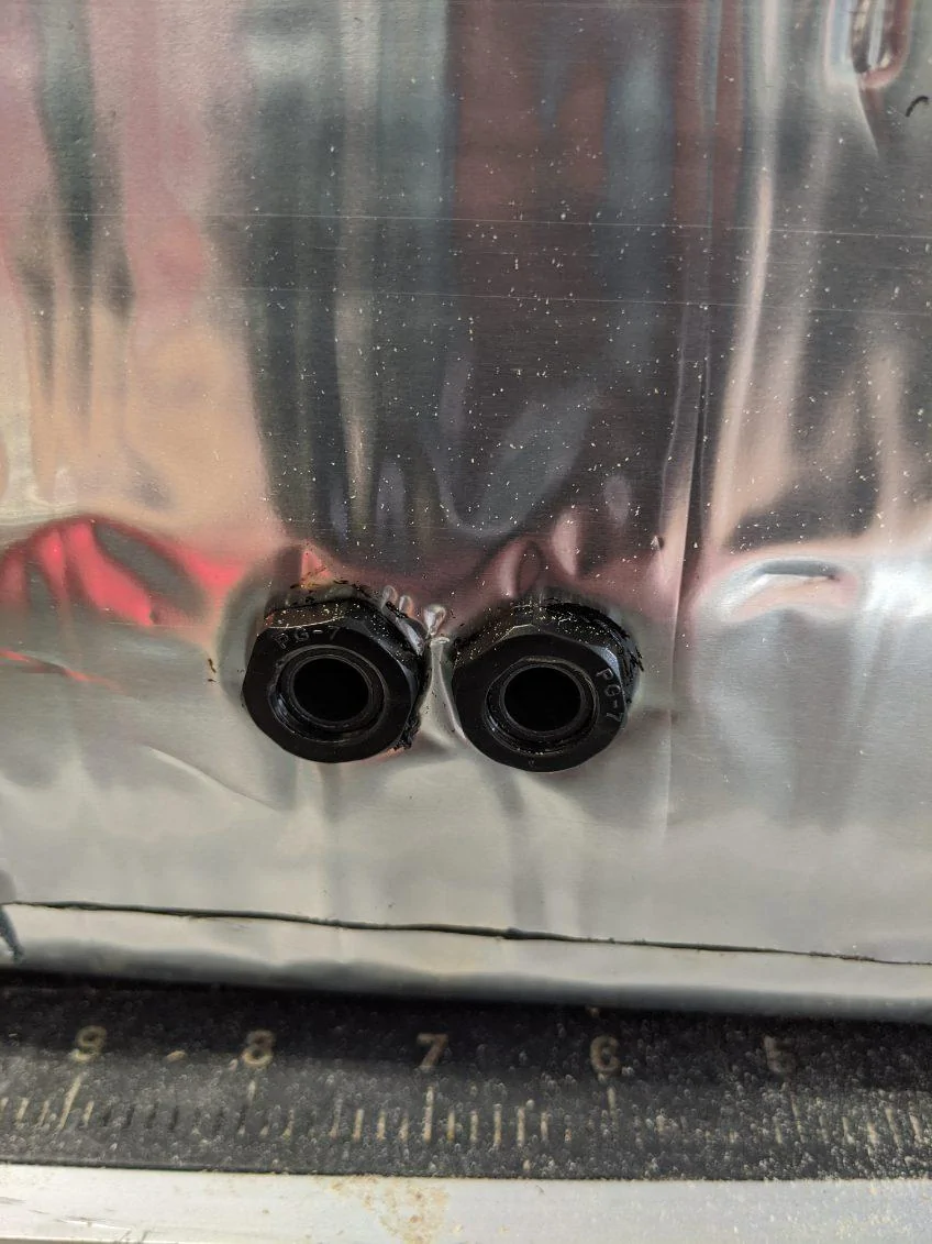

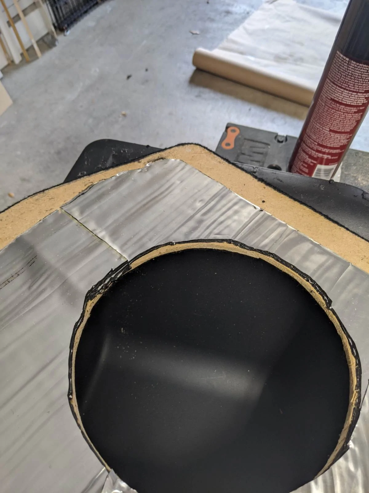

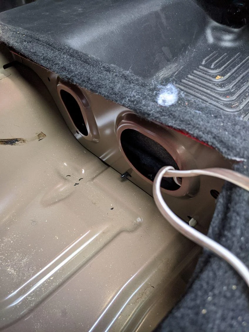

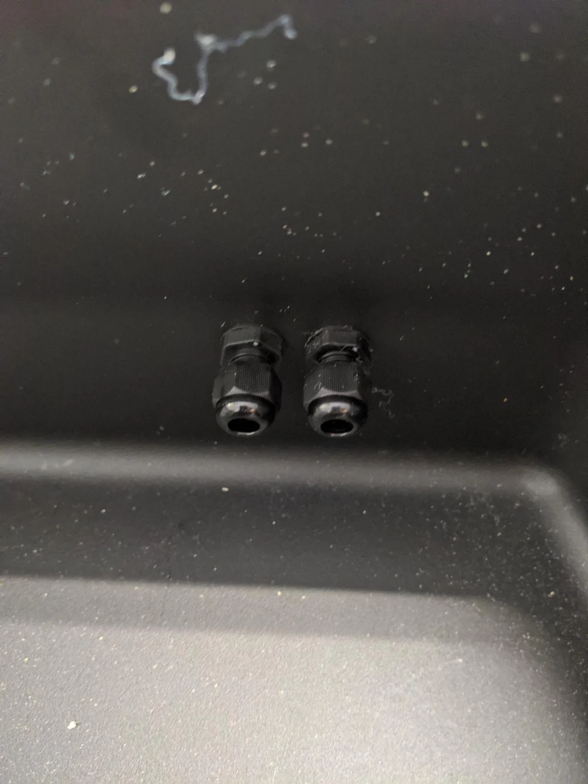

Good point - I didn't account for volume of the frame assembly. I have committed to the 8 inch Alpine and have prepped the storage bin for installation:
Installed double layer of sound deadening material:
Cable glands installed in the front to align with wire feed:
Wire run to align with cable glands:

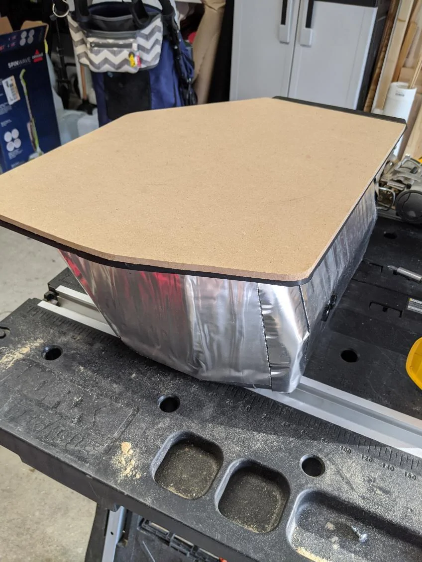

1/4" MDF Top board cut to fit:
Bottom of board lined with a double layer of sound deadening material:
Top carpeted, bottom sealed with GE caulk, screwed to top board:
Now just waiting for the Alpine.

Zaph,
Ed
That looks nice and clean! You could glue in some dowels cut to length to brace the MDF. 1/4" is on the thin side.
Ed Venture
Ed
Jan 1, 2020
54
98
Austin, TX
2019 Ranger XLT
Yeah - I may have to do that. I needed to keep the top as thin as possible to ensure seat clearance. The good news is that the overall span of 1/4" material is short (~18" in width and ~12" in length). If it is an issue, I can cut a couple of new pieces and laminate them together with glue and screws and recess the sub into the first 1/4" board.

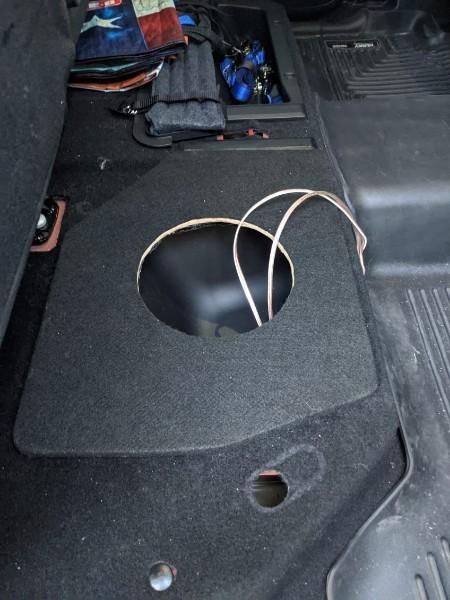

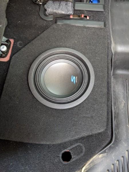

Installed!
Zaph,
You were 100% correct! You could put any number of 8" to 10" subs in there, but you would be hard pressed to find one that matches so perfectly with this makeshift enclosure. It is very smooth and very well balanced to be sure. It complements the new door components and rear 2-ways I installed last month quite nicely. I did NOT expect this much range on such a small sub in such an awkward enclosure. I am very pleased with the result!
I am running my doors off a Pioneer GM-D1004 in 4 channel mode and I am running the sub off a second GM-D1004 in 2 channel mono mode with each of the two channels driving each of the 4 ohm voice coils (the amp is not 2 ohm stable when bridged, but what do you expect for a $70 amp).
For those of you who say that you shouldn't drive the voice coils separately because out of balance signals could damage the woofer, I recommend watching this nerdy gem. As demonstrated in the video, I flipped the polarity of one of the voice coils to test signal balance and there was absolutely no movement of the woofer with the test tone so I should be good to go.
Again, sound systems are very subjective. In my youth, I would have gone bigger and louder (In my my younger days I had a 10 speaker setup in my 1990 Miata with 4 RF amps and 2 tactile transducers in a futile attempt create a decent sound stage in a drop top tin can). Some people love earth-shaking, jack-hammering bass. If you are that type - this is NOT the setup for you. In fact, if you are looking for that don't even bother converting the storage bin into an enclosure - you would never be happy with the result.

Looks good. You could also laminate another layer of baffle material on the inside for rigidity, just inside where the lip is. Then you won't lose your nice carpet surface on the outside.
