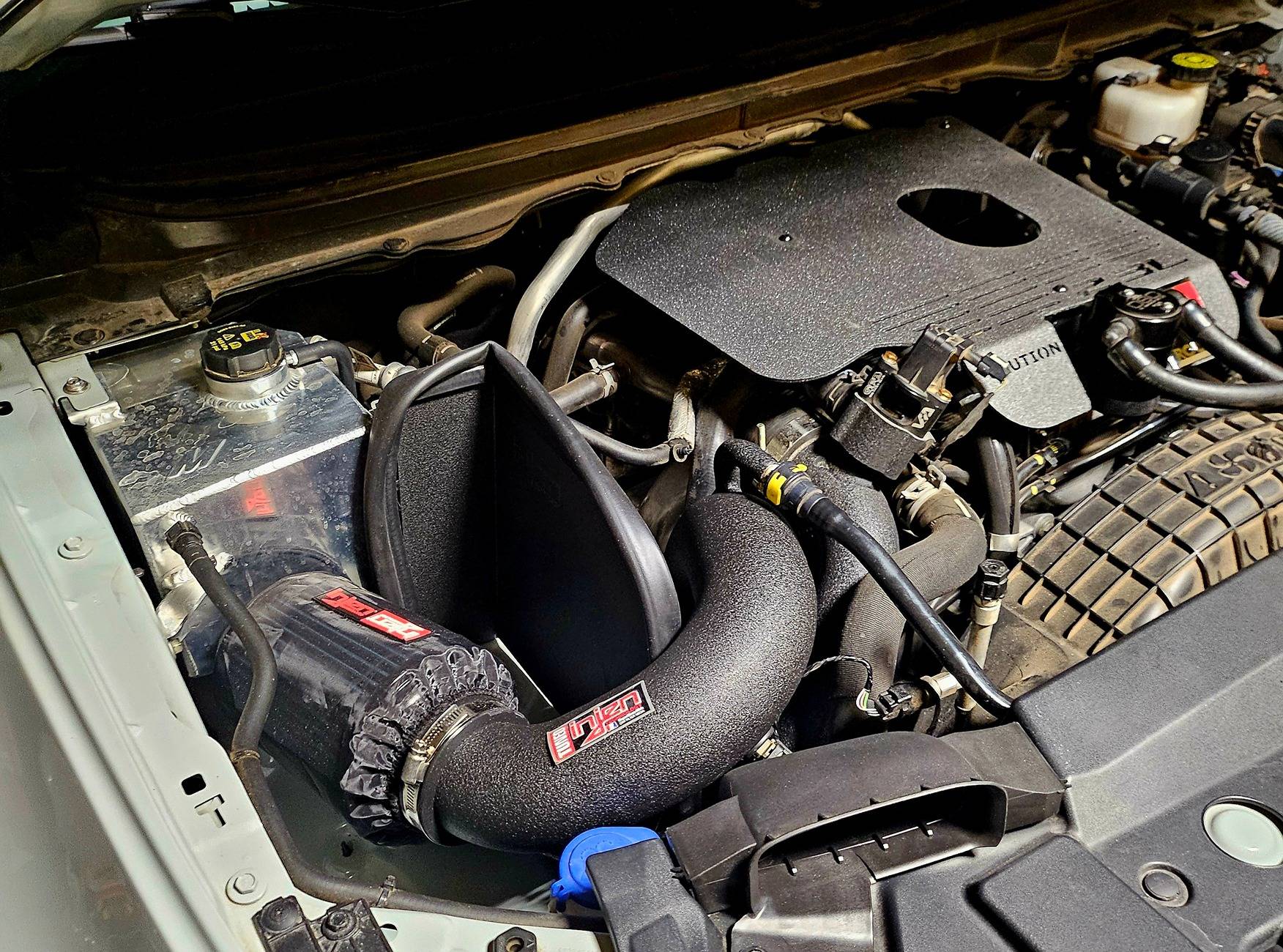

Like he said, it's a joke. Unless you move the air filter out of the engine bay, it's always going to be sucking in hot air from under the hood. Intakes that use the stock lower box try to combat this a bit by using the stock "scoop" that pulls from the front edge of the hood.

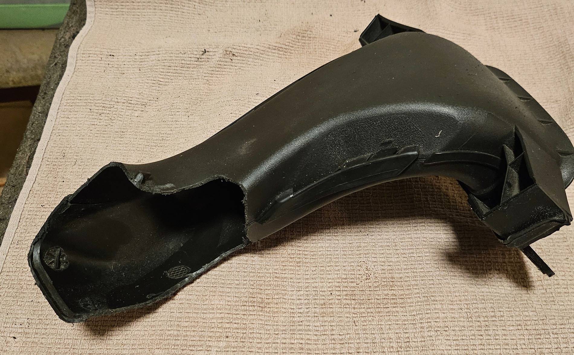

I know this was a few years ago but I tried something (that seemed to make sense to me). I wanted my cake and wanted to eat it too...
I carved up the stock intake snorkel so it would blow directly at the air filter. The modified snorkel presses against the Injen trim seal so all the air coming in from the front edge of the hood is funneled to the bottom of the air filter.

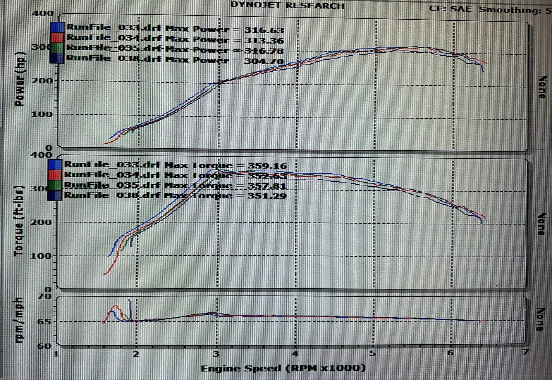

Unless you’re trying to make over 350 wheel horsepower then it’s not going to be a factor. Pick the one you like. Injen makes more noise but some people have a problem with it because they are afraid of hot air ?
The S&B is amazing, I was even visited by their rep at our shop yesterday, they make a nice, versatile product. I’ve dyno tested Mishimoto (similar to closed S&B) Injen and my 4” custom made open intake. They all made the same horsepower on my truck at 316rwhp with Injen and my 4” being highest. The graph is a full bolt on truck with stock turbo on 93. No tune changes were made and the baseline is the stock intake. I believe Mishimoto was in the middle.

So I took inspiration from your posts and went with an Injen CAI. I love the new noises my Tremor makes! You mentioned

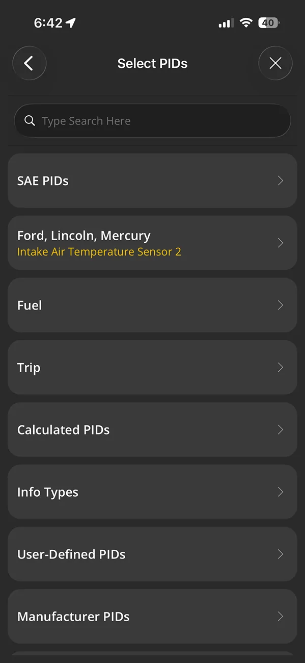

So I have an OBD Link MX installed so I can monitor transmission temps as well as IAT. How are you able to monitor your charge temps? Is there a PID specific to that?
The Charge Air Temp - is read by the MAPT (Map Sensor with integrated Temp Sensor) and is PID displayed as IAT2 (Intake Air Temp Sensor -2)

thanks for the help! So I’ve got Intake air temp sensor 2 pulled up thru my OBDLink MX+ and reading on one of my gauges right next to my intake temp #1. I recently installed the Injen CAI on my Tremor. I’m noticing at times in traffic that sensor 2 is reading higher or the same as sensor 1. I was hoping there would be a greater Delta between the two but in the opposite direction regarding those temps.. Is that normal?

I have never really monitored my iat2 - while driving and have some (Live Data) samples for reference but only at idle.
But I suspect you are seeing heat soak from the charge pipes and intercooler, since a CAI is only lowering the IAT before the Turbo & Intercooler.
I think even at cruise - with only the CAI you may only see about 5 degrees lower IAT2 over stock as you are still using the stock intercooler.
So in traffic - stop and go etc - you do not have any ram air across the intercooler and are getting heat soak from radiator, engine bay - setting on the intercooler and charge pipes.

OK that does make sense. however, on my way to work this morning (5:00am), I was monitoring my temps and still getting a higher intake temp on sensor 2 than sensor 1. This evening I’m gonna play around in OBDLink app to see if I’m using the correct PID. I appreciate your help

What is the driving condition and what are the readings for IAT and IAT2 and also Ambient Temp?
Also is it - under boost at the time of the reading?
It falls into the job of the intercooler - its job is to lower the intake air, after the turbo and its goal is to lower the temp as close to ambient as possible, so when under boost the turbo is adding heat that the intercooler must remove and when not in boost its removing (heat soaked) air
