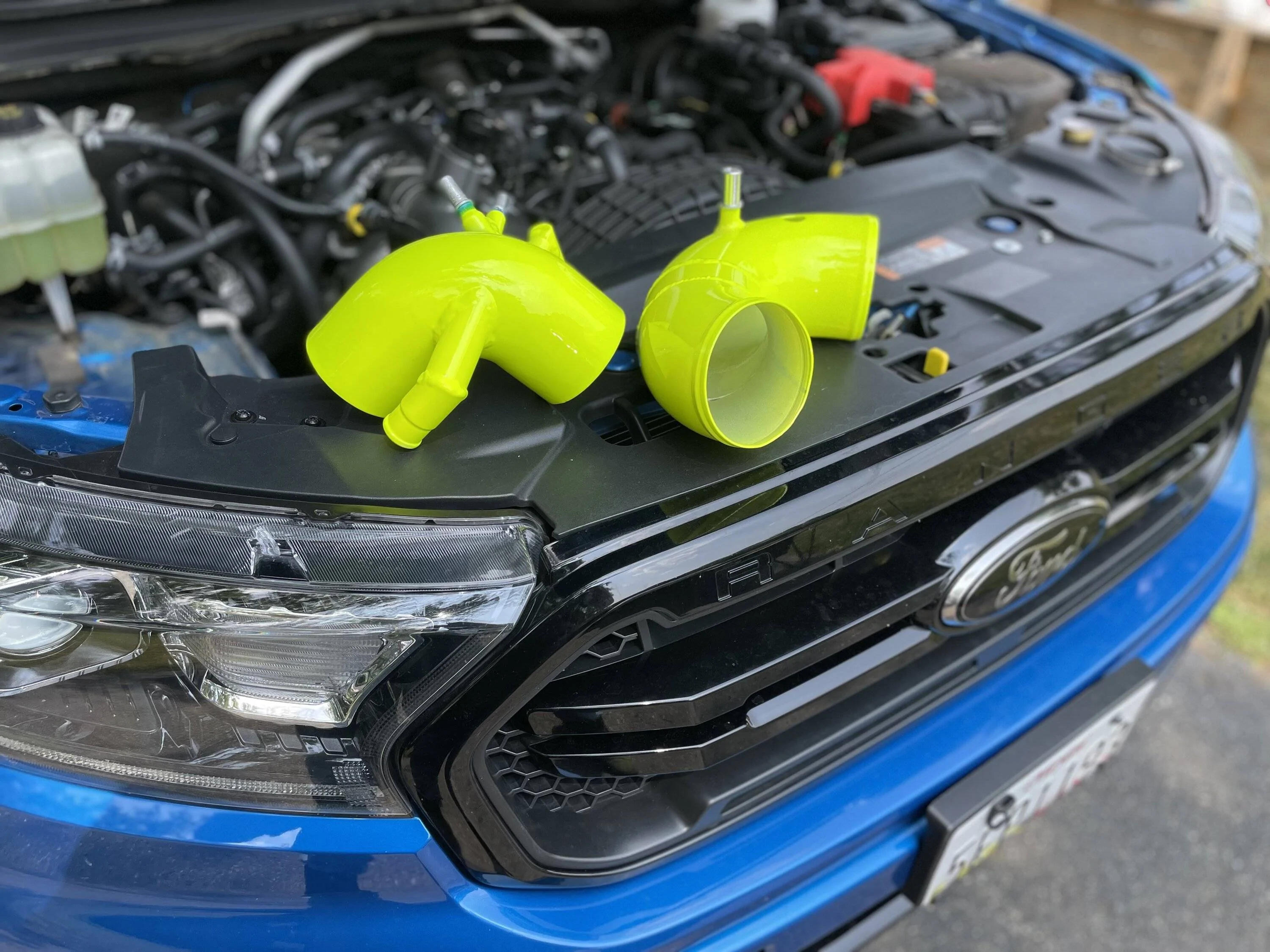

Intake with the blow off integrated looks great. Put me down for one if you decide to produce them.
That is the turbo inlet pipe that has the BOV fitting in it. Just like stock. The intake is also stock style fitment, meaning that the BOV is NOT integrated any differently than stock configuration.

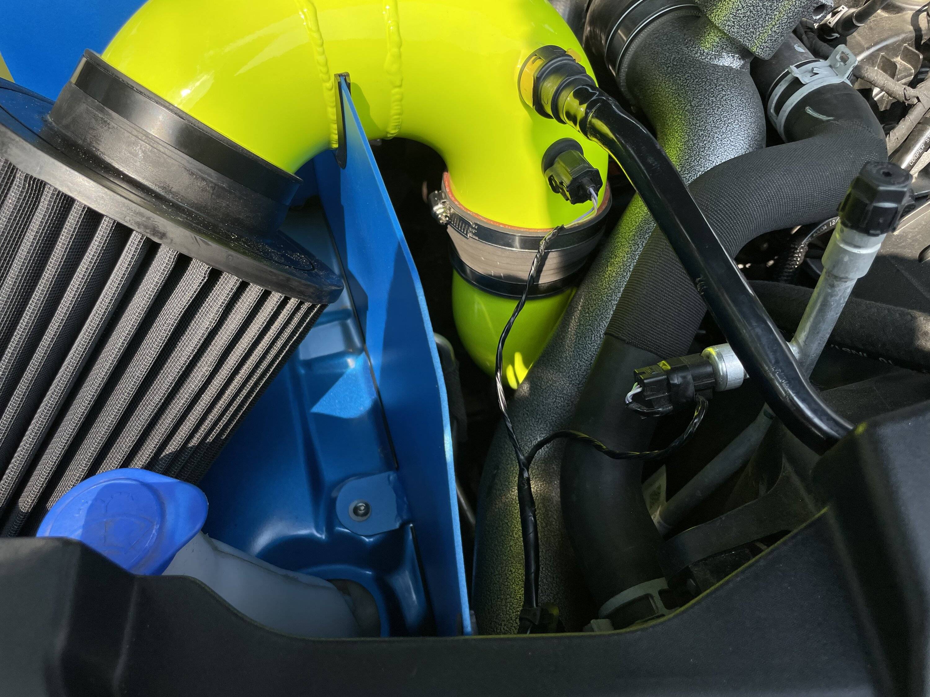

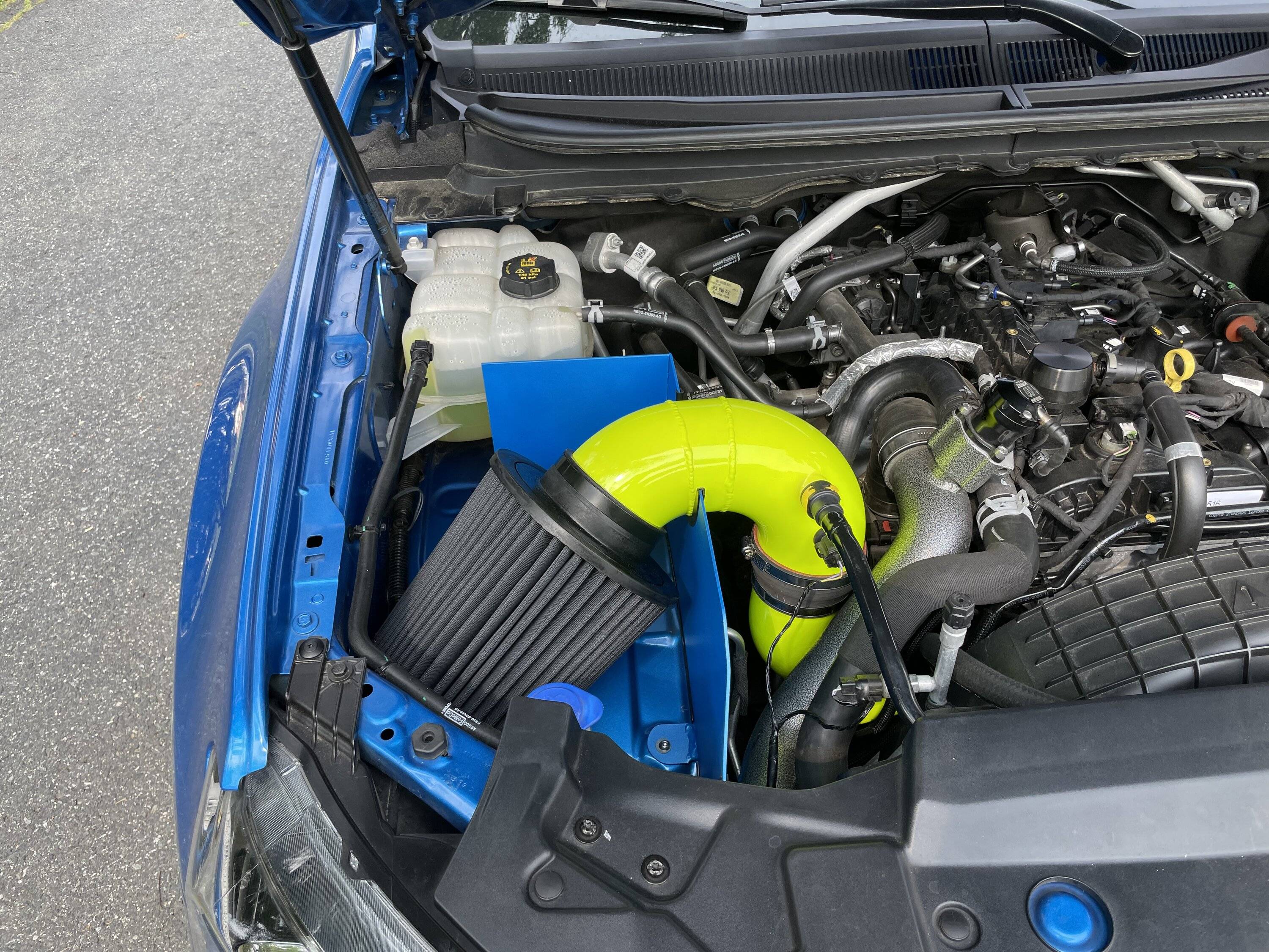

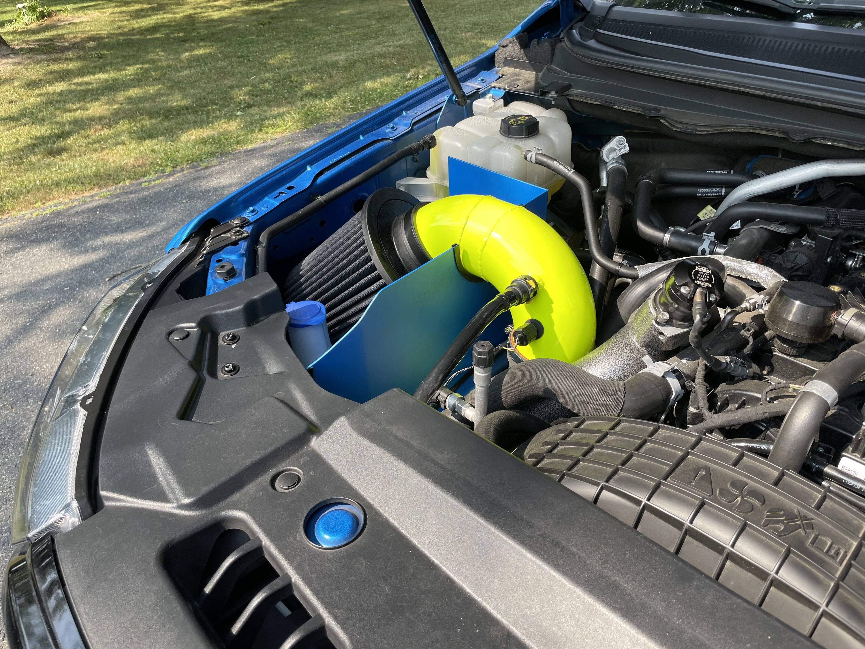

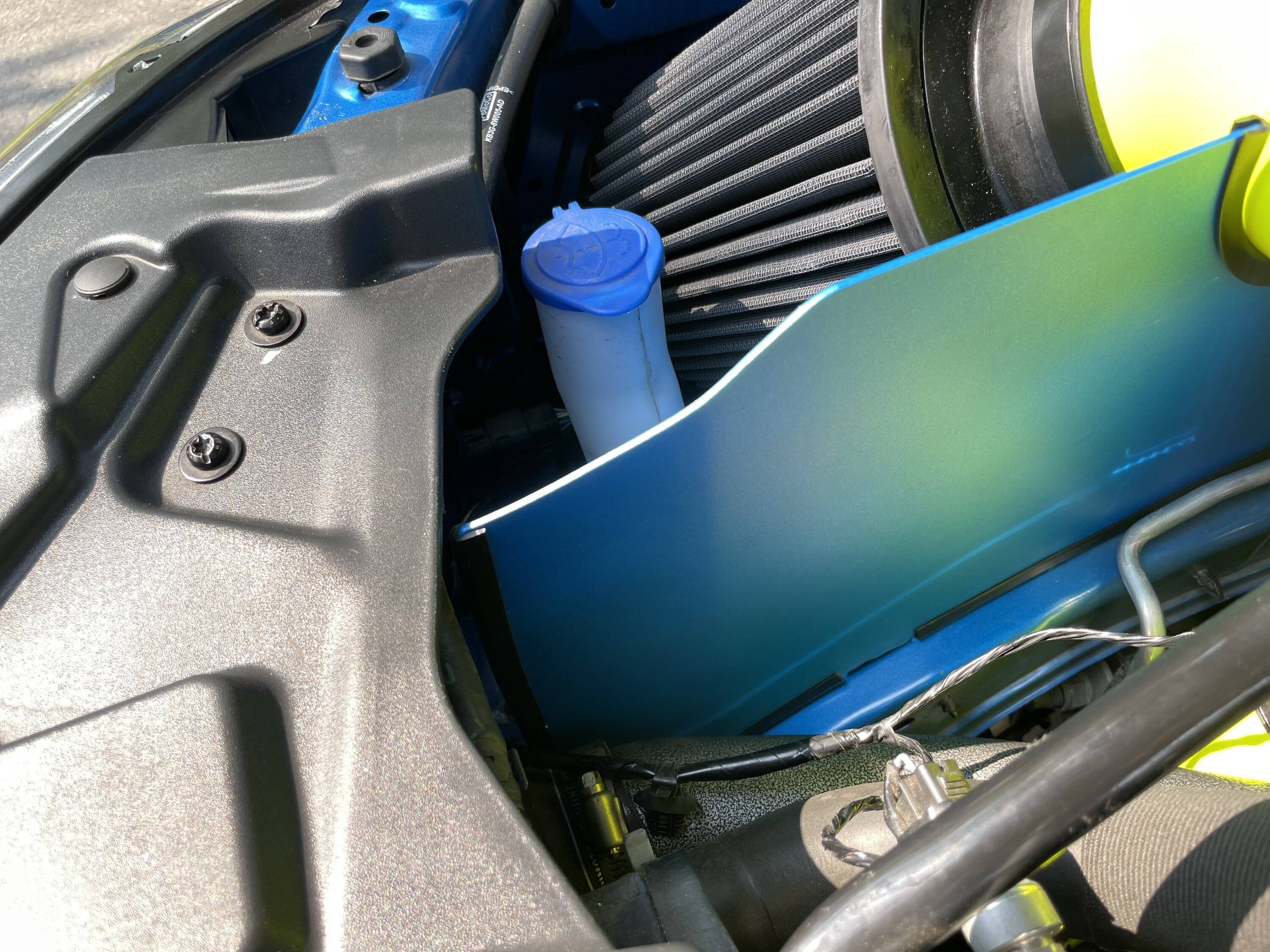

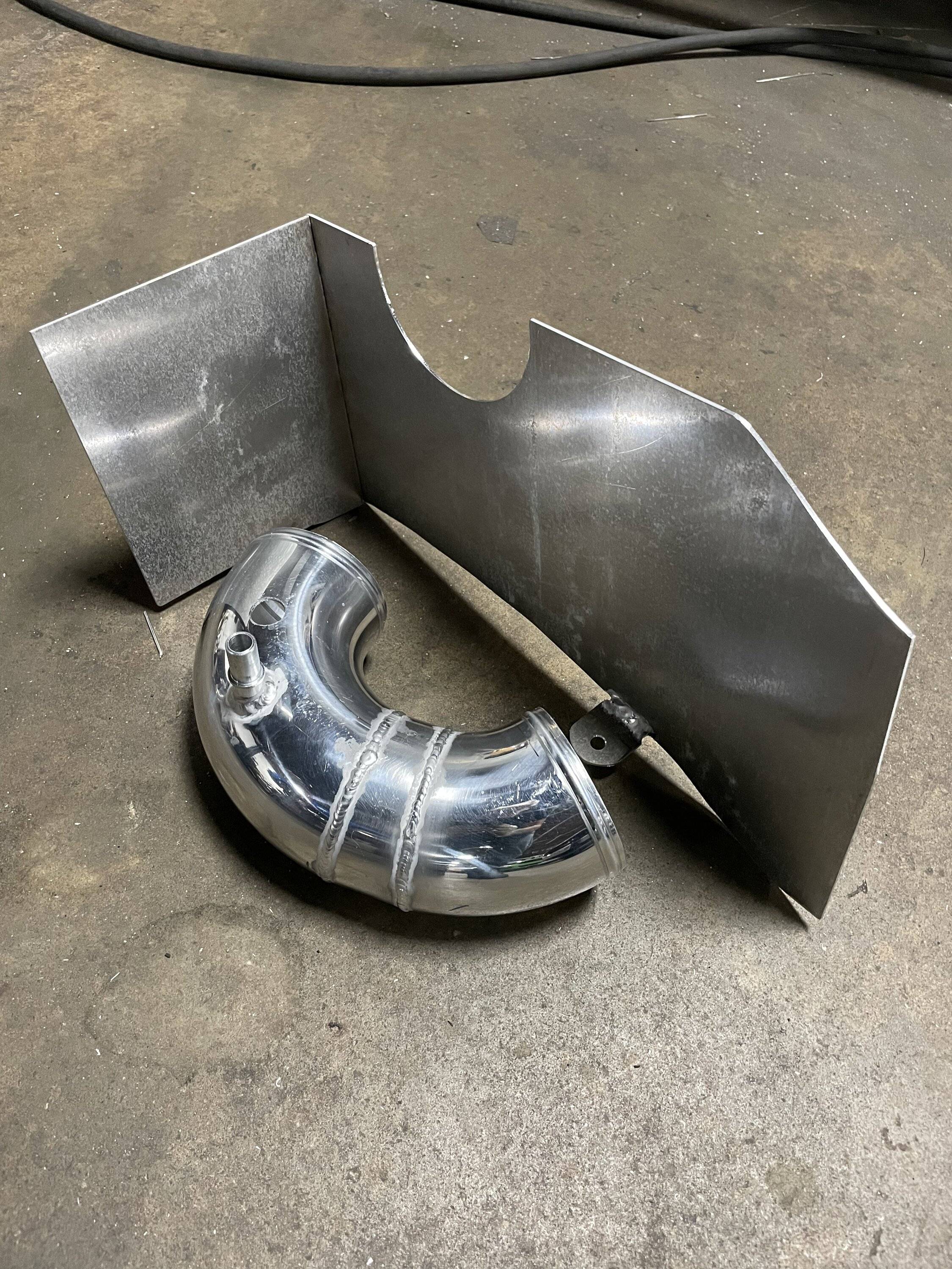

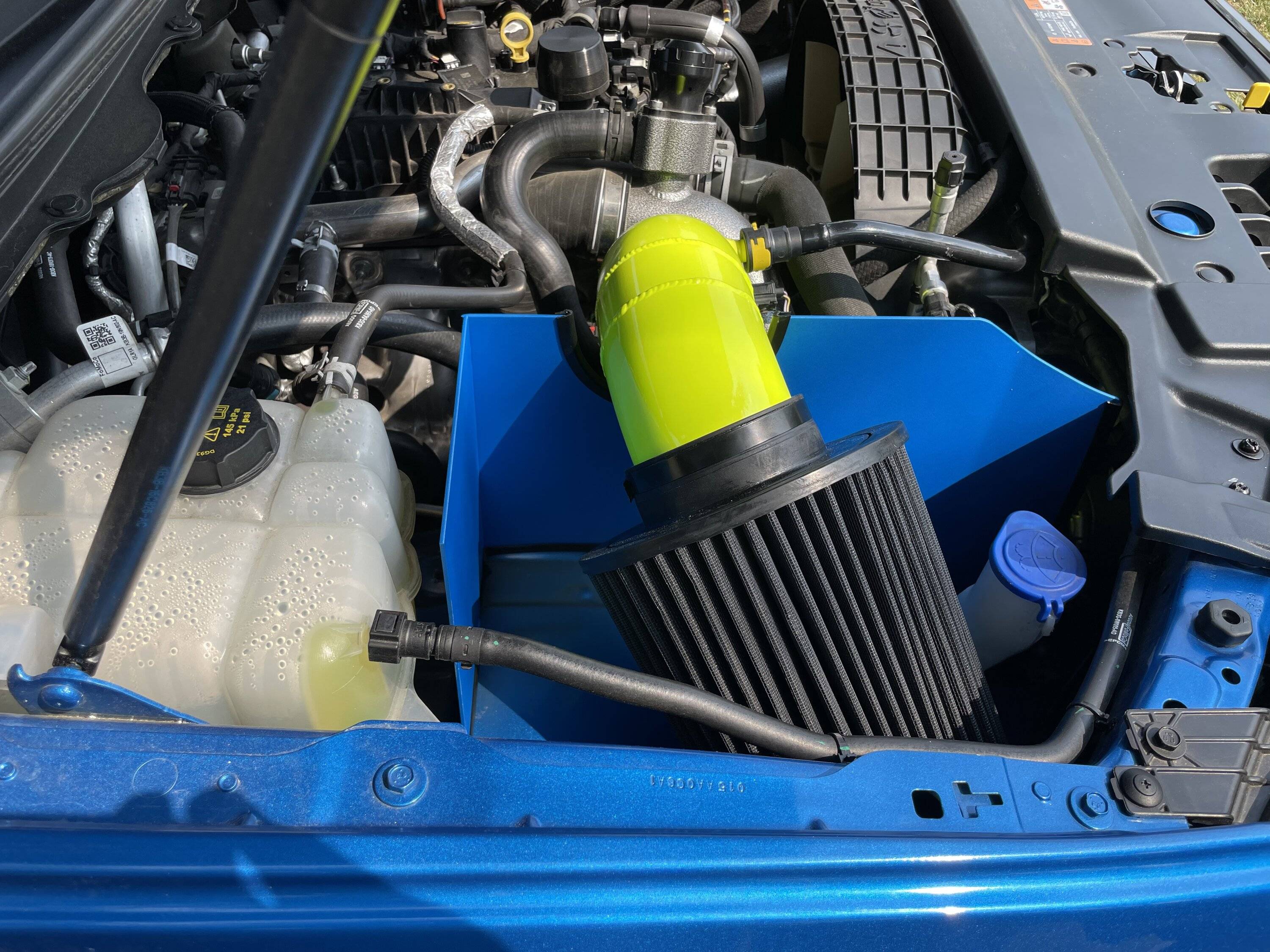

Decided that I liked my Injen hot air intake a lot but it wasn’t quite how I wanted it so….. I made my very own HAI whale dick edition. It’s all 4” mandrel bent aluminum with an aluminum heat shield. Been driving around all day and the IAT was really good, better than Injen but obviously not as good as the almighty stock CAI… quick data comparison shows it picked up some airflow over the Injen intake too.
@Loweredon33s I know this is digging up an old thread…but my interest in what you have created is in the lower intake section. The section right before the turbo. As this is the factory piece that I think is the most convoluted and restrictive. I think it’s dealers choice for the top section for whatever anyone’s preference is- but I think the lower section will make any top section shine in its own light.
that being said do you have any more info on parts used for that build? Or possibly offer that part for sale?

Cody keep looking in the for-sale section they come up now and then, took me over a year to get one lol Super nice piece
