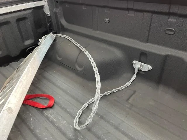

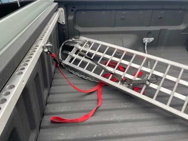

I know that nothing is safe in the bed of a truck, but I had to try, I braided a cable, crimped and welded up the ends and put it through the bed wall with 6mm ARP bolts with locking nuts on the backside.
It's locking just the ramp or bike and ramp.
That cable looks sweet. Probably way cheaper than buying a beefy one pre-made.

Thanks, it was something I had laying around, one strand was small and easy to cut, so I had the wife show me the braid pattern and did 3 cables together, I figured a death wheel can cut through anything quick but when its an inside bend it tends to grab the wheel toward the end of the cut, so I can only hope they chunk the wheel or something.
