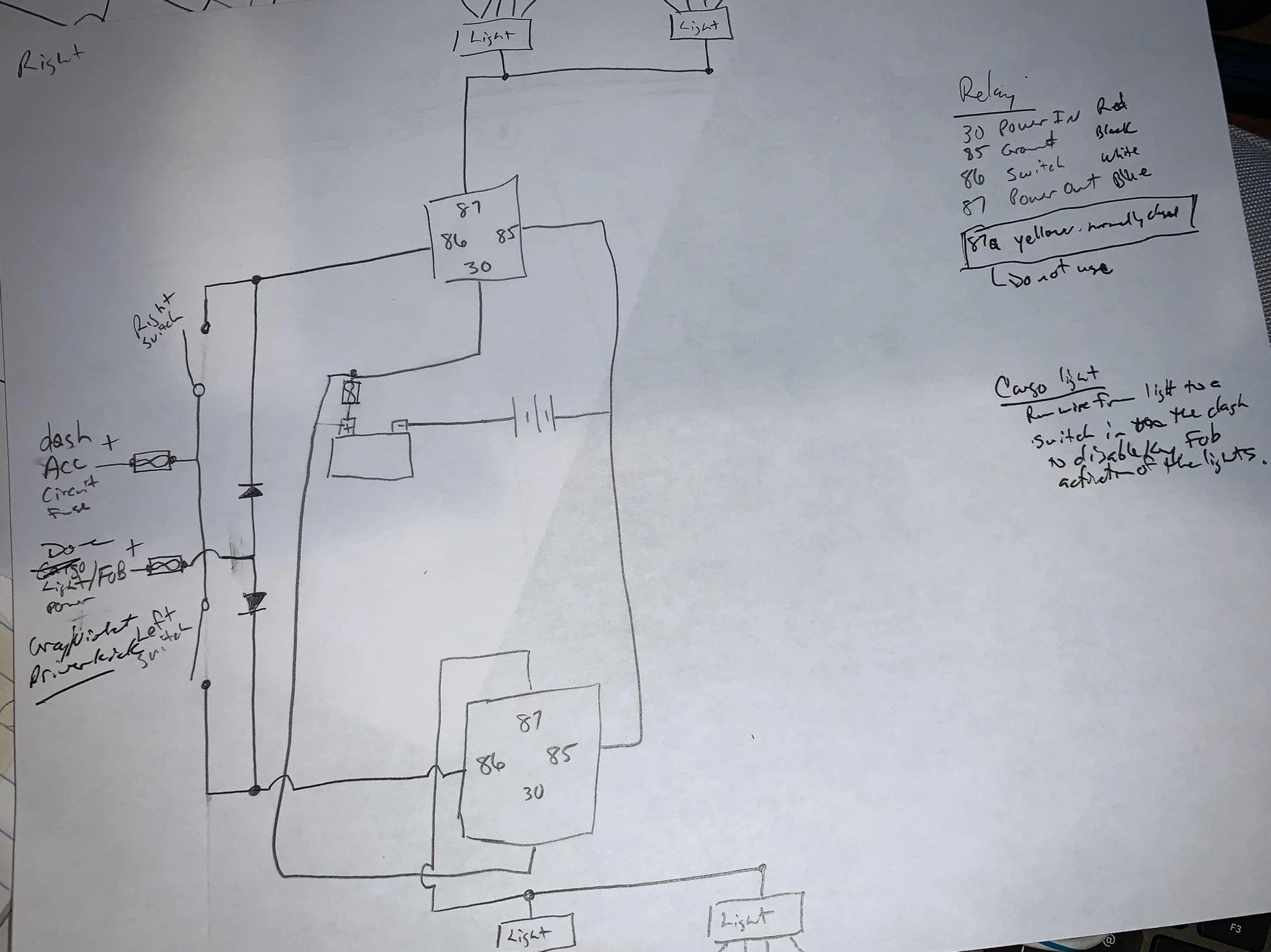

Sweet lights! Check mine out... also note that I wired the sides so I can turn on the left and right independently. Further wired it so when the cargo light goes on, both sides go on that mean both sides work like puddle lights and that when they are on with the cargo light switch, they go off at like 3 mph it’s pretty neat! See the rough schematic I sketched out below

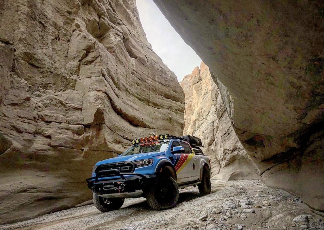

I might steal the kc lightbar idea but i got other plans for bumpers and stuff lol
