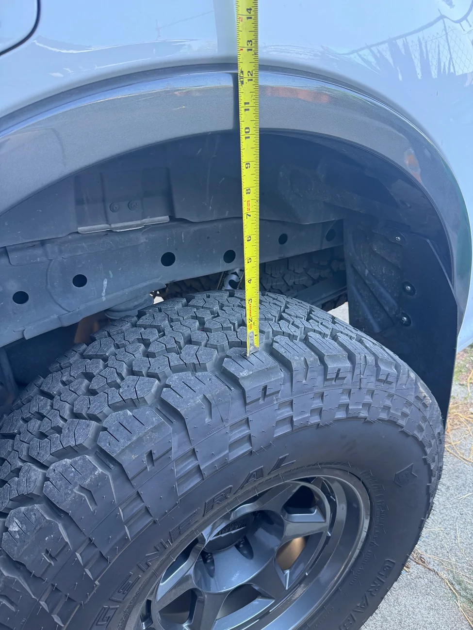

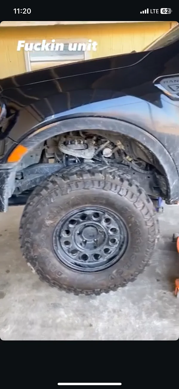

20’ Ranger, Bilstein 6112s front and rear. Icon leaf pack in rear. Rear lift equates to about 5-6”, front seems to not have lifted barely at all. Maybe 2” at the most. I’m looking to run 285/70/17s and eventually 35s. I was curious as to what setup people are running up front to clear 33-35s. Im currently running 265s and Bronco 17x7.5” wheels which I want to keep. Included a picture with the old 255s to show how close they are up front with the current shocks. (Rear pack hadnt been put in yet.) I’m thinking something along the lines of 3” or 3.5” up front. I was thinking the icon 3.5” coilovers. Let me see some pics of minimum 3” up front and 33-35s w/ no rub.

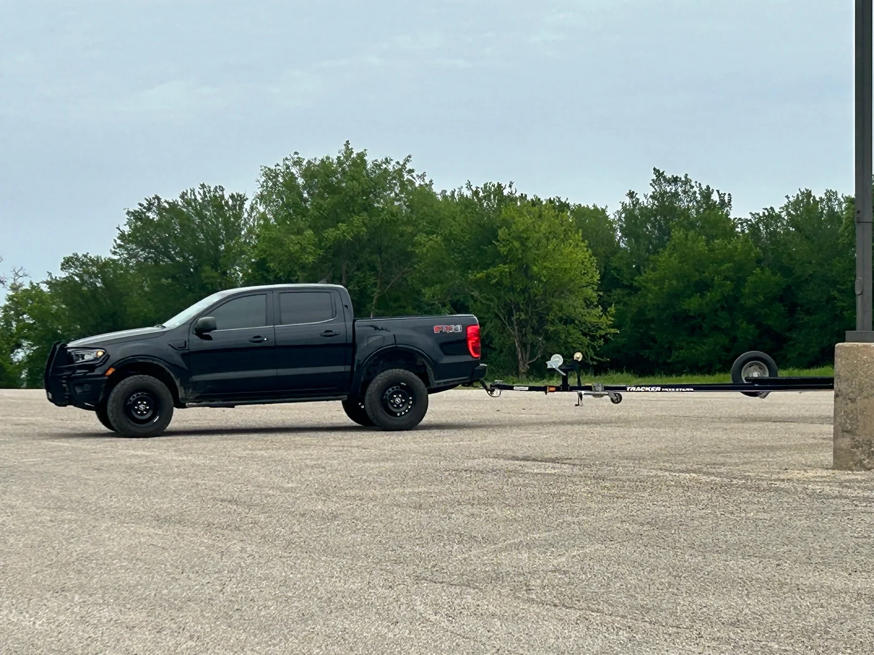

Like this?
Mine comes out to about 10 1/4 ish.
However this measurement will fluctuate a bit depending on tires..also I have a tremor so I have a slightly different leaf pack from a standard ranger.
