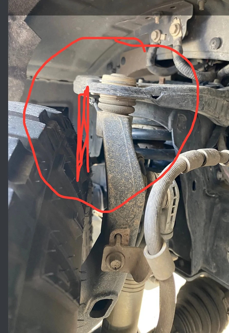

Personally it’s more the front and rear of the wheel well/fenders that seem to be the true issues… like the crash bar locations..

Those are 265/70r17…(oem tremor tire size)
At first glance I believe anything over a 33 will run on the uca to knuckle area…
You’ll have to get wheels with a better spaced offset than you have.

What about a spacer? I’m not a fan of them but I’ve never ran them either

What is the proven wheel specs to be able to clear all of that and run 33s/35s? Just in case I do go that route

A lot of people run spacers. Currently I am running a 1 inch spacer, but I have ran a one and a half on my Ranger as many others have also.
What brand are you running?
I have some 1.5” spacers 😅..
Never installed them.. they’re for sale 😇
Anyway, yes spacers are an option… min 1” spacer..
as you move outwards.. the outboard side of the wheel moves closer to the red zone of rubbing in the crash bar areas.

I think I’ll try a 1” strut spacer for now, a 1” wheel spacer, and try some 295/70/17s. After that if that works well enough, I’ll spring for a 2.5” RR with some more lift and some 35s
