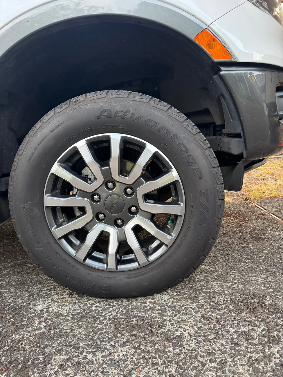

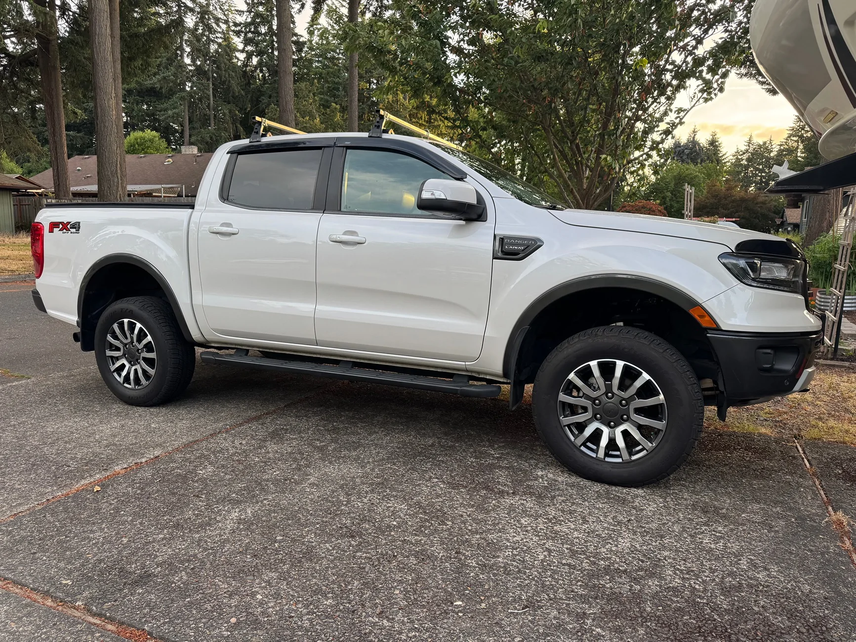

I have 255/70/18 on mine. No issues and I only have about one inch in height with my suspension in the front.

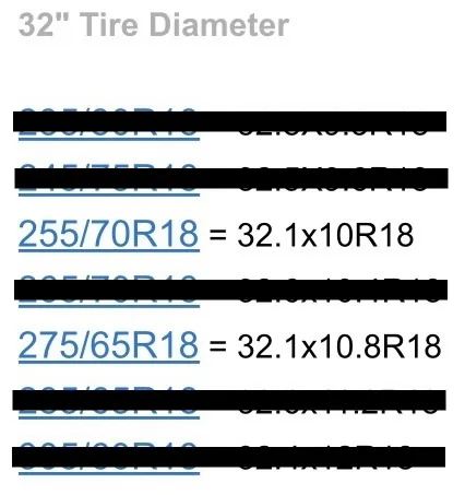

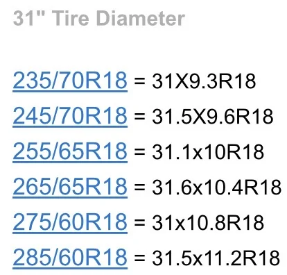

You should check out Tire Size .com. They’re a good resource for helping choose tire size and wheel offset.
You “should“ be fine with any of these….
I crossed out a few of the 32s that I thought were either too wide or too tall to be plug ‘n’ play.
