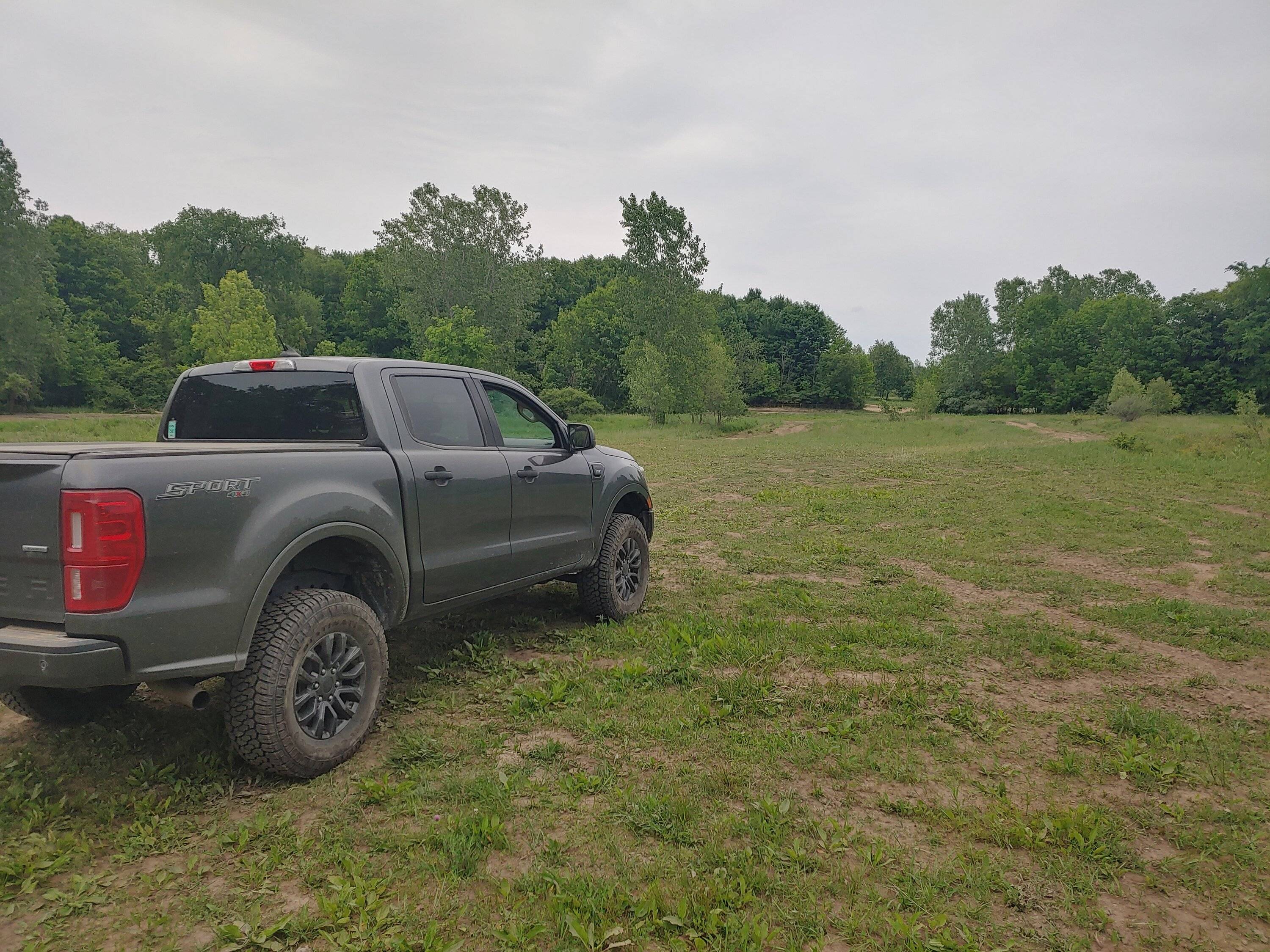

I installed Bilstein 5100’s all around with middle setting for height, think 1.2” lift on Front. Rides super nice, on 265/65/18 at3w wildpeaks.
Truck looks great! I wish these trucks came like this at a minimum from the factory.

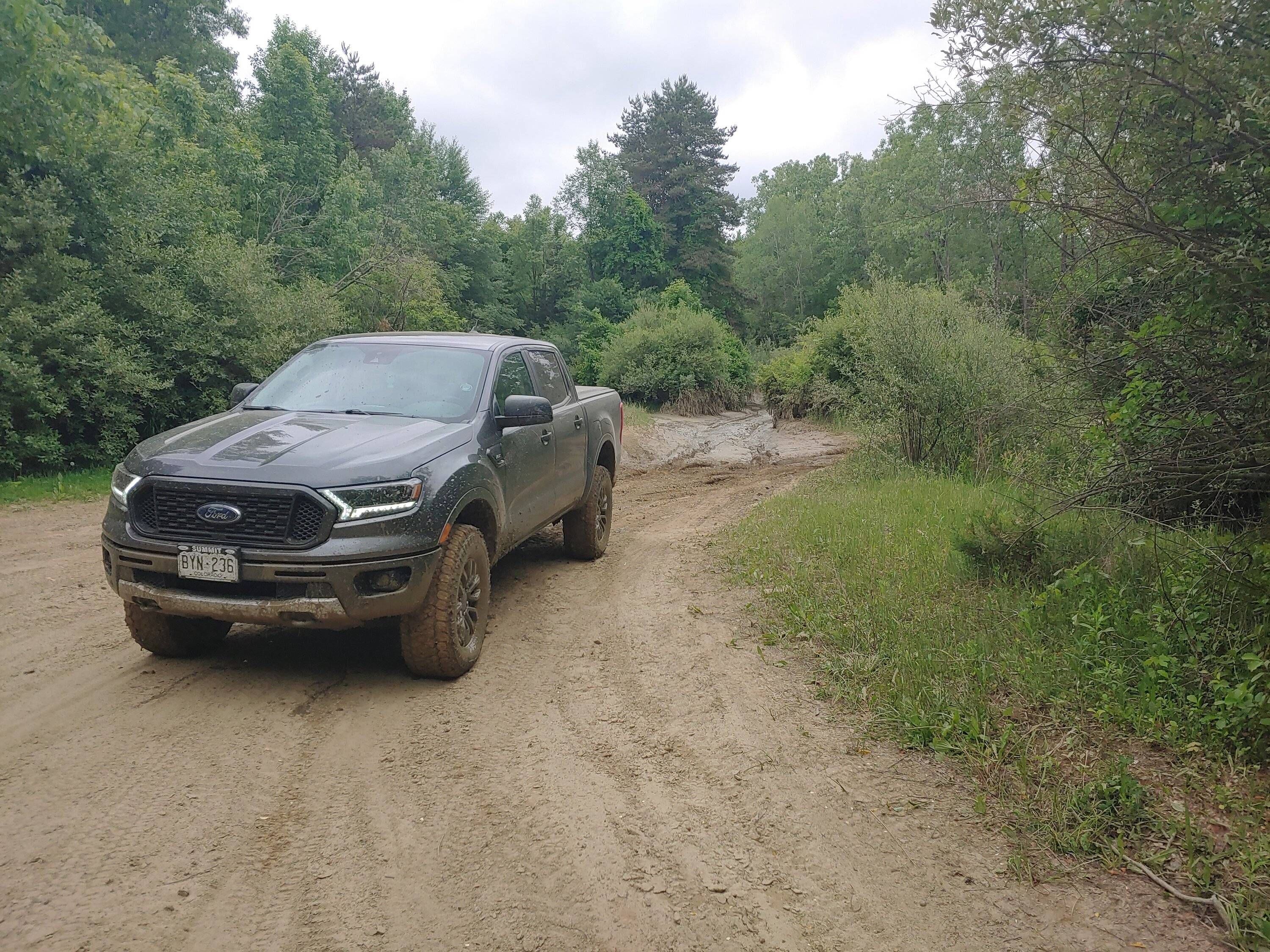

So I pulled the trigger on a lot of stuff! Got the Eibach Pro Truck Stage 1 kit and set the fronts at 2.25” (2nd ring from top) and used the factory coils. Installed ready lift intrusion beams and threw on P295/70-17 Toyo Open Country AT III’s with the 1.0” faction fab spacers. And finally, this truck is exactly how I wanted it!!
Installing the Eibachs was a little more involved than expected. I marked the alignment bolts and dropped the LCA’s and had the struts out, springs swapped to new ones, and back in the truck in about 30 minutes per side, but getting those LCA’s back up to get the bolts in was a bear. Took a few bottle jacks and a few choice words.
The intrusion beams also gave me a little trouble until I finally just loosened the bolts on the front bumper enough to slide them out. Cut the rears with an angle grinder as the sawzall didn’t seem to do that great with the blades I had.
Still can’t get over how much better the ol’ girl looks after all this!!
