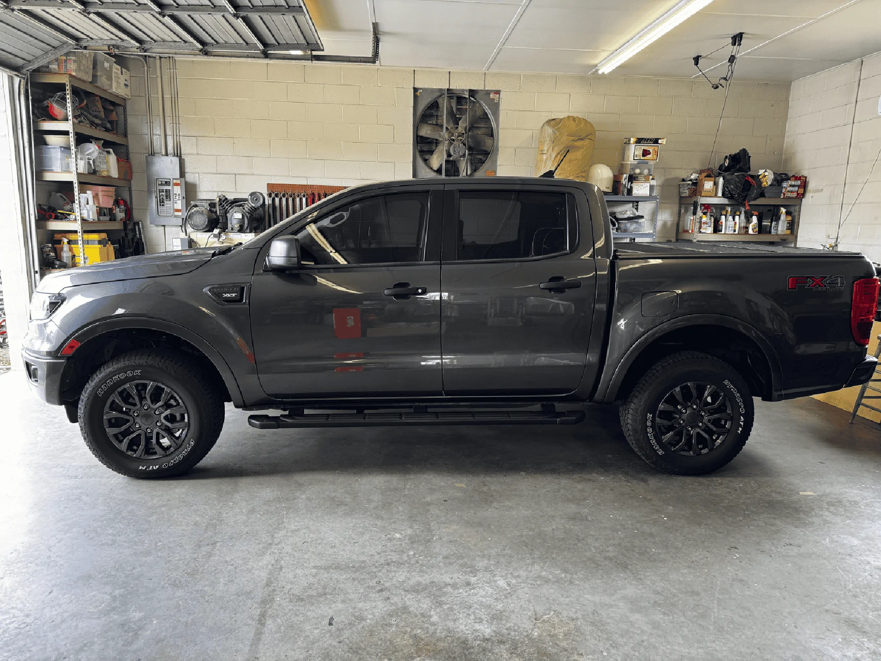

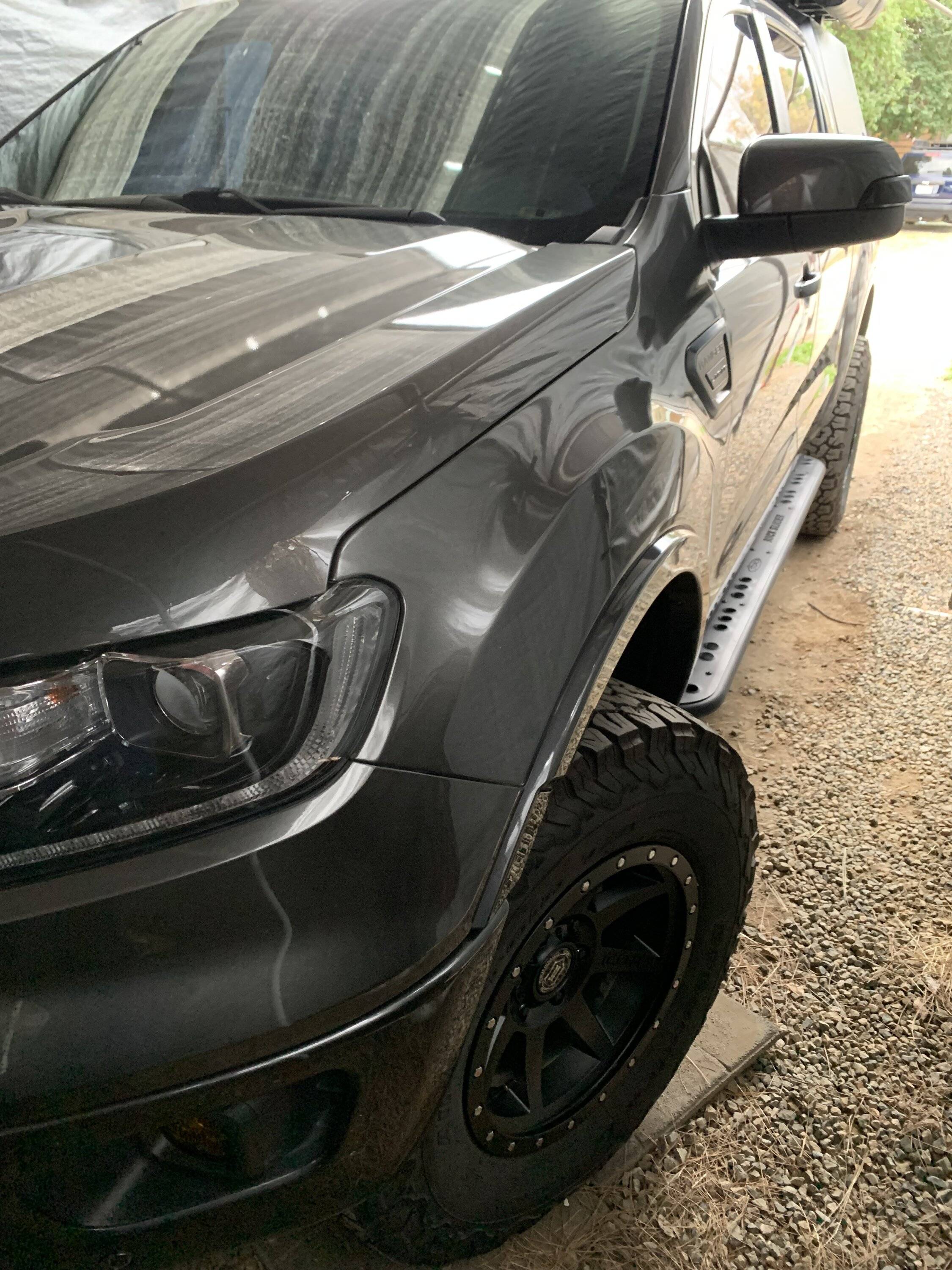

Not running BDS 2” but kind of a custom set up w/5100.
1. I went 5100 all 4 corners but up front went w/stock setting & paired them with Eibach springs. Giving me roughly 3” lift with full stroke on shock for a little smoother ride. I did have to pay a shop to but springs on. Also added icon UCA at this time. Ride quality improved 100%
2. Icon rebound wheel w/ 0 offset
3 KO2 AT 285/70/17 rated E heavy AF should have went with P tires. I took a major hit on MPG down to 14.2 loaded plus RTT. Recently took off RTT might see some improvements. With full size spare it will fit it spare tire location. Also added icon leaf option 3 with icon bump stops.
Added tremor fender flares to help with tire poke w/0 offset.
[/QUOTE]
Nice looking truck! I’m definitely planning to stay away from E-rated tires for weight purposes. Thanks for sharing your setup!

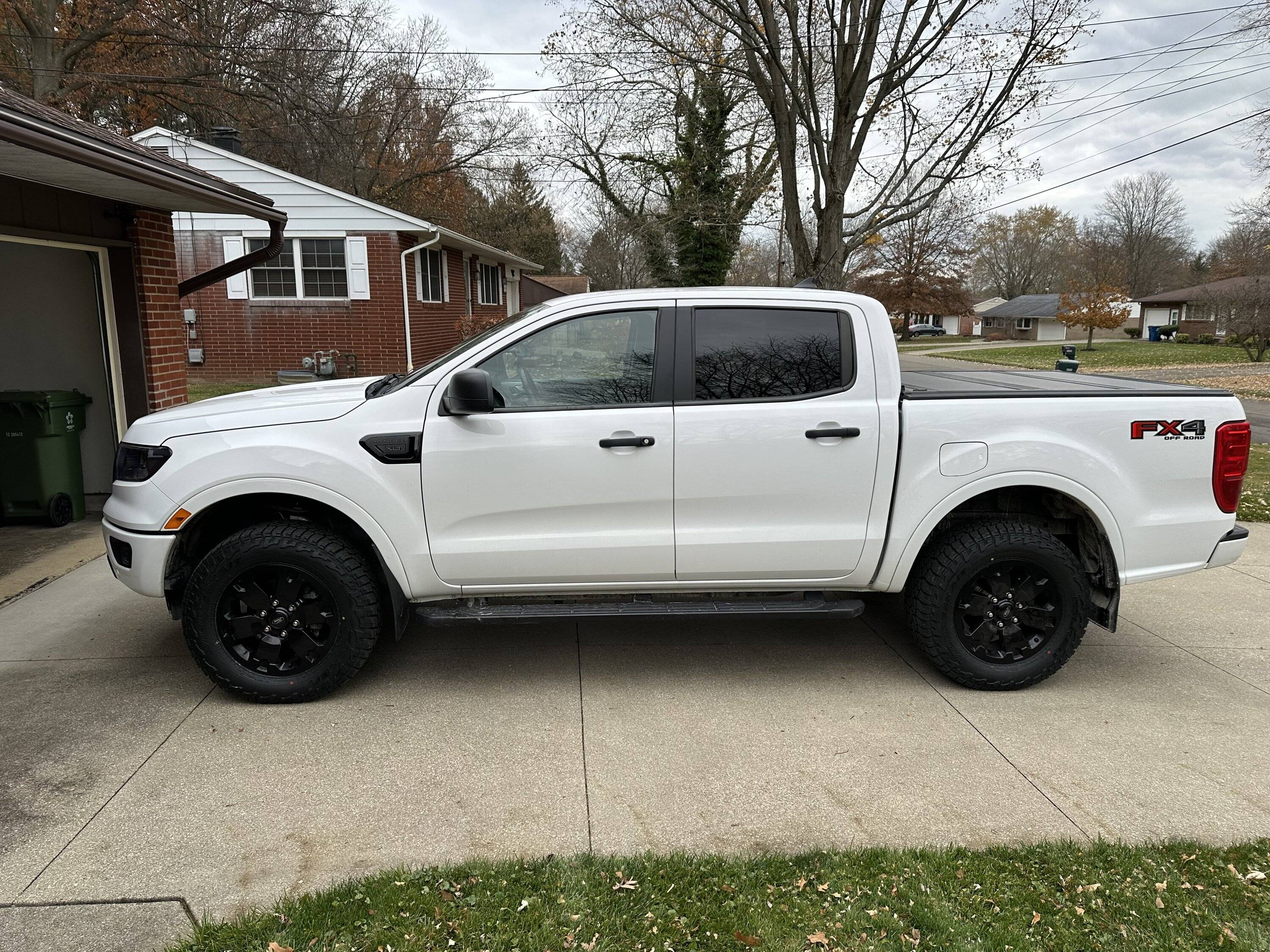

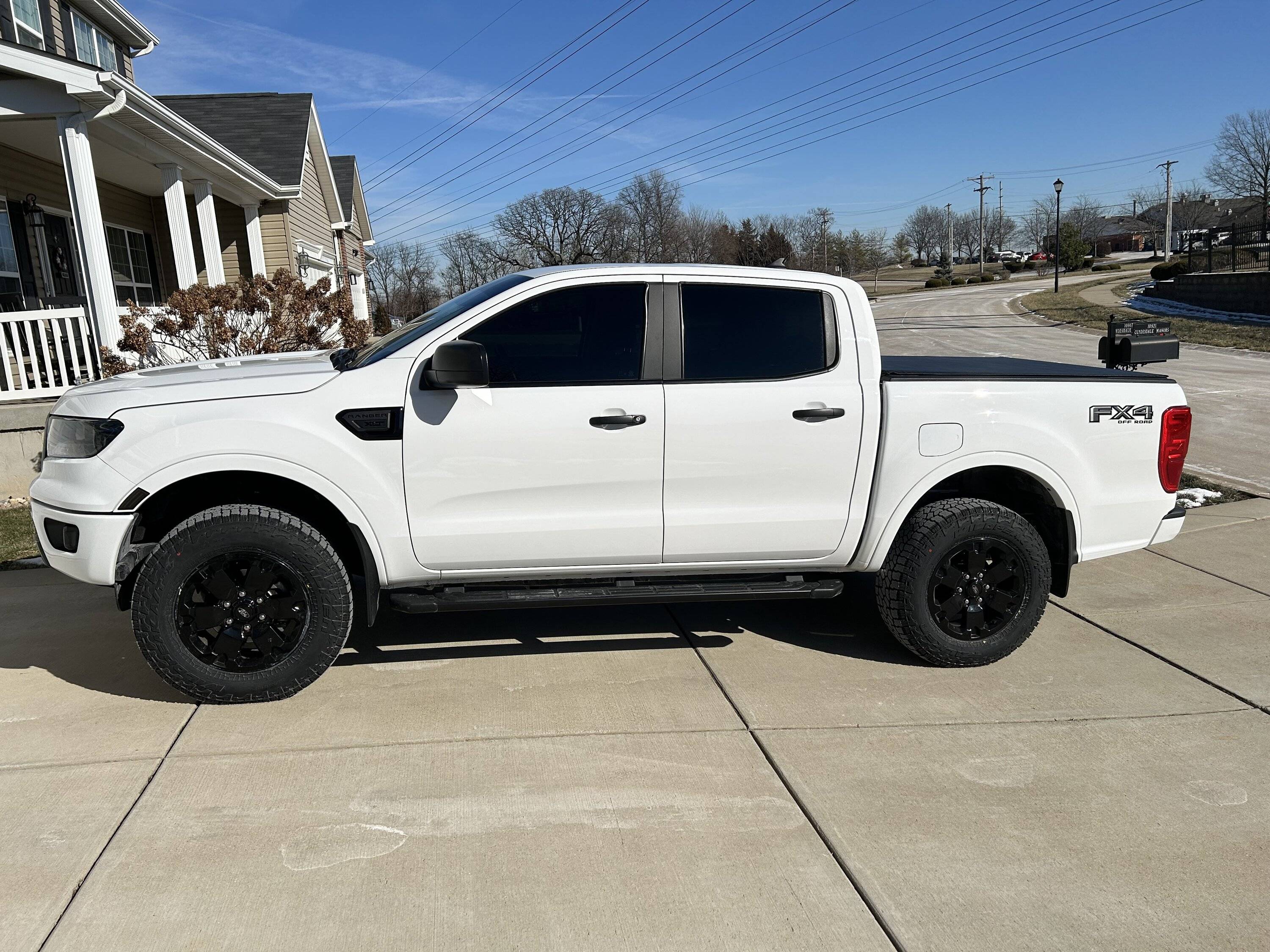

I installed Bilstein 5100’s all around with middle setting for height, think 1.2” lift on Front. Rides super nice, on 265/65/18 at3w wildpeaks.
Truck looks great! I wish these trucks came like this at a minimum from the factory.

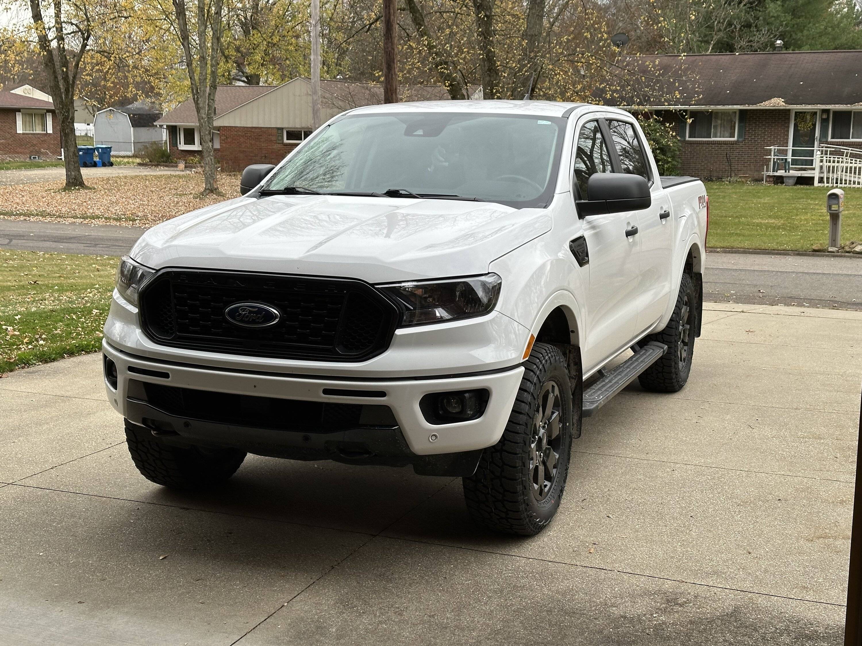

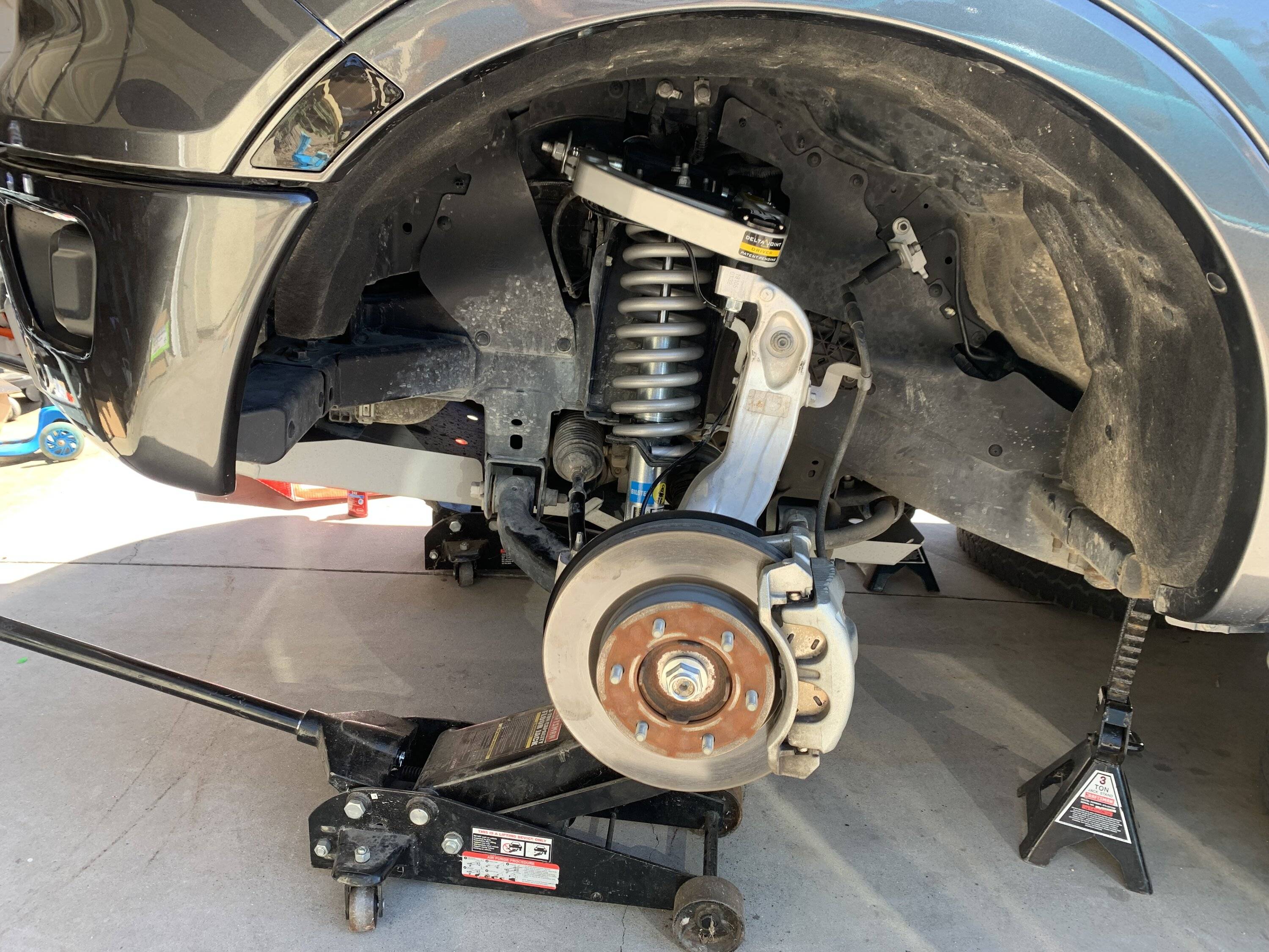

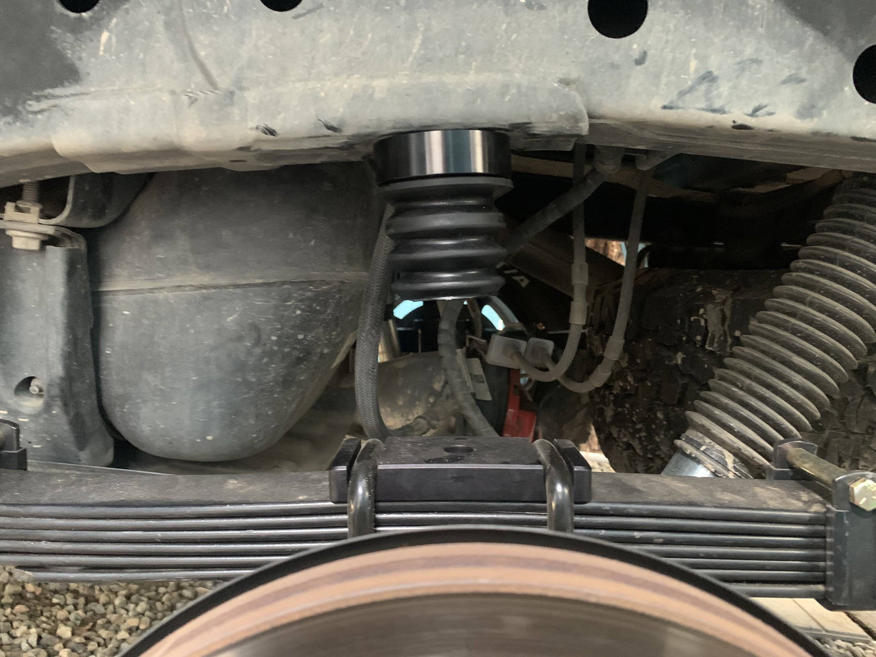

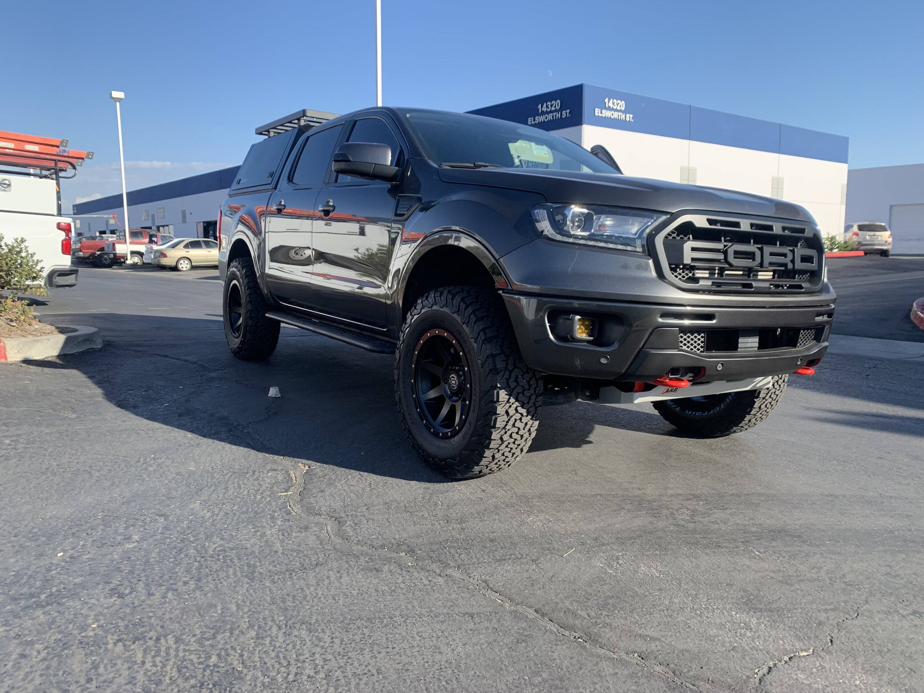

So I pulled the trigger on a lot of stuff! Got the Eibach Pro Truck Stage 1 kit and set the fronts at 2.25” (2nd ring from top) and used the factory coils. Installed ready lift intrusion beams and threw on P295/70-17 Toyo Open Country AT III’s with the 1.0” faction fab spacers. And finally, this truck is exactly how I wanted it!!
Installing the Eibachs was a little more involved than expected. I marked the alignment bolts and dropped the LCA’s and had the struts out, springs swapped to new ones, and back in the truck in about 30 minutes per side, but getting those LCA’s back up to get the bolts in was a bear. Took a few bottle jacks and a few choice words.
The intrusion beams also gave me a little trouble until I finally just loosened the bolts on the front bumper enough to slide them out. Cut the rears with an angle grinder as the sawzall didn’t seem to do that great with the blades I had.
Still can’t get over how much better the ol’ girl looks after all this!!

A few other things I forgot:
The Eibachs are a huge improvement over the stock FX4 shocks. I thought I liked the factory ride until I felt it with the Eibachs.
Went with the SL Toyo’s due to weight. The 285/70’s weigh roughly 47lbs each. So far I’m only seeing about a 2-3 mpg drop and it does feel slightly more sluggish on take off but nothing a little more skinny pedal doesn’t solve. Also, with the spacers and intrusions beams I have absolutely zero rubbing anywhere.
