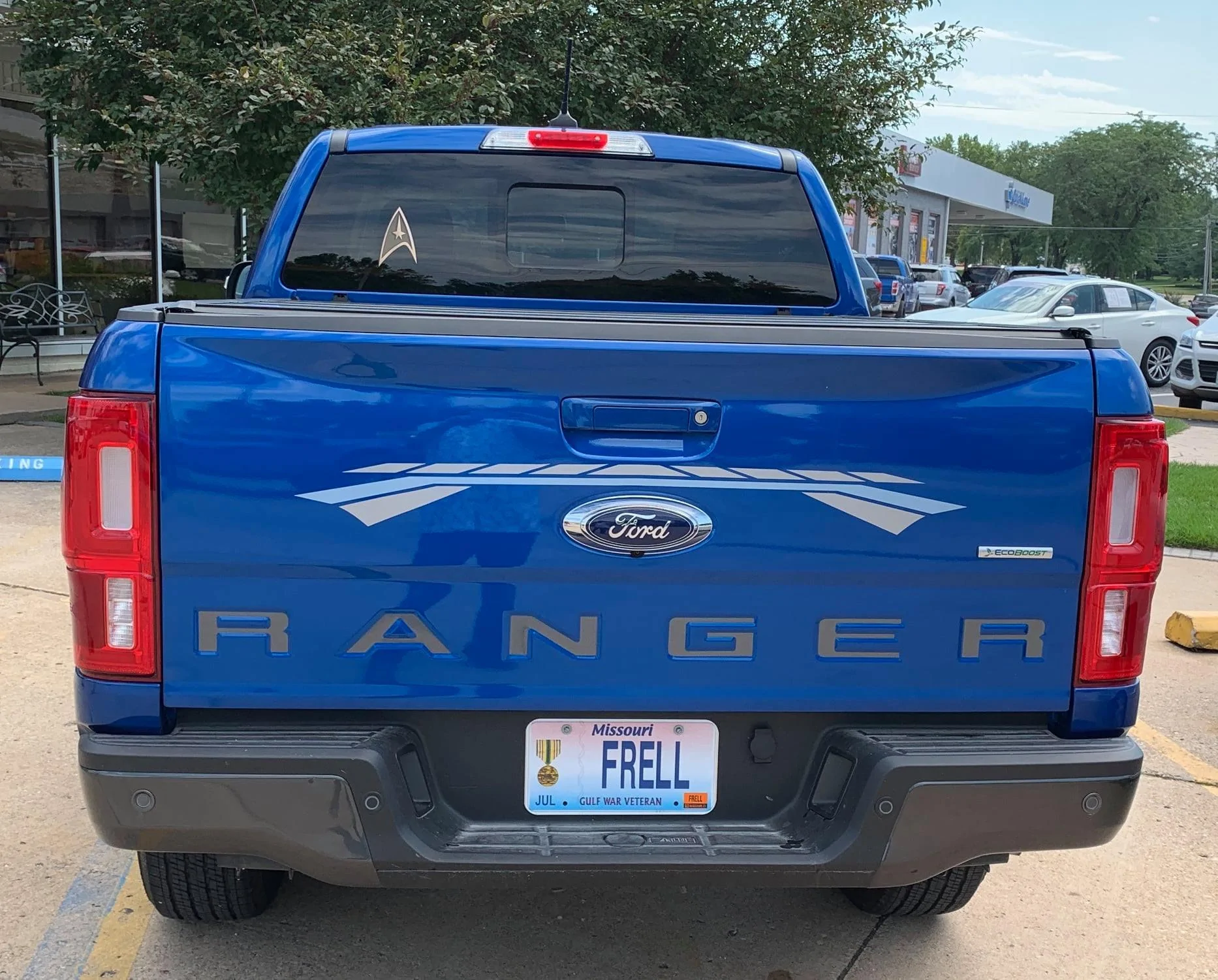

Not me. I like mine to stand out. I got mine done in magnetic gray to match the sport appearance package. Looks awesome.

I like to graphic above the oval - what is the significance?

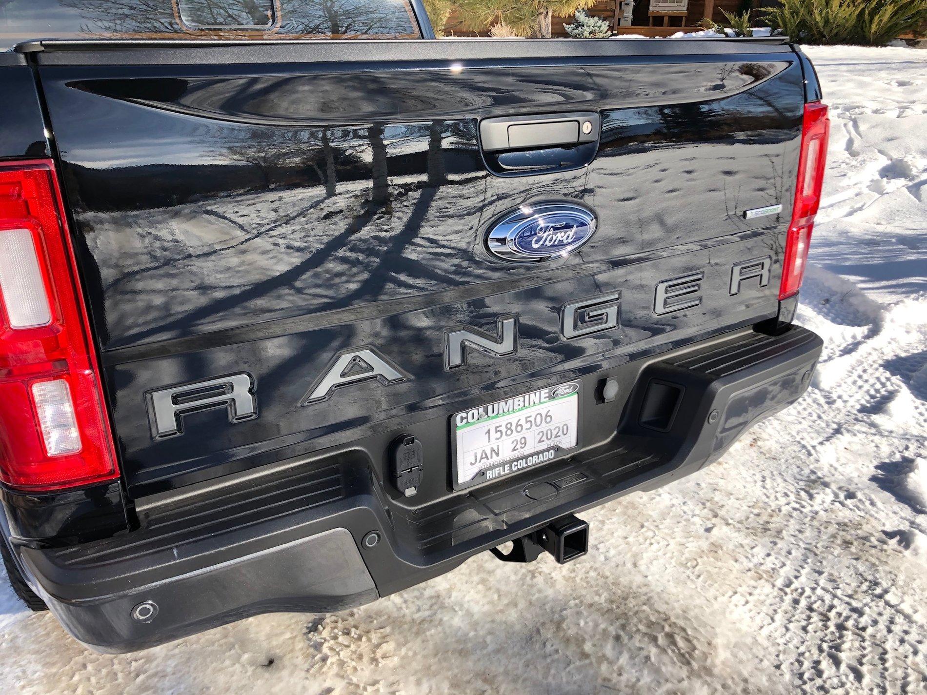

Wow I’m glad I didn’t get the vinyl letters. Mine took all of about 2 minutes to install. They all look great. Nice thing about the vinyl is that if you don’t like it, you can remove it easily. Lol. Mine, not so much.

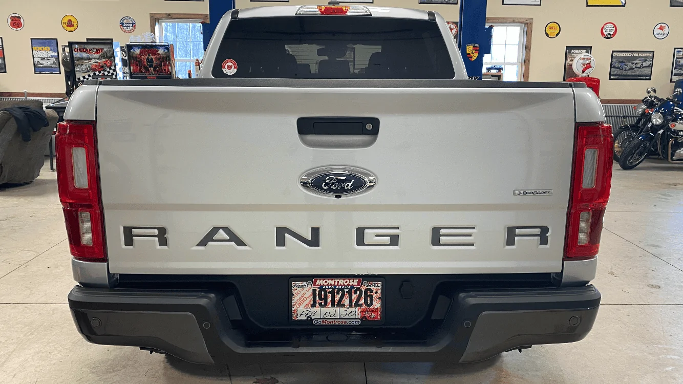

Helps if you buy the right letters. Solid molded with beveled edge. No sticker or flat cut out pieces. Cut each letter out separate from the sheet. Hold the clear plastic and lightly position. If good, press in place. No water or soap. Magnetic is color matched.

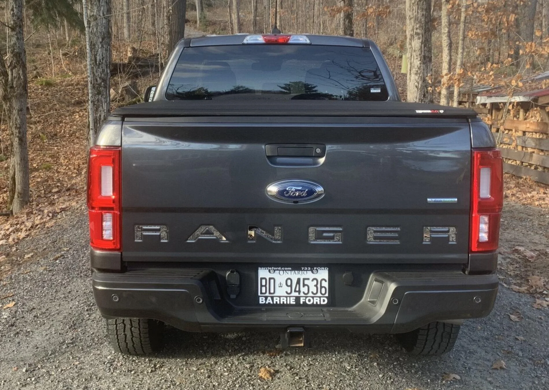

My stainless steel lettering is showing signs of rust at the edges.
Any suggestions on how to clean it?
If I want to remove them, is it just a case of heating them up with a hairdryer blower and picking an edge and peeling them off?
If their rusting at the edges, it won't be long before the paint around the edges will start to deteriorate. Rust has a tendency to spread very easily/quickly, especially looking at where you live....I'm sure they use some type of road brine/salt there, and any of it that settles on the lettering where it meets the paint will start to go quickly.
I'd suggest using a heat gun or wife's hair dryer on low heat and remove the letters ASAP.
Yeah, just heat a letter and carefully pry a corner , maybe using a plastic pry type tool....even an old credit card, and pull it off carefully.
If you want "shiny" then use SS/chrome colored raised plastic letters or chrome vinyl.
Swingpure
Gary
Sep 26, 2020
572
1,838
McDougall, Ontario
2020 Ford Ranger XLT Sport
Thanks, they are removed. No underlying rust. I still have to remove some of the glue, but I am boiling sap right now so that will be a tomorrow’s job.
Any suggestion on how to remove the glue without harming the paint?
