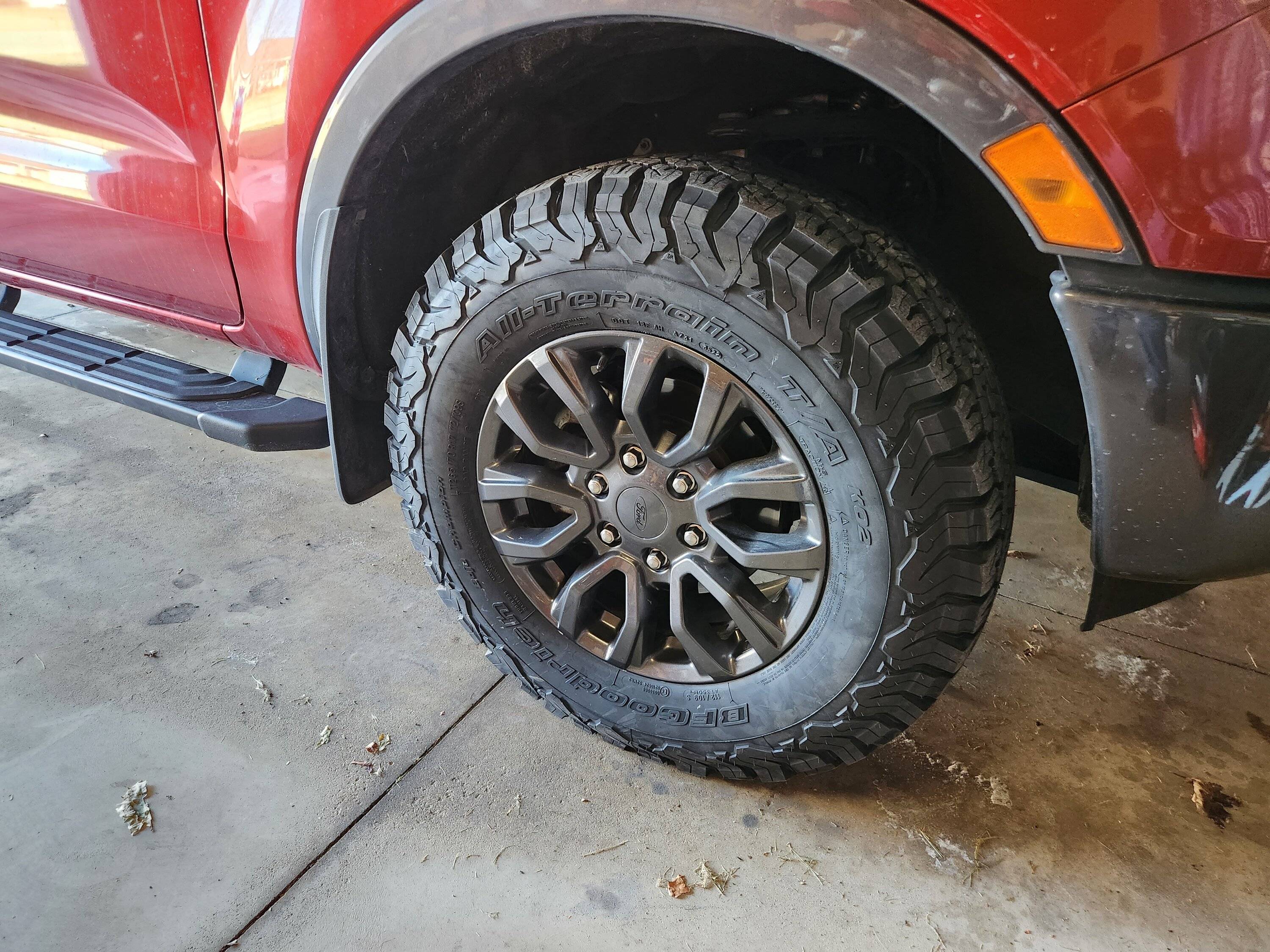

So anyway, just got the good old overrated BFG AT KO2's on today. Noise is just as good as my original all weather street tires. Went from 255/65-17 to 265/70-17. (70 mph is now 73 on the GPS) Acceleration doesn't seem to be noticeably slower. I was getting 21 mpg on my old tires, I'll report back what I get on the new tires though it's not super important to me. They are 46 lbs, slightly on the heavy side, but there is a lot of tread and rubber here - and I would hope, long life.
Of course Discount tire put 40+ psi in. But at least they seem well balanced at high speeds.

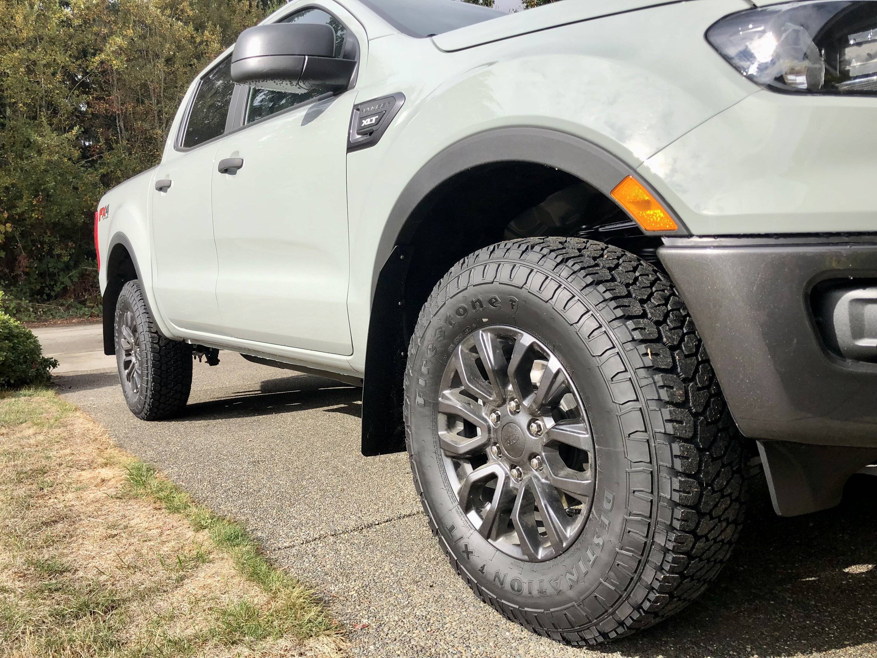

Firestone Destination XT is among the lightest of the more aggressive AT tires. Less expensive than some of the most popular too. Better wet traction than most, another major reason why I bought a set (PNW resident).
I went with LT255/75/17 C load, a true 32” tire. 1.5” taller than my FX4 stock Hankooks and around 5# heavier, I recall.
