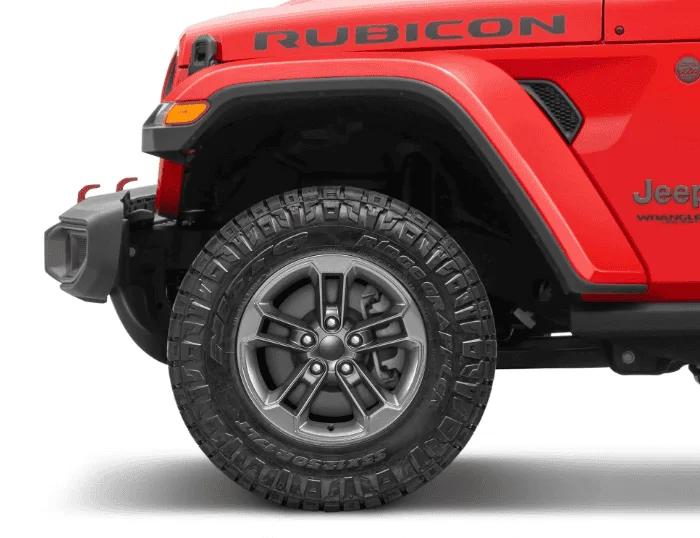

Yeah I meant the OEM tire. I like the aggressive LOOK of off road type tire, but want a decent compromise. Something like the Nitto's which look fantastic (IMO) even in stock sizes.

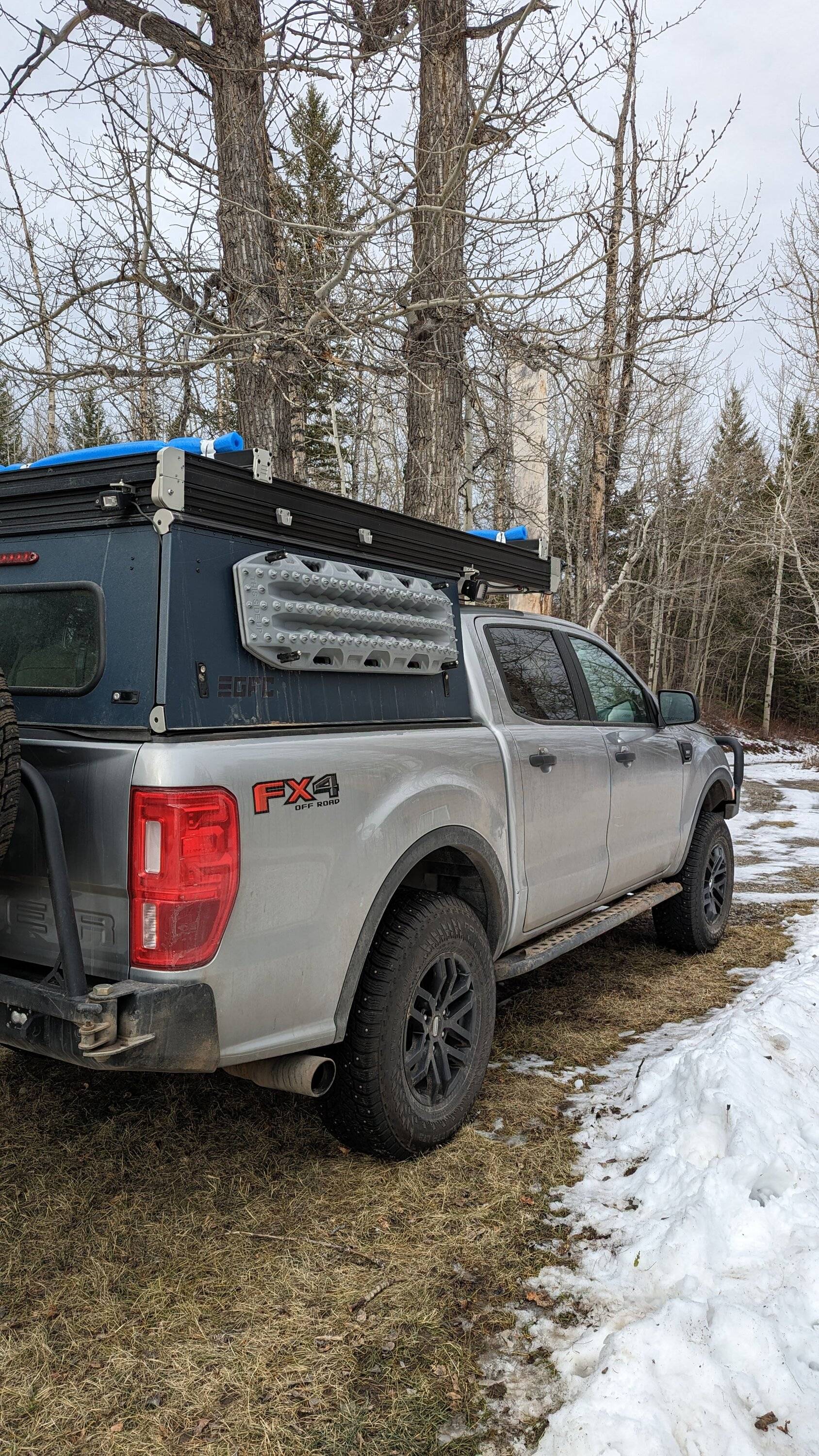

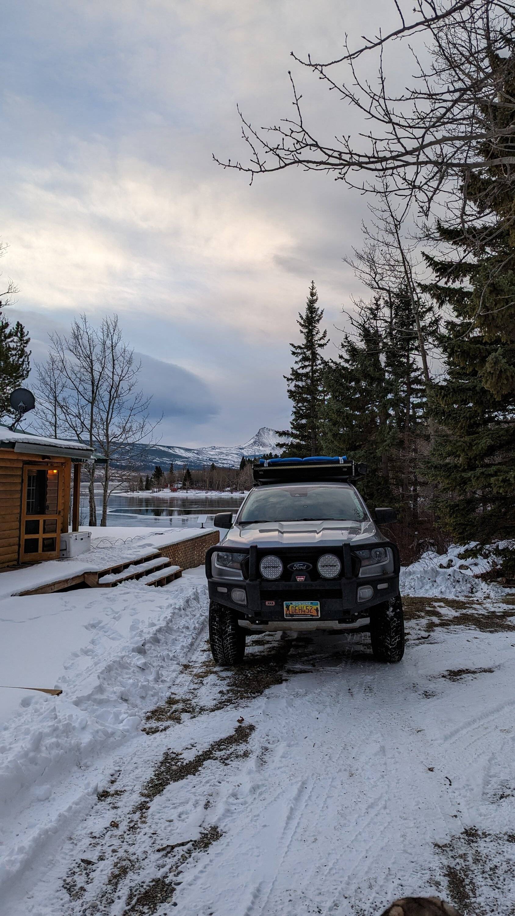

I have yet to see a better option than oe wheels with one inch (no more, no less) wheel spacers.
Here's some Tremor (nee ROW Raptor) wheels, with spacers, and my itty bitty 285/70-17 nokian winters.

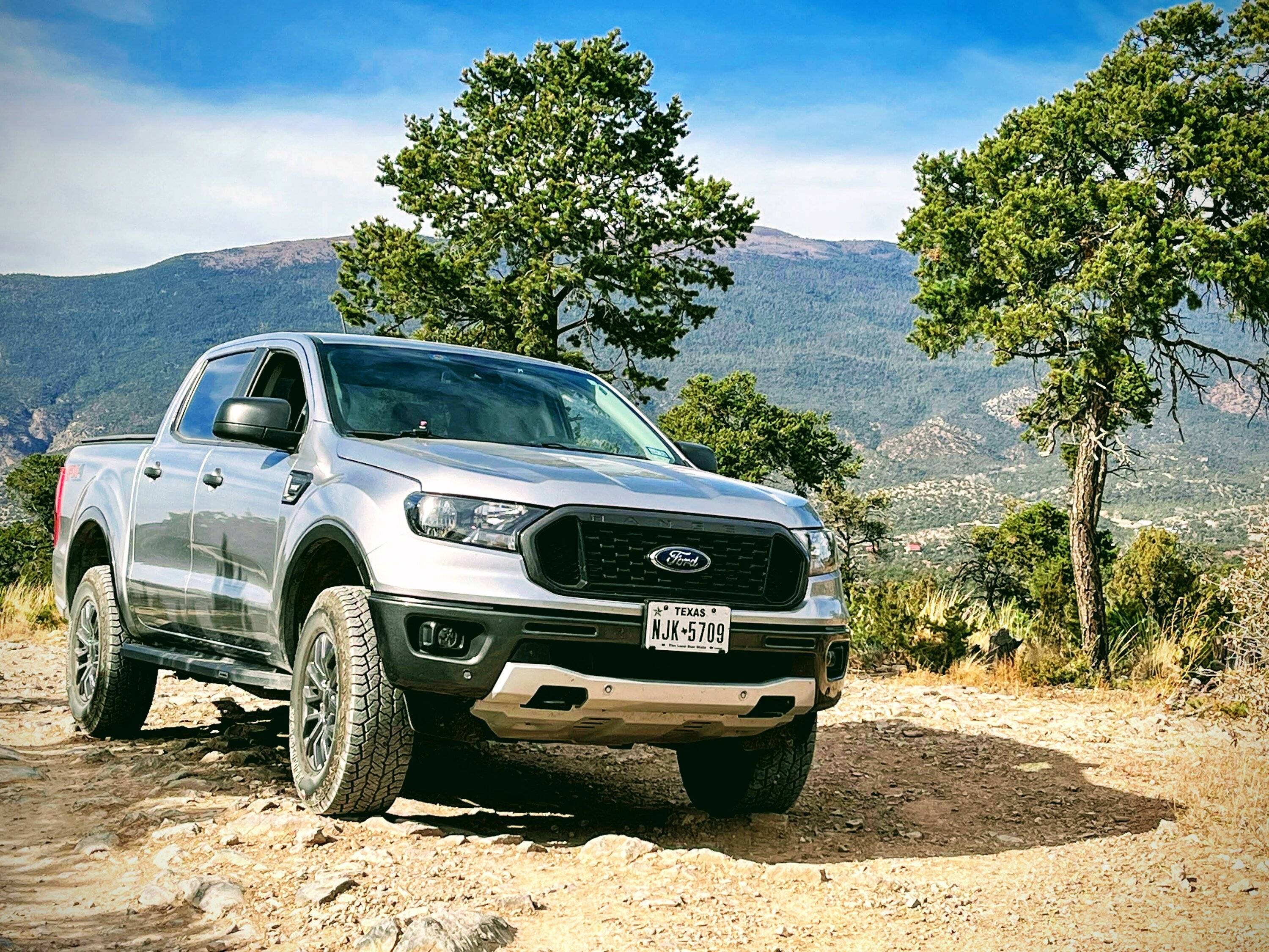

Do you have any pics with your AT2 Hankook's? That taller profile of the 70 probably really makes it look beefier?
Almost looks stock. Looks beefy when side-by-side with a stock Ranger.
Deleted member 15875
Definitely looks better than my 60's! I was thinking of doing the same or go with Deegan 38's in the same size. Tread wise they look somewhat similar but aren't too heavy.
Being they are taller, is there more squish when driving or pretty similar?
Rides as well as stock (better in my case since I replaced LT rated tires). I have Bilstein shocks in front and back, and I would definitely recommend them in the back. If you want to level the stance, then get them for the front. They are really only a tiny bit larger diameter than the stock ATM and corners, noise and road performance is the same. 265/70R17 can fit without any suspension modification.
